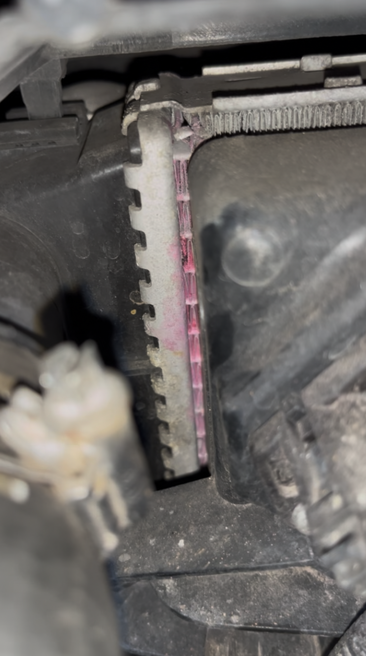

Proud owner of an 07 panda 100hp However I happen to have found a leak, and I'm guessing a crack, in my radiator so therefore would like to replace it. can only find one available just seeing if anyone knows a better one to buy or any recommendations on what to do

Good spot, looks like it's fairly fresh leak still nice and pink not dark red

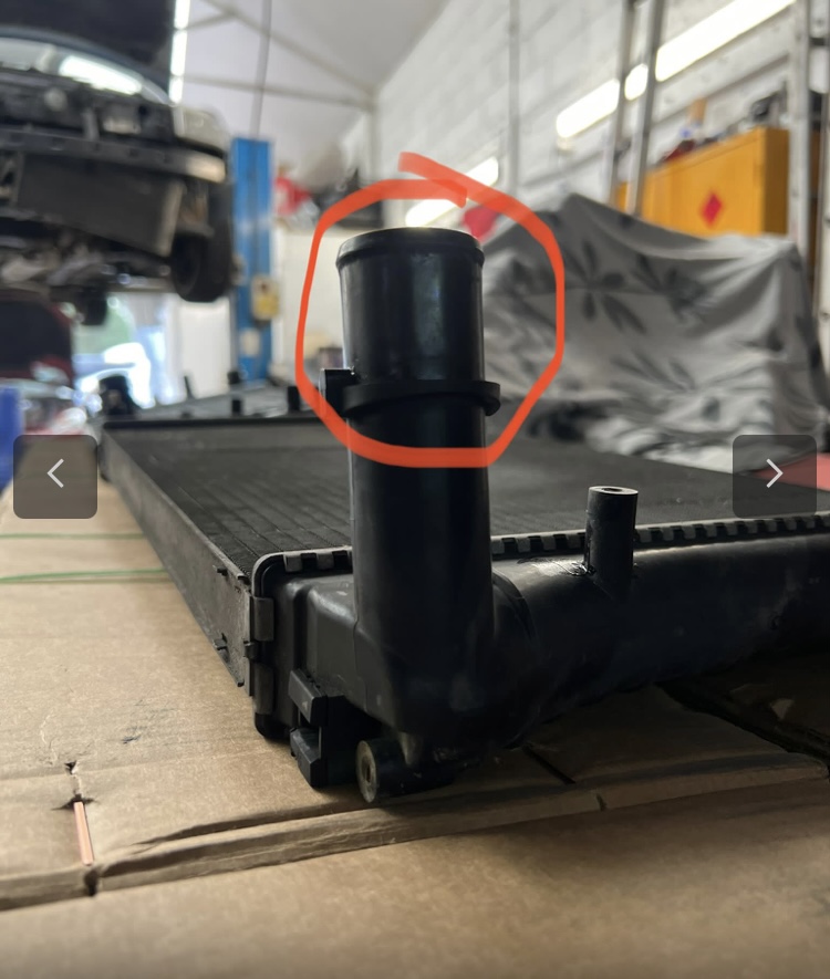

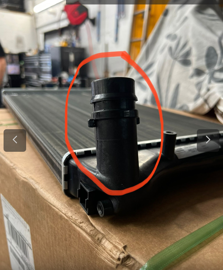

Hi mate,
Find attached the part number for the rad, you have to modify the upper pipe connected and remove the lip and the pipe with just fit on with out the speed connector.

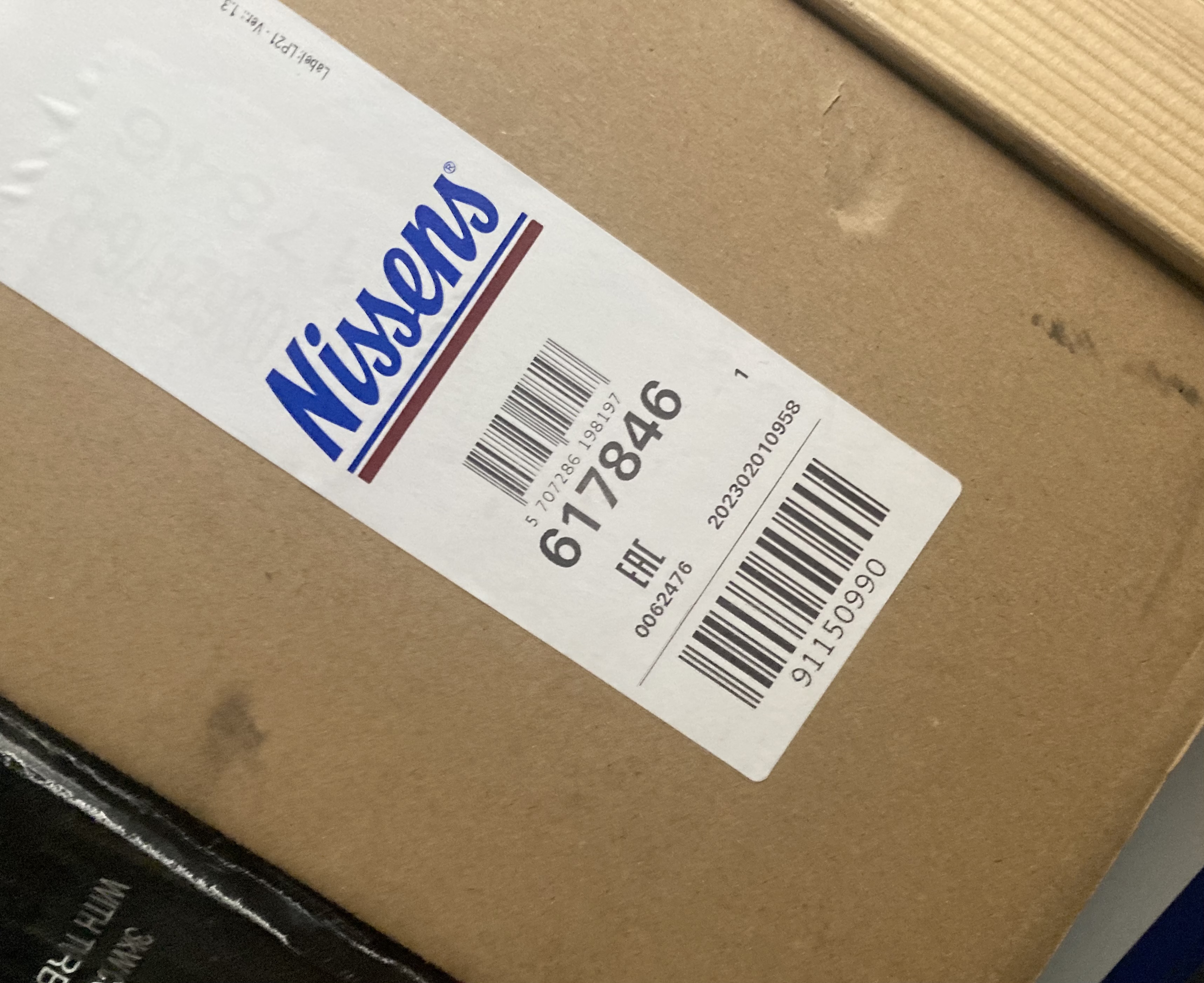

Picture of the
Nissens 617846 part number
Is a 1.1 and 1.2 radiator according to there own catalogue
617847 is listed for the 1.3D
Guys I literally have this radiator fitted to my car and other people have fitted it to there’s, I drove 500 mile last year in 38 degree heat for 10 hours with the air con on with absolutely no over heating, these are the rads that Asa fits (his the one that told me about them), I was asked to share the part number and have, if you want to carry down a unneeded rabbit hole there is literally no point.
