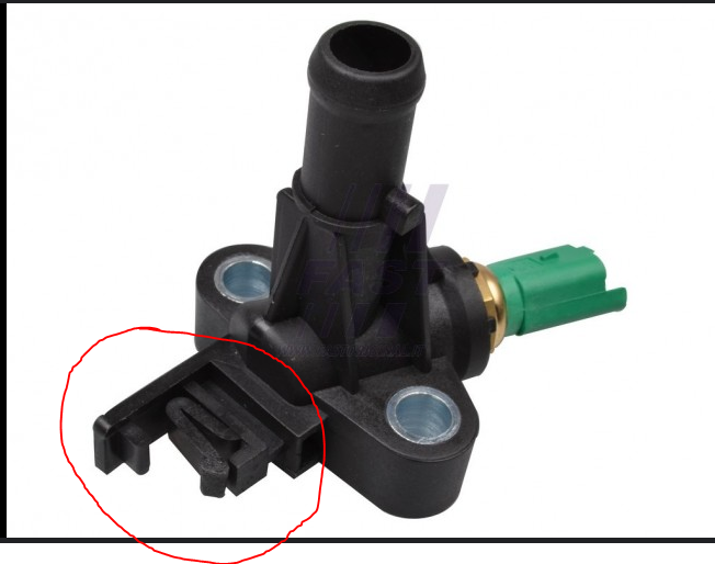

Heya new poster here
anyone have experience with replacement of this sensor, specifically the plastic latch circled in red cant figure out how its meant to shift
Thanks
Year
2008
Are you changing it for a P0115 error
Or gauge suddenly dropping
It's normally the thermostat not the sensor
Anyhow there a pain to unclip as everything is done by touch
See if I can find an old one to photograph the latch
The temp lingers around C then when its been sitting ignition off it goes back to the middle and then goes back to lingering between mid and c after driving somewhat
Sound like the thermostat is stuck open
Easy to test
Make sure there enough coolant
Start the car from cold
Put you hand around the top coolant hose
The bottom of the hose should stay cold for a couple of minutes
Anyhow here's the answer to your question
