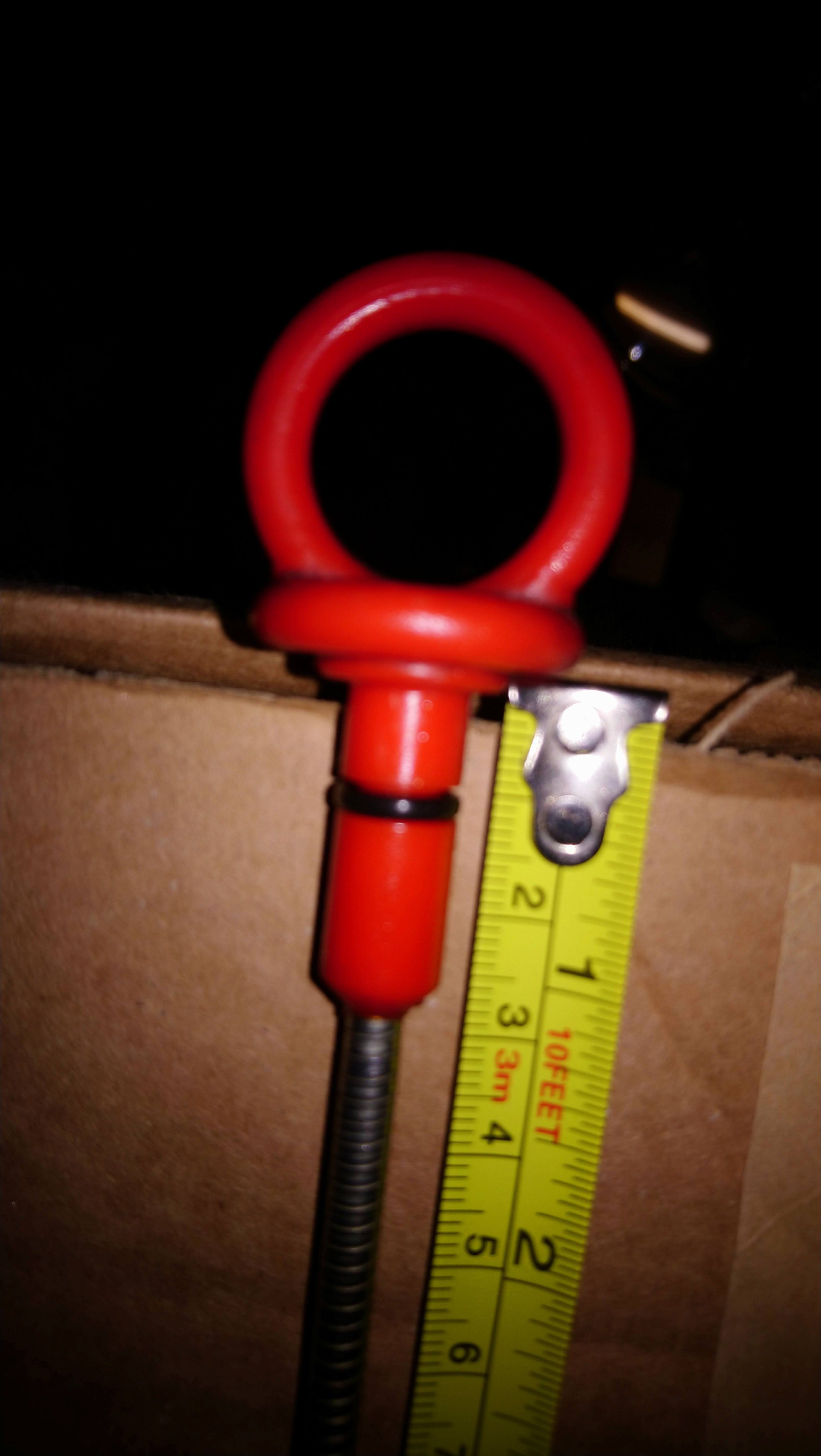

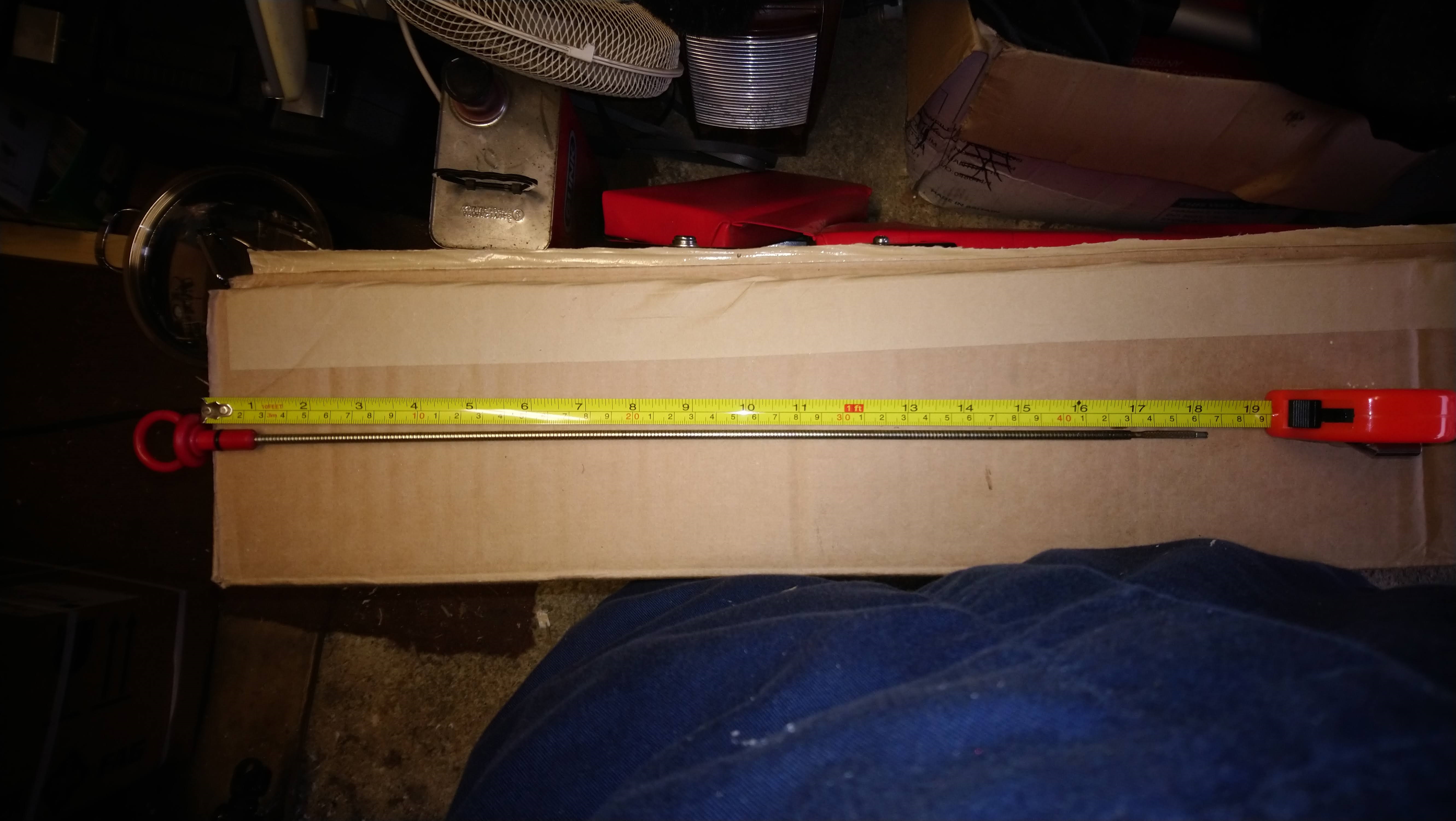

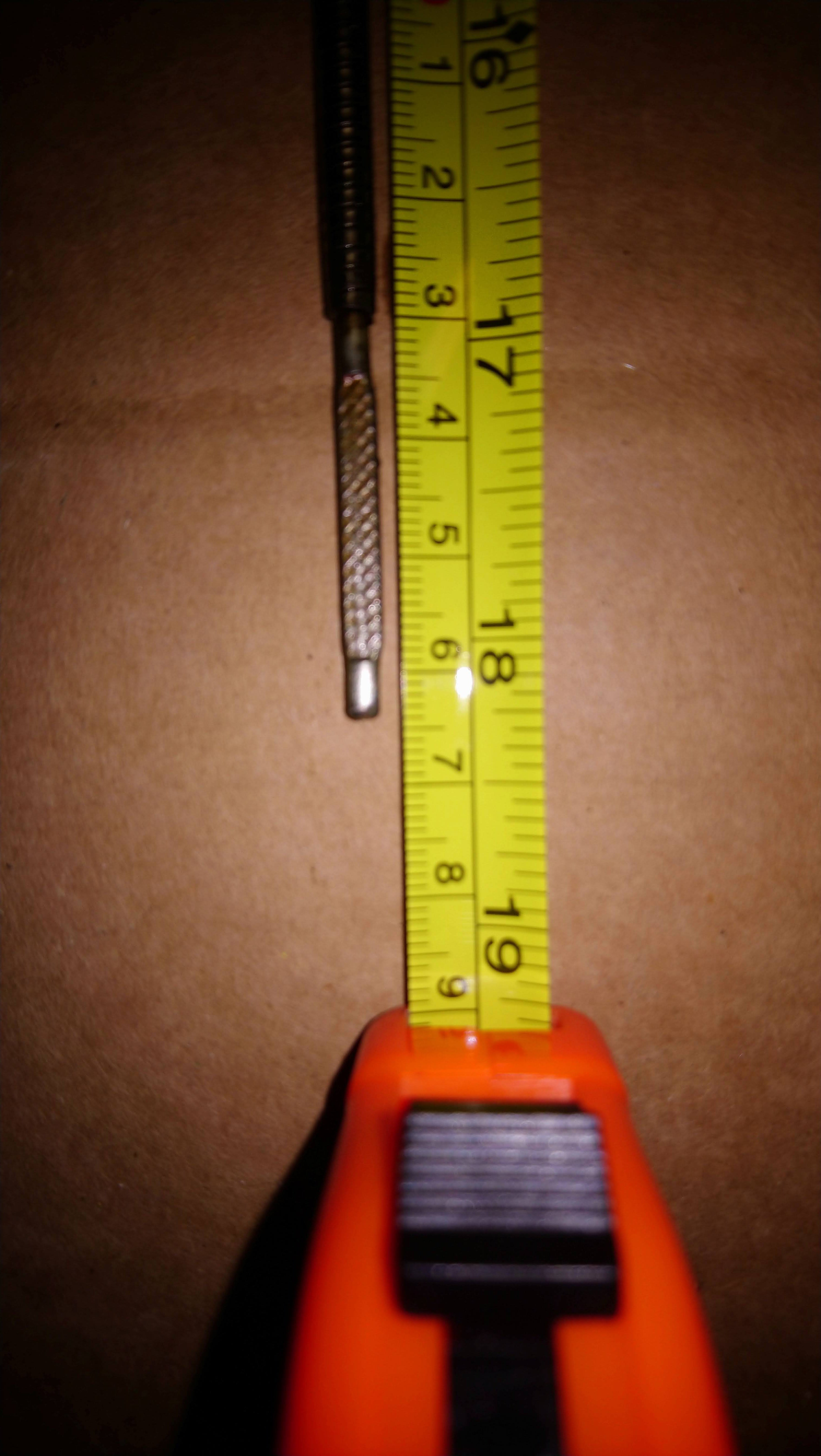

OK, here we go.
As you said, correct place to measure from is the base of the red handle, as that sits on the top of the tube. From the main base, not the little ledge that centres it in the tube.
Distance to Max, is 435mm
Distance to Min, is 459mm
Sorry about the poor pics, I've never taken a good photo.

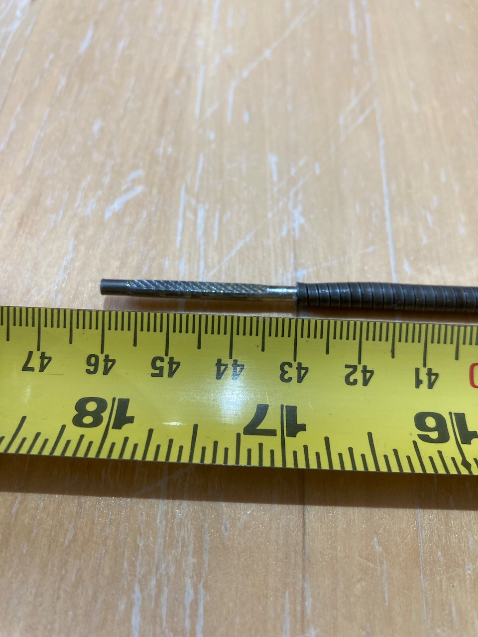

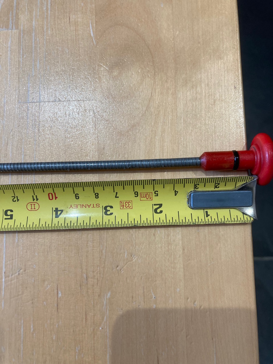

Thanks for taking the time @portland_bill - they are really helpful.
I've just measured my own dip stick on the 500 1.2 VVT from 2017. Mine is appearing almost identical. To the max line is 435mm and to the min line we have 456mm, so accounting for any discrepancies in measuring, id say they are identical & we have the same dip stick. Which rules that out.
