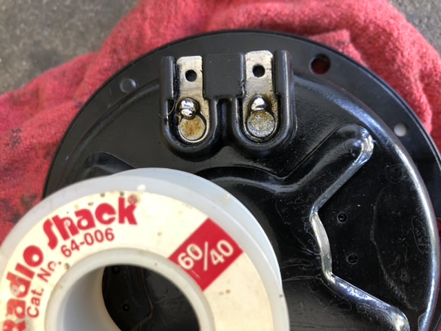

I once had a problem with a brand new horn behaving similarly. Turned out to be a defect in how the spade terminals were riveted in place. Had to drop a little solder on the terminals to ground them to the power contacts. See pic.
