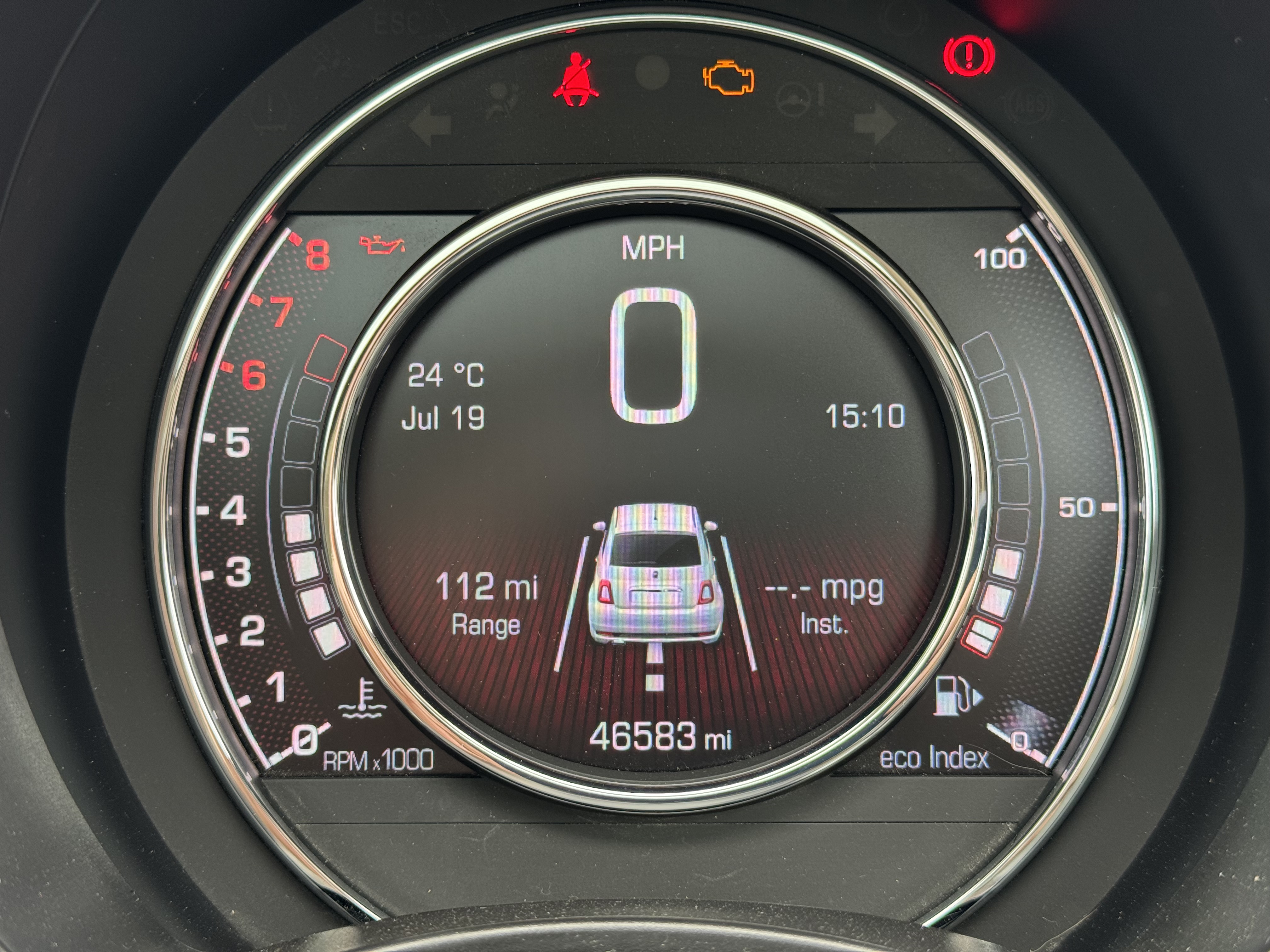

What’s curious is that on your “00” image you’ve also got 0-5 on the right, in fact you’ve got that on both.
I wonder if I change my byte 65 to “20” whether it’ll stay on 0-50-100? I’d rather have 0-5 I think.
My car is a 1.2 Lounge though, maybe it’s different in Hybrids etc.
How odd? I never noticed, I was distracted by noting that I wasn't able to get any obvious changes when setting it to '40' & '60'.

As expected changing my display to “20” got me the thin fonts, but the eco index thing on the right stayed as 0-50-100.
Must be another byte that affects that?
