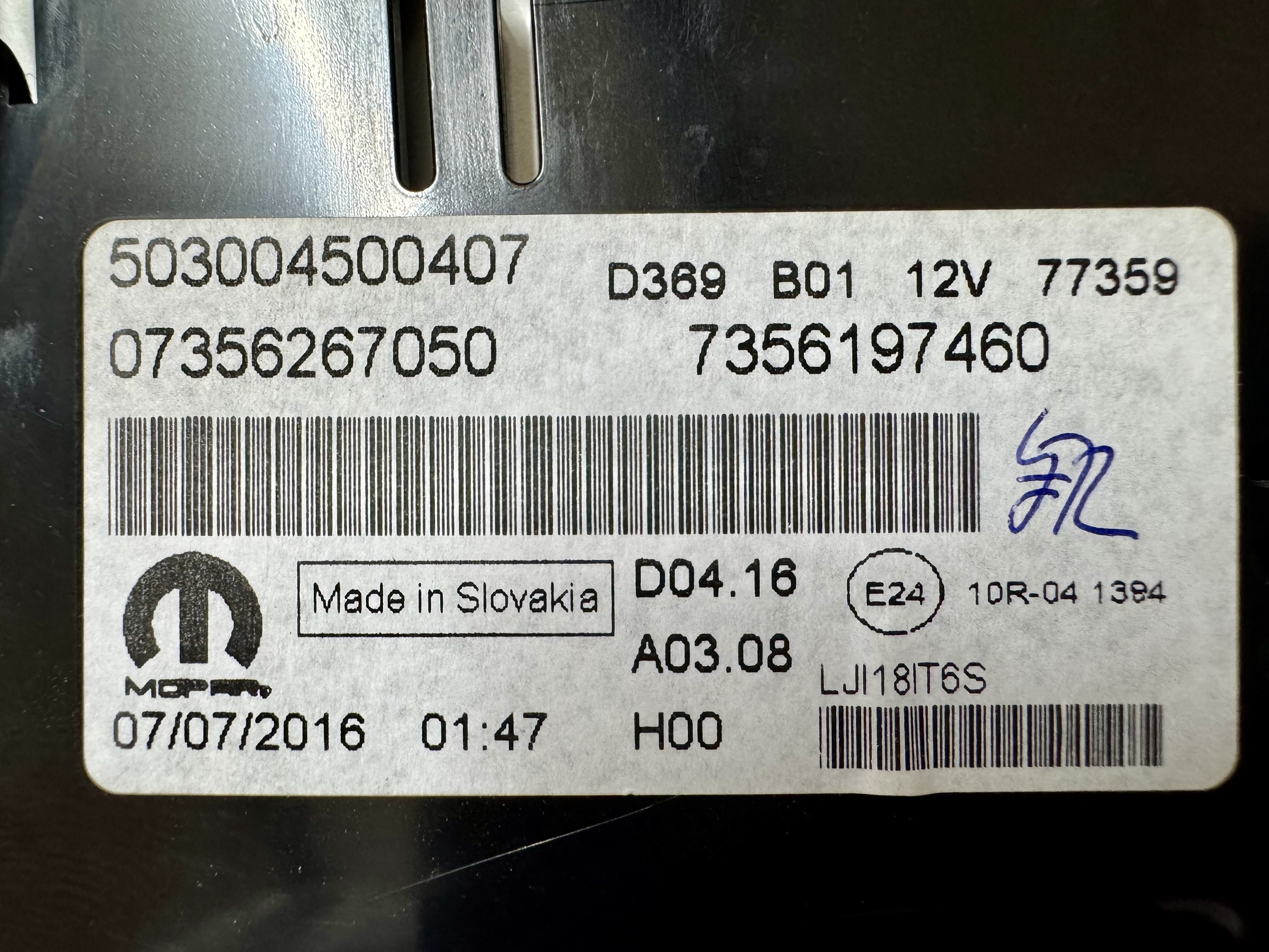

This speedo DID NOT work:
This speedo DID work:
Physically the speedos looked identical, including everything else on the display. The one that works has a manufacturing date nearly 3 years on from the one that doesn't work.
