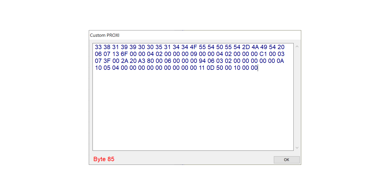

Typical vehicle proxi setting page, using Control Alt + C.
Select all and copy to a text file. When you are finished playing, you can paste it back in. I believe the maximum number of Bytes is 250 for the later models, starting at 85 for the earlier models.

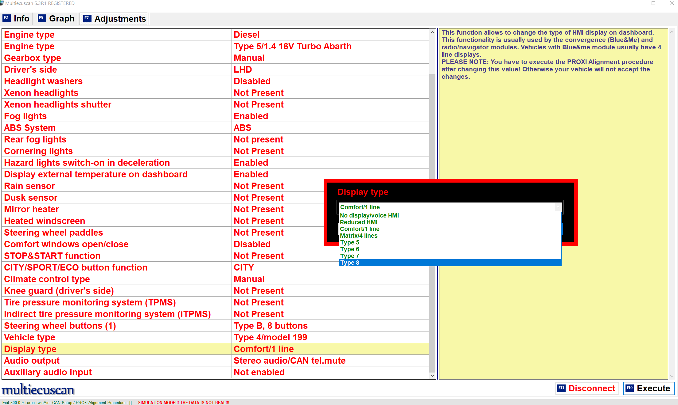

Change the settings using MES windows and dropdown menus. When you hit OK, it will save to your BDL.
Example of possible settings, save a BDL text file for each change, remembering to name the file in the format described in 3. above.

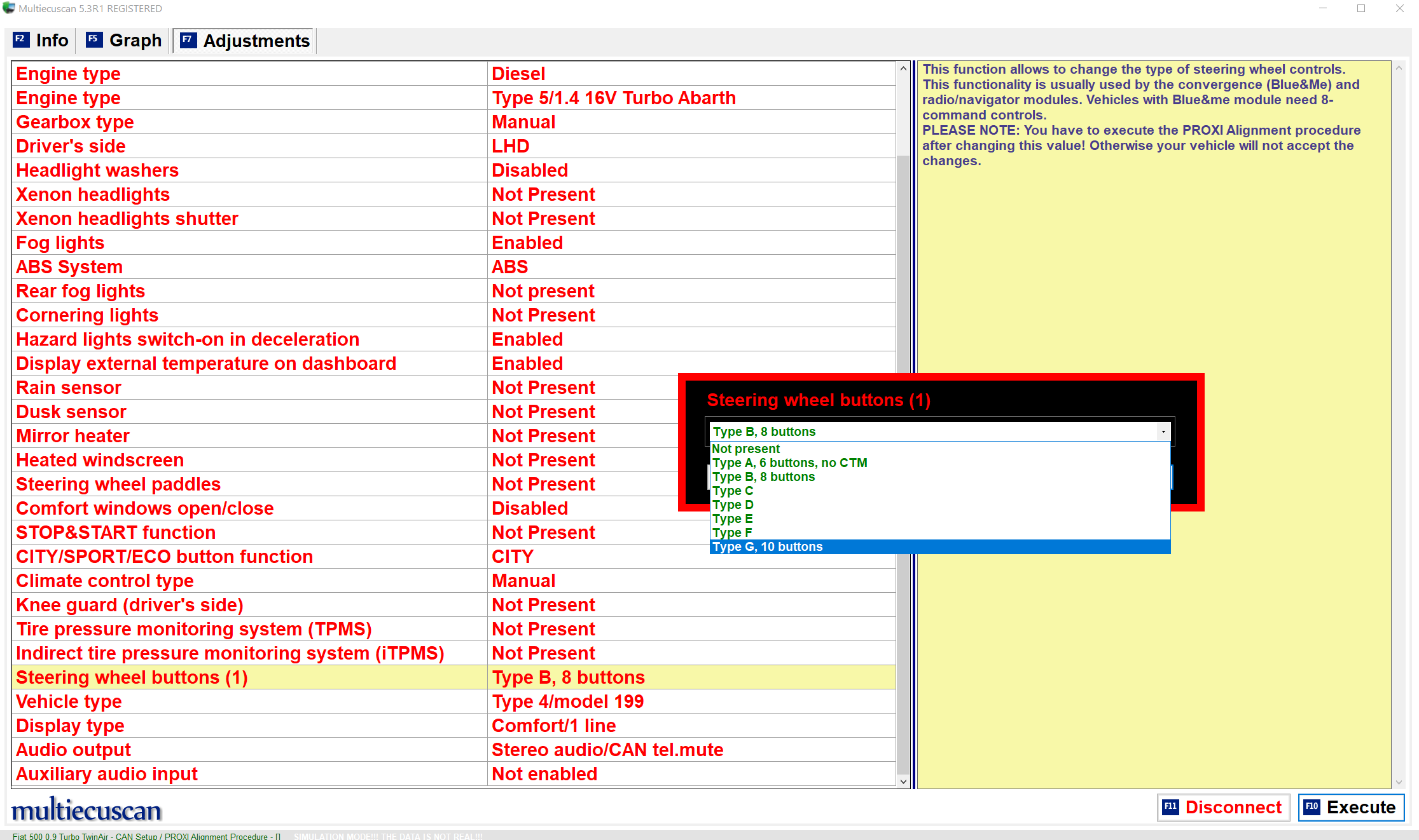

Another example
If people can do this we can quickly identify which Bytes are for what.

This is the table I was exploring today.
As discussed previously I took a copy of the bytelist and saved as 'original'
I took a copy of the byte list every time I 'Executed' a change in the table above, and processing into columns, pasted into the attached spreadsheet.
I did the first 6 headings.
  • These bytes only apply to my vehicle, my hardware, and my software versions in the ECUs.
  • Not all changed values will remain saved, some seem to revert back to their preset values.
  • Some values are programatically linked to other values so that changing one, automatically changes another.
After studying the spreadsheet, perhaps you could share your thoughts.
