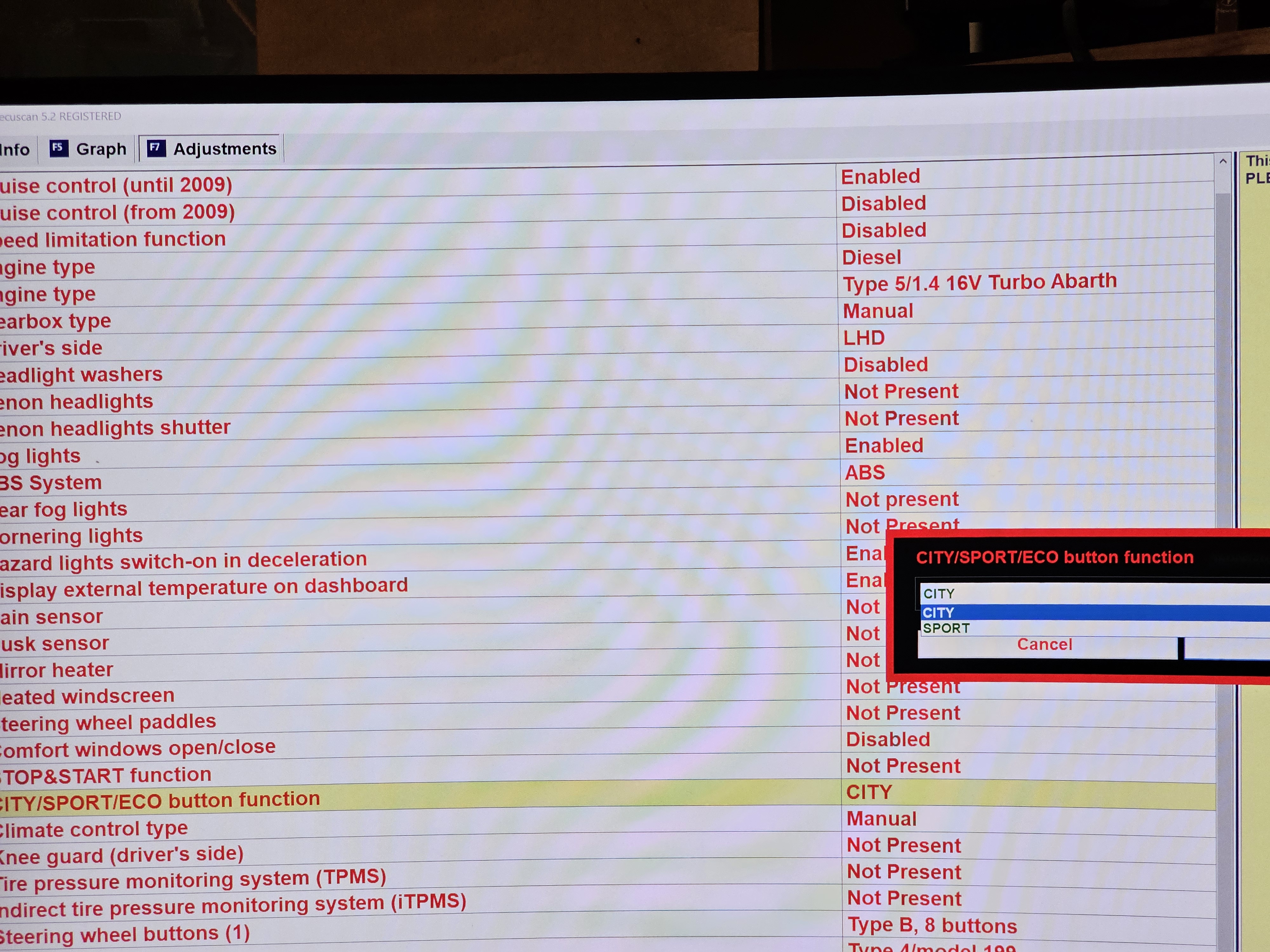

Hello.
Help me please.
FIAT 500 0.9 2018, trying to change the ECO button to SPORT. It gives this error
PROXI ALIGNMENT PROCEDURE
Writing CAN configuration data ...
Writing to module Body Computer Node (BCM/NBC) FAILED! - Request out of range error
[102A] errors: Byte 83: 08->00
Writing to module Dashboard Node (IPC/NQS) SUCCESS!
Writing to module Airbag Node (NAB/ORC) SUCCESS!
Writing to module Entertainment Telematic Node (ETM) SUCCESS!
FAILED TO EXECUTE
Hello.
Help me please.
FAILED TO EXECUTE
Hi Panek,
Looks like Byte 83, is out of allowable range. Is that the one you have changed?
Also have you tried changing the button in the MES prog?
Did you try the other method? It should write the original value back.
Yes, MES did not make a PROXY and left the standard value of the ECO button. AlfaOBD was also unable to change ECO to SPORT. Maybe in cars of 2018 a different byte needs to be edited? MEC and AlfaOBD only know older BODY?
My list of original values shows byte 83 = 08.
You may need to set it twice, and wait 15 seconds before turning key off, and 10 before turning back on.
I tried to change mine a very long time ago whilst exploring MES. I never managed it either. But never really cared about it.
In the original PROXY I have byte 83 = 08, and the button works like ECO, I need it to work like SPORT.
Should I try to edit the PROXY manually, and change byte 83 = 00?
And after that run the PROXY alignment procedure twice?
