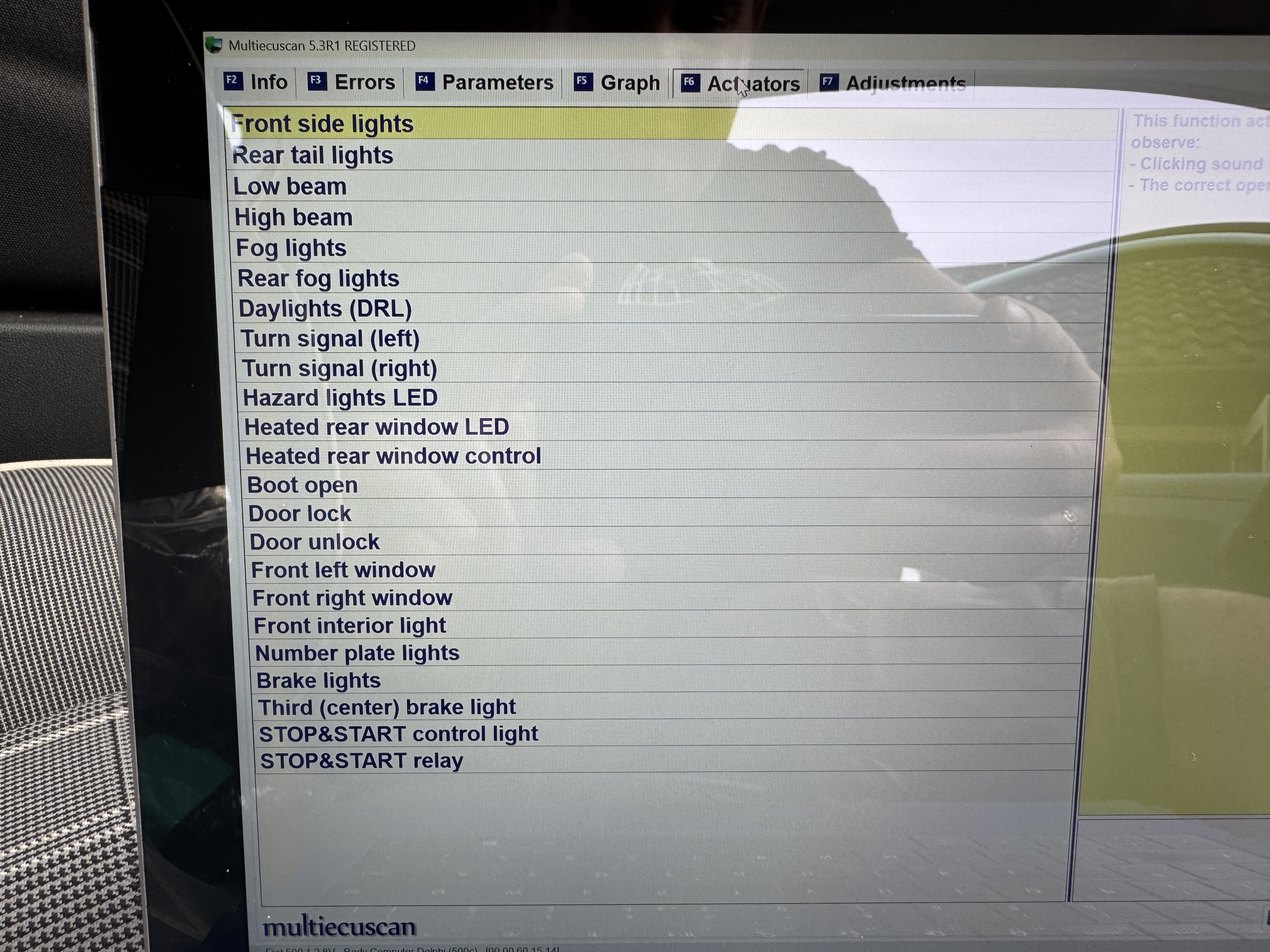

It's as if it's Deleted the Cruise..
Look in the Actuators page of MES,
WHAT does the Cruise condition show?
Thanks. Will fire up MES shortly, just waiting for laptop to charge a bit.
I definitely didn't change anything in MES, beyond increasing the mileage on the replacement speedo to match the one I removed. I followed a guide to do it (thanks "Love 500") so pretty sure it's all ok.

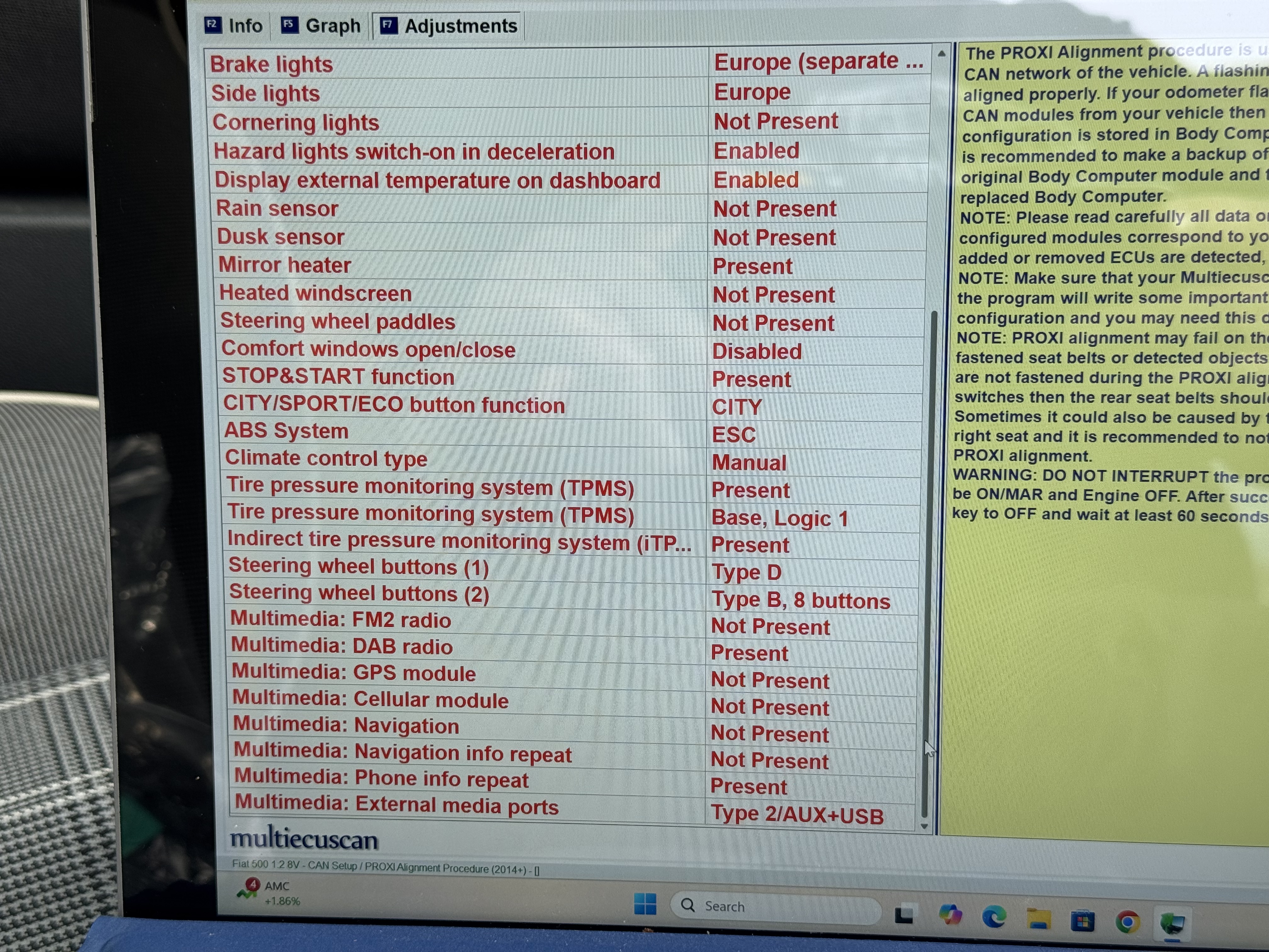

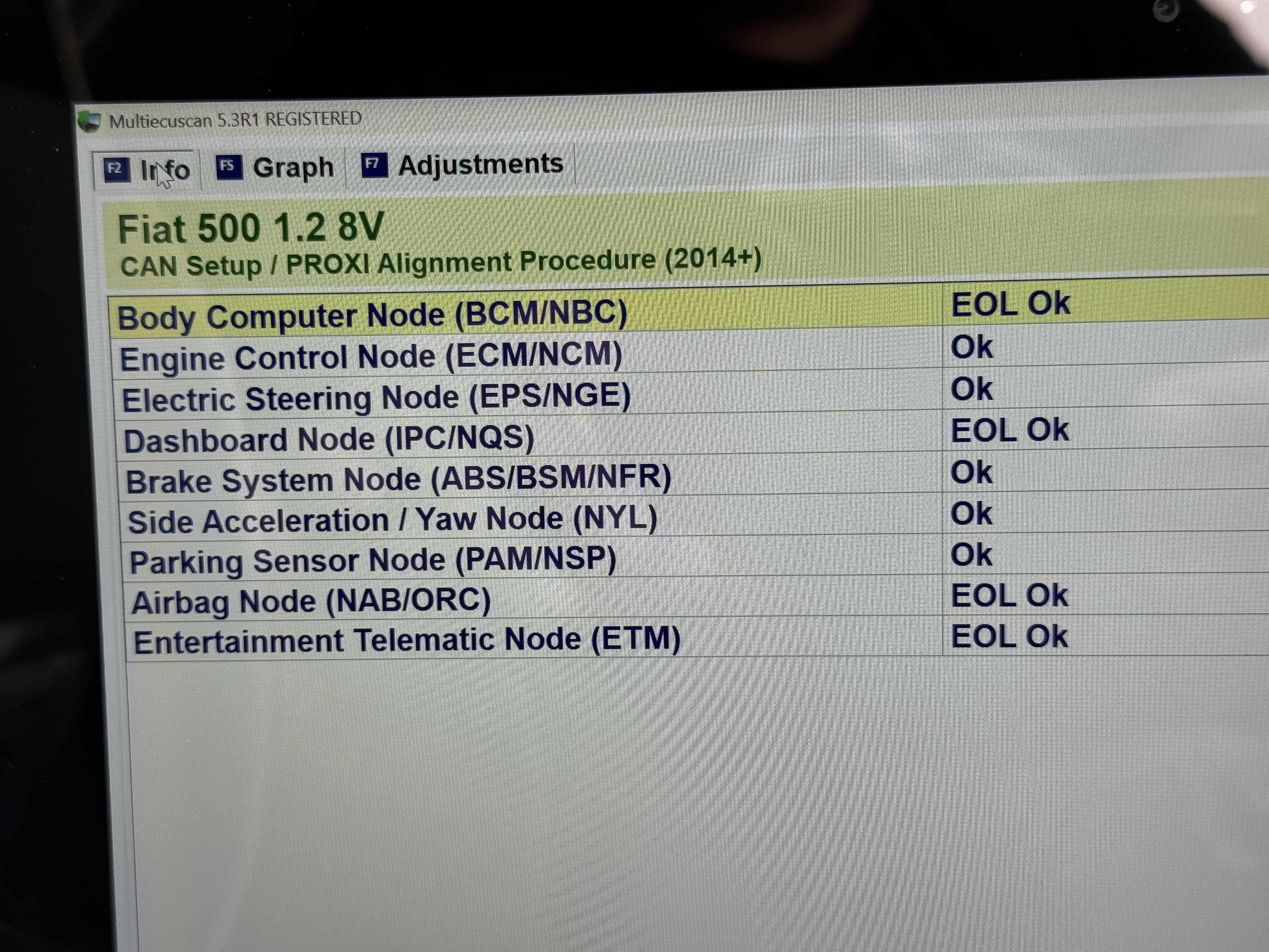

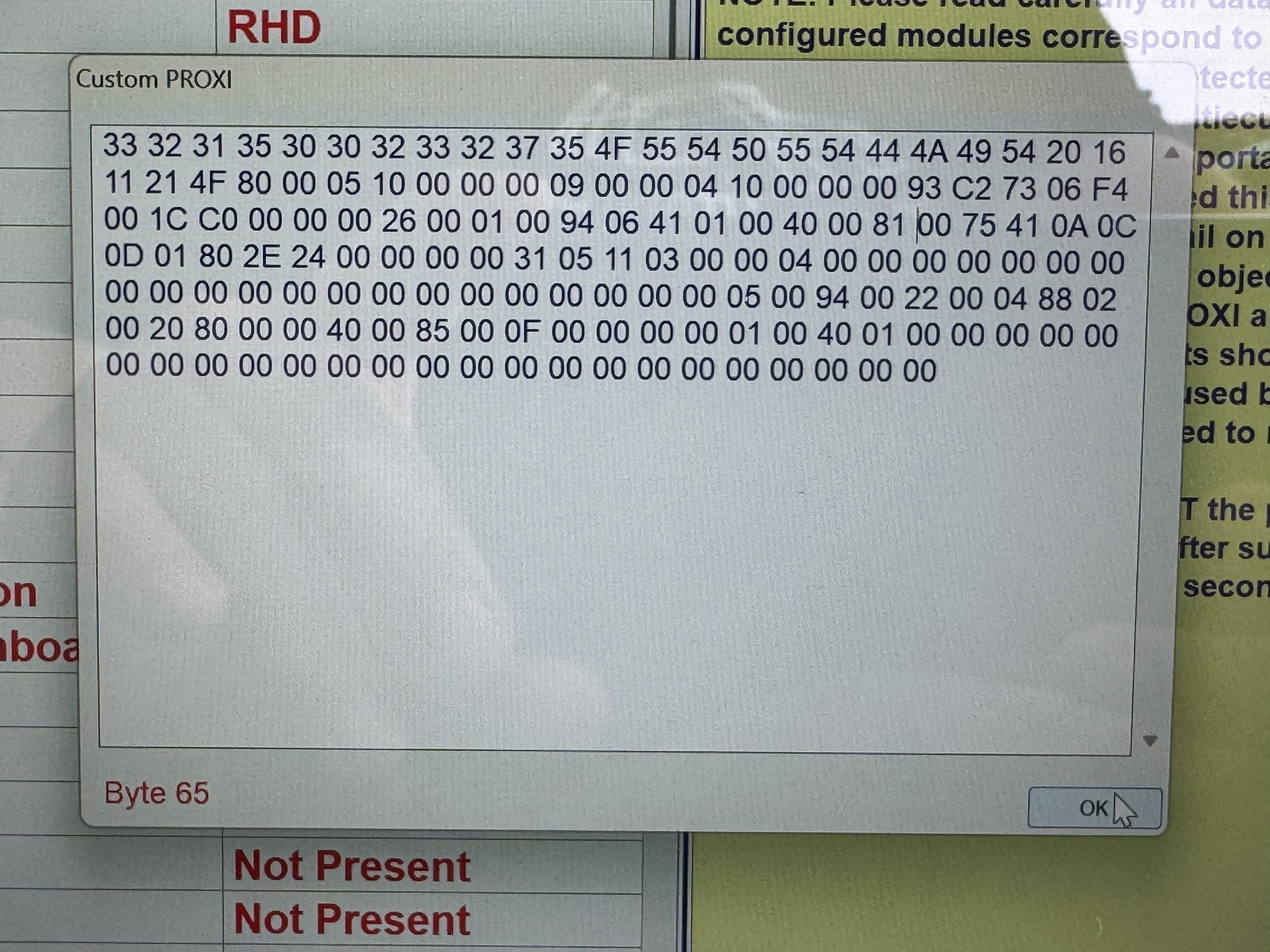

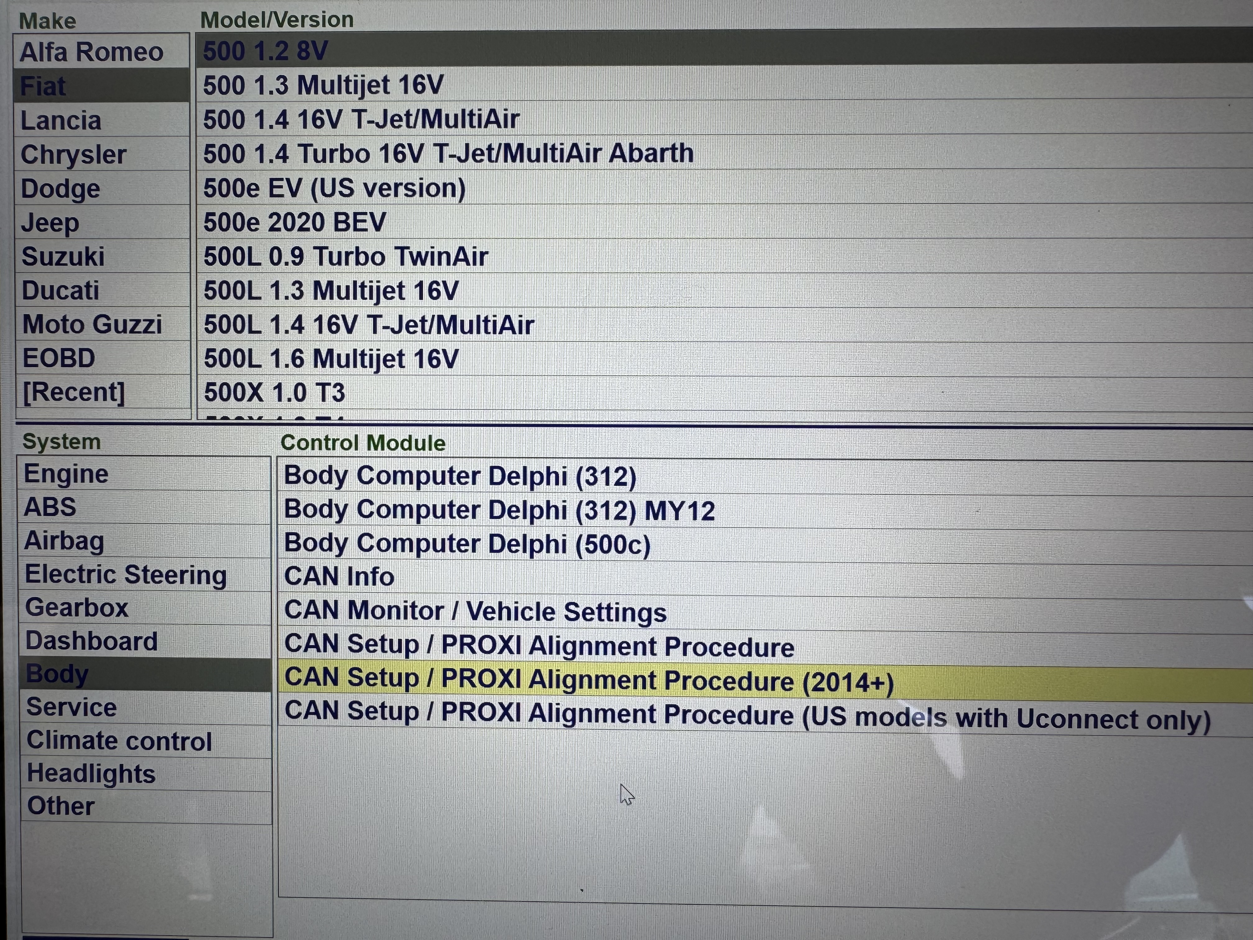

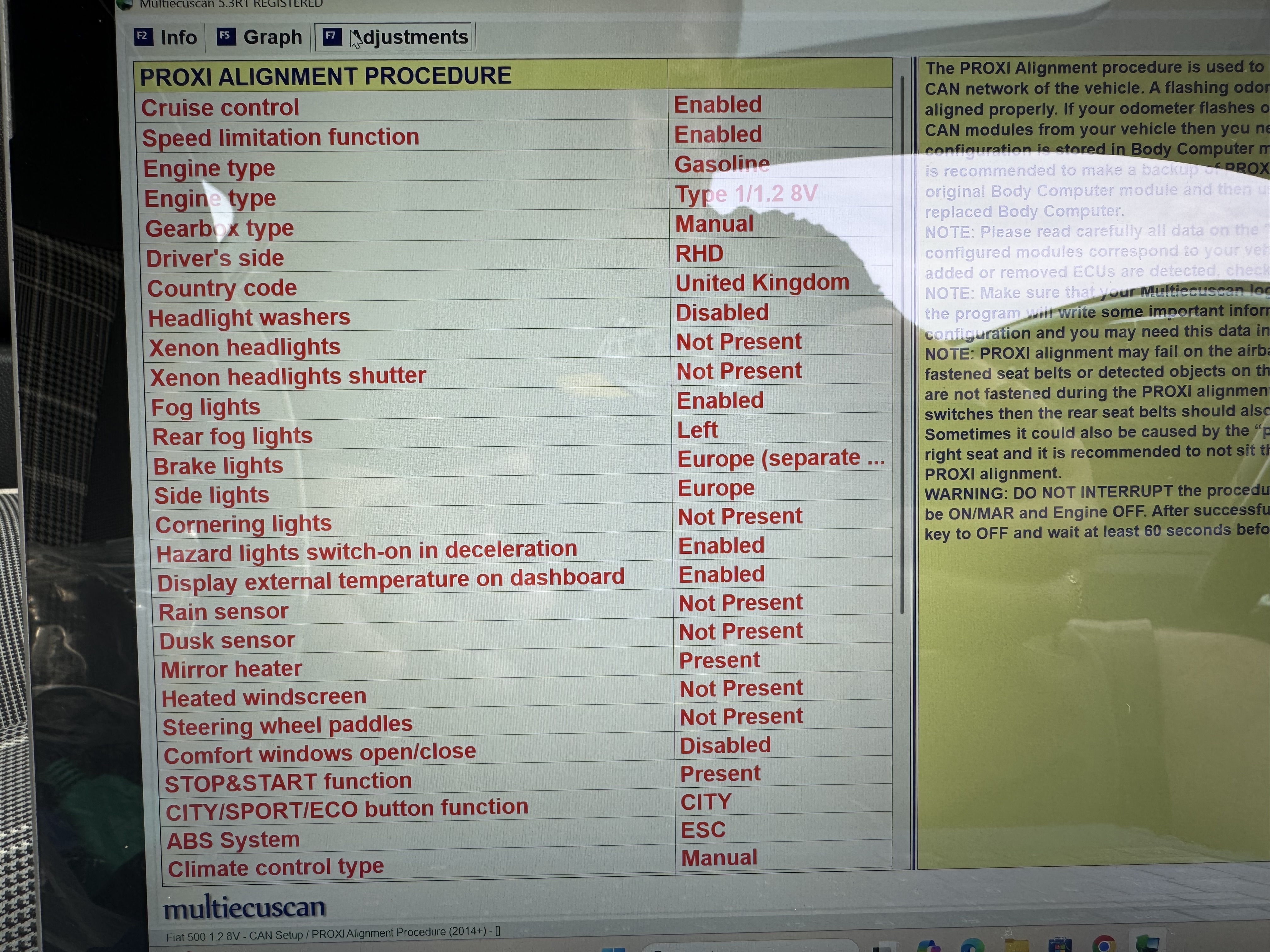

Ok, this is what MES is showing me.
Nothing on the Actuators page about “Cruise”, unless I’m looking in the wrong place.
I don’t know if it’s significant but I tried connecting under Body as “Body Computer Delphi (312) MY12” and when it connected it said that it was invalid and reporting itself as “500c”?
I can’t remember how/where I changed mileage to be honest.
