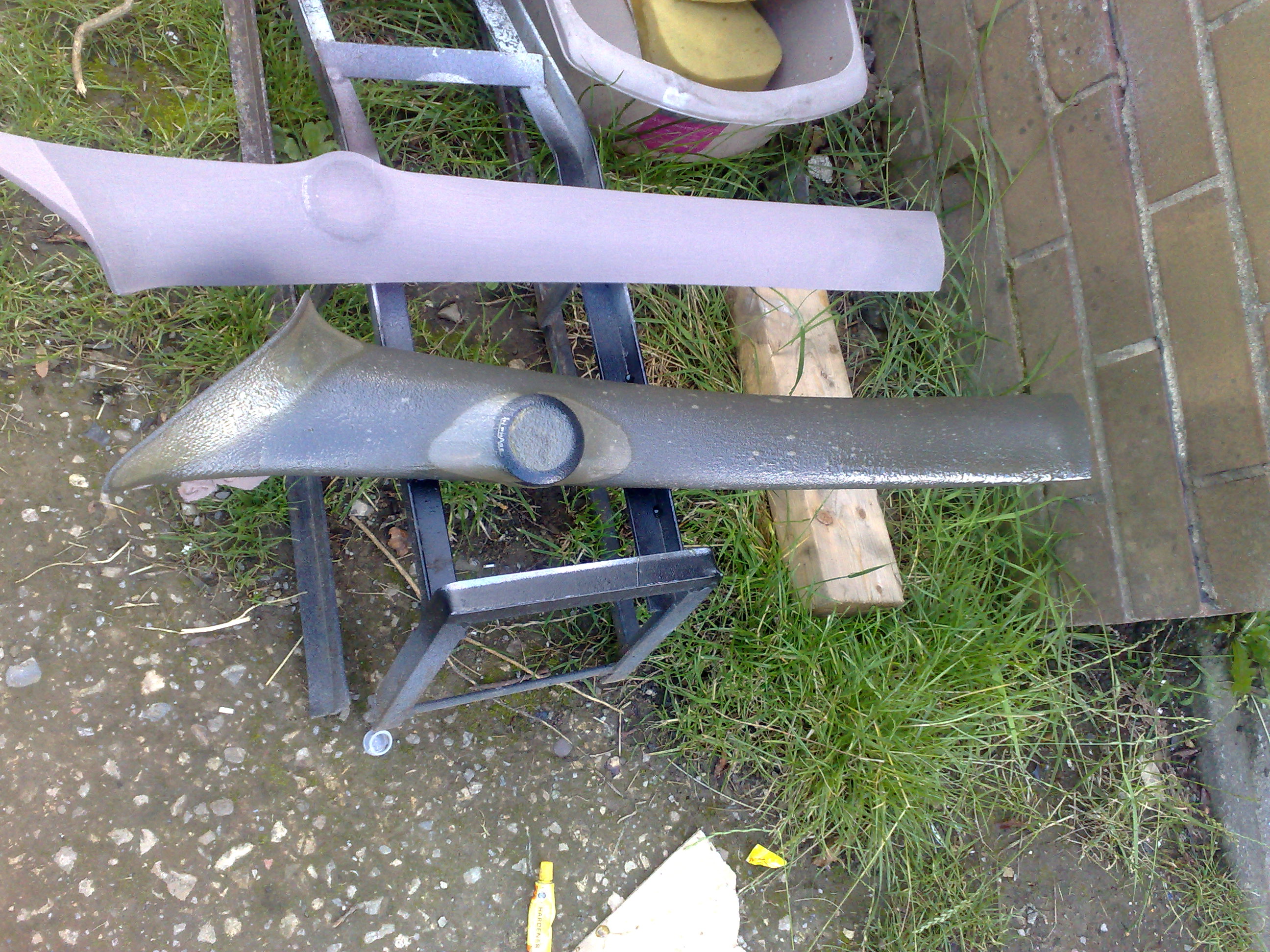

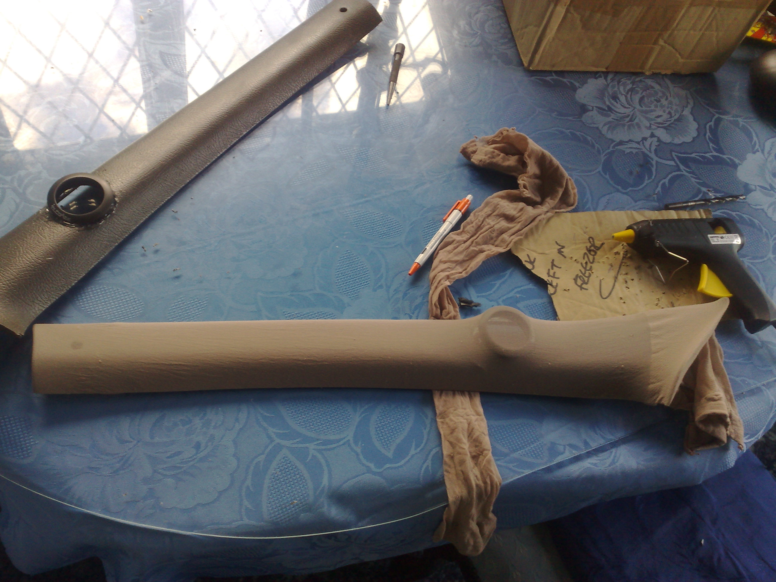

I drilled the holes to cut out the main tweeter shape.
Then I hot glued them in place at a slight angle.
I then asked my mum to borrow a pair of tights. Her initial response was "You playing dress up?" lol
So I wrapped that tight around it then hot glued the back to keep it in place.
Then I went on a resined it! I'm really happy with the result so far! I have done 2 layers and dependent on how sturdy it is tomorrow, may result in me doing another coat but it seems thick enough!
I will have to get some fabric tomorrow and some of that spray glue in a can.
and when it's fully dried I need to drill out the holes for the tweets and the screw at the top, then sand down smooth.
What you think?
Looks like you are doing a good job of that. Im surprised that the tights were dense enough to soak up the resin, would of though it wouldn't be thick enough to form a good base, but looks good so far.

Thanks. Yeh at first it was kinda sitting on top but nothing my paintbrush couldn't solve. I just put more on and I could see it soaking it up behind the tights.
If it's still flimsy tomorrow when it's all dry I shall give it another few coats to make sure..
Never thought tights could be so handy lol.
About colour coding - I don't think I would be prepared to get an even smooth finish, smooth enough to paint - And even then I would do it black.

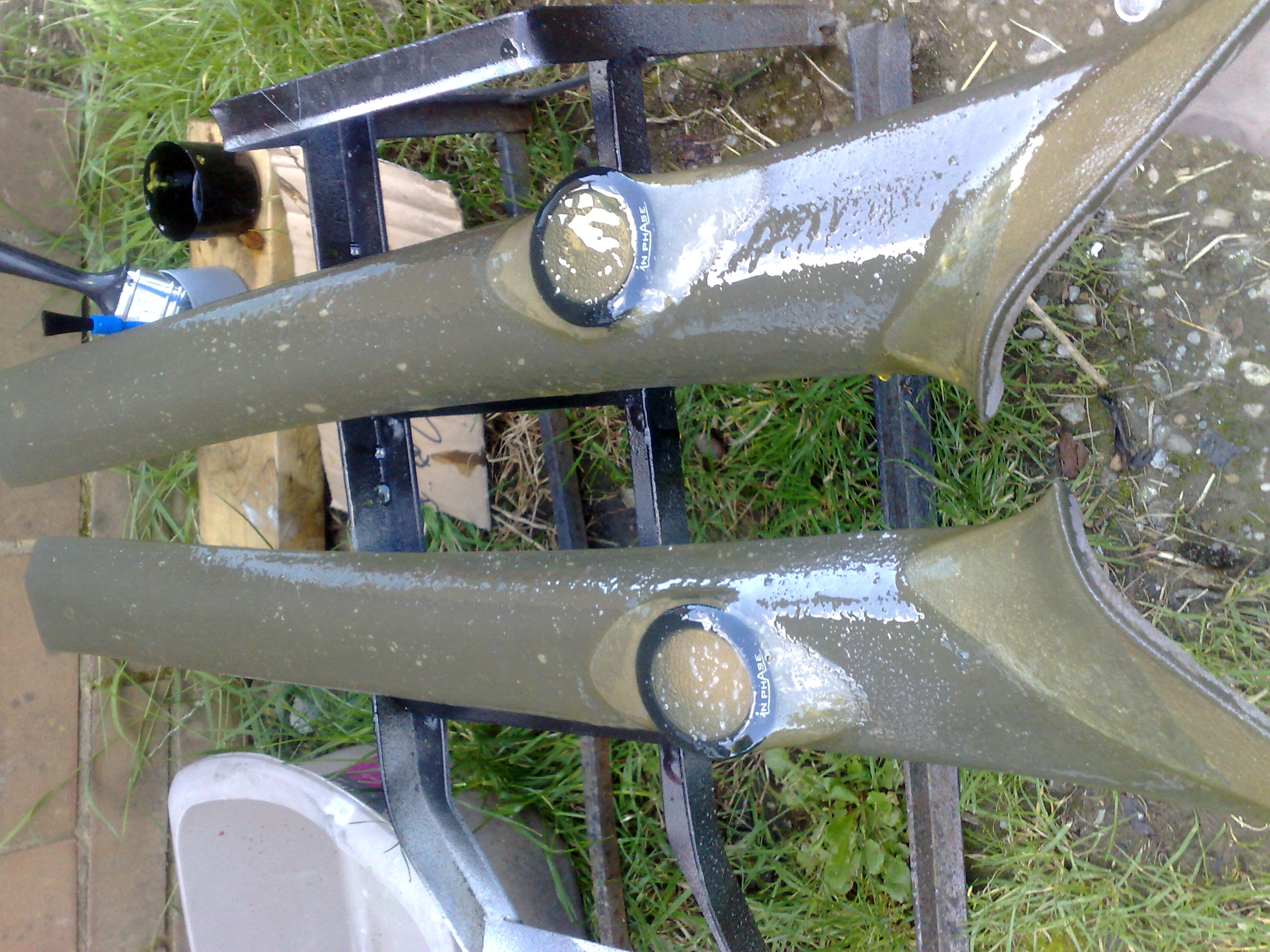

Ok so it turned out hardener for body filler wasn't that great. It has stuck, but still flimsy so I went up to ASK and bought some resin hardner. This is what I needed in the first place. duhh!
So i've put a total of 3 coats on now 2 - filler hardener 1 - resin hardner
I will end up putting another coat on in an hour.
Bought my fabric too, it's a light grey which I think will go with my interior and dash etc. £9. It's also like i nthe guide with the foam backing
This is becoming quite a cheap thing to do.
Resin - £6.00
Hardener £1.50
Fabric - £9.00
Glue spray - £3.00

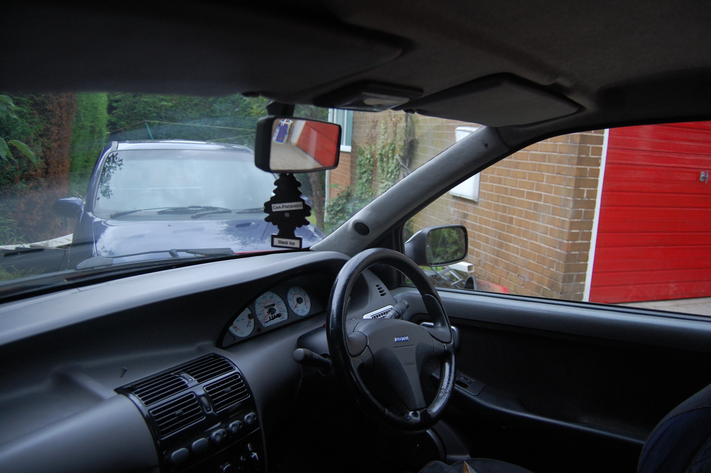

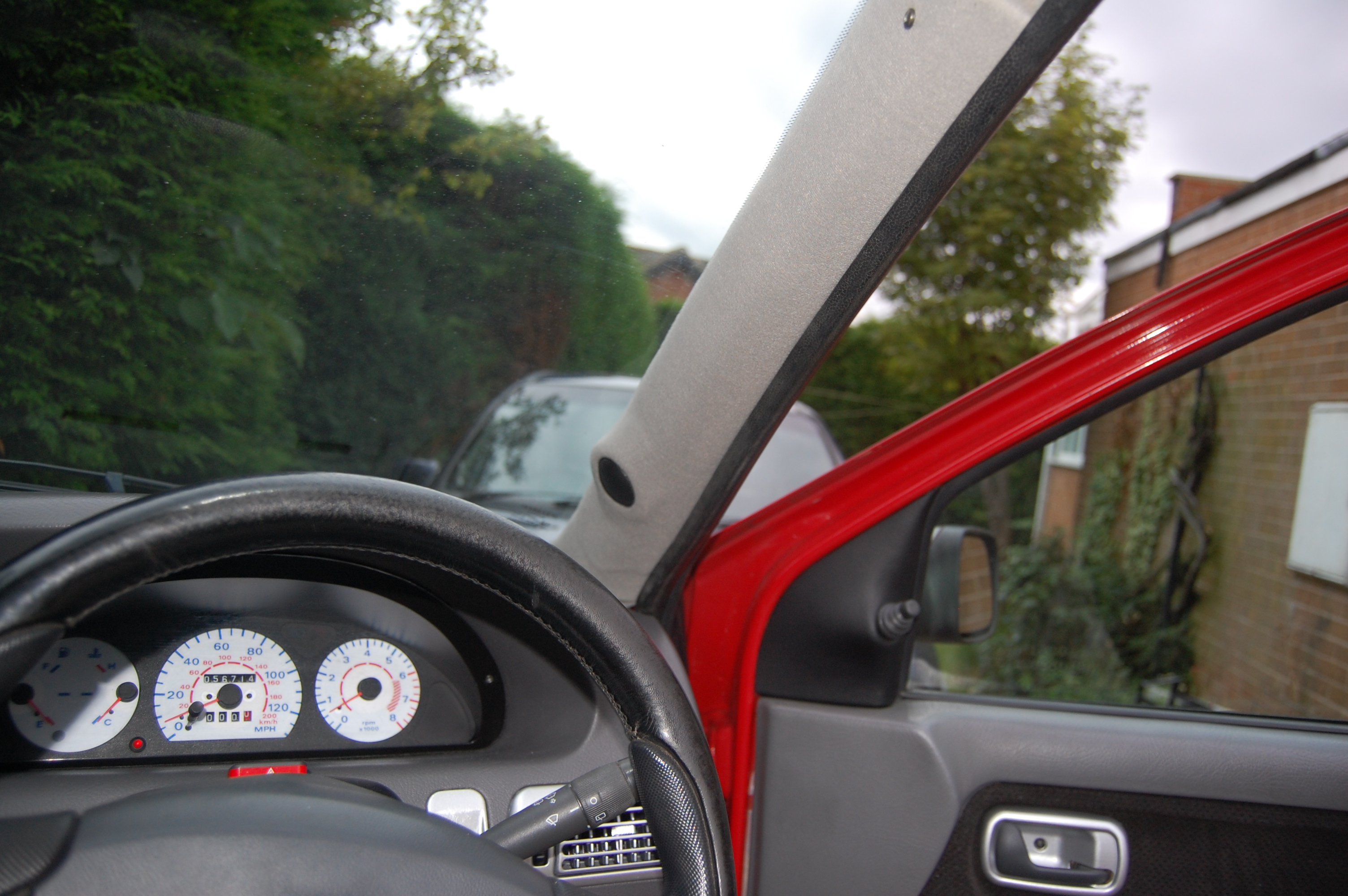

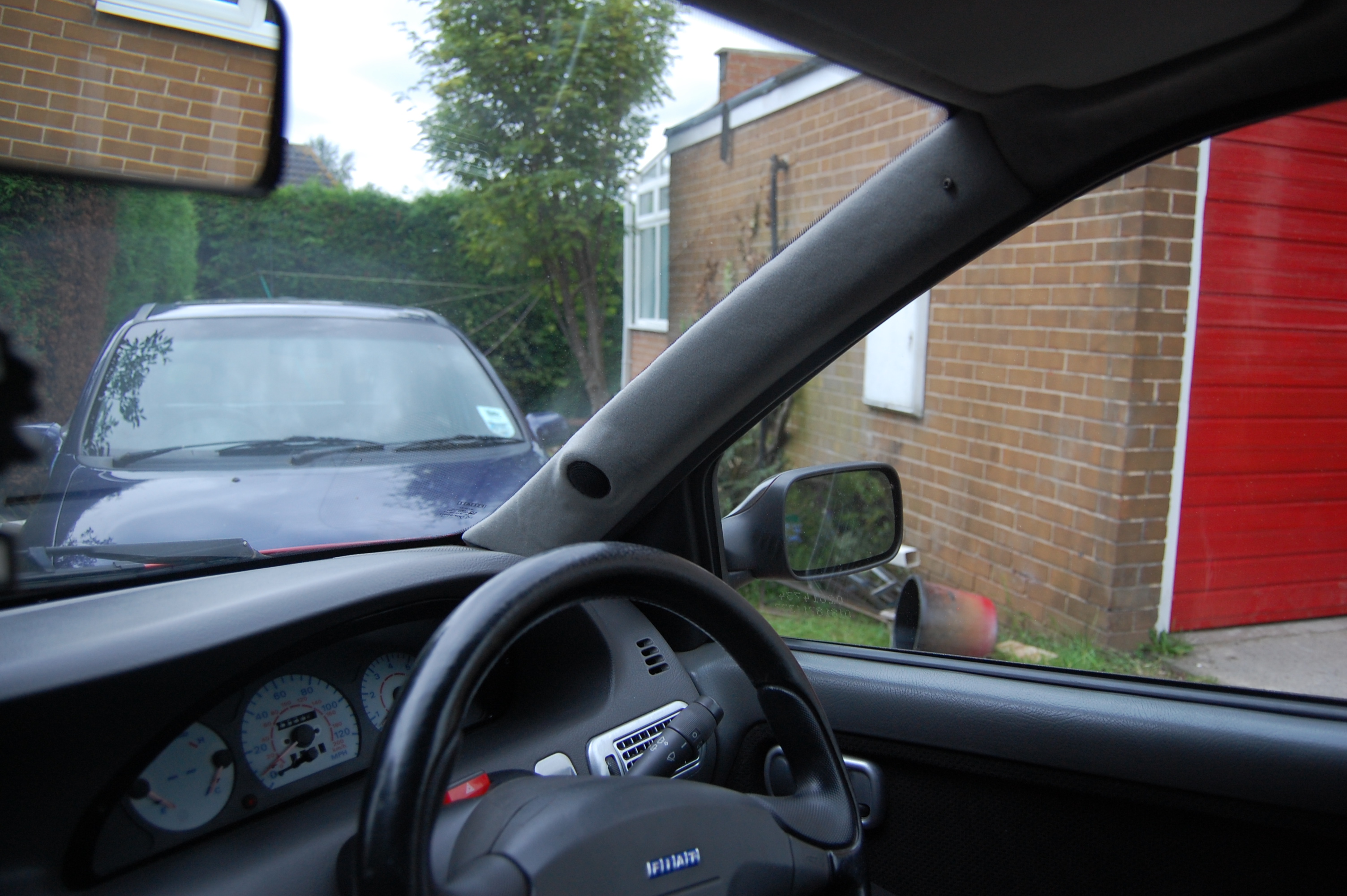

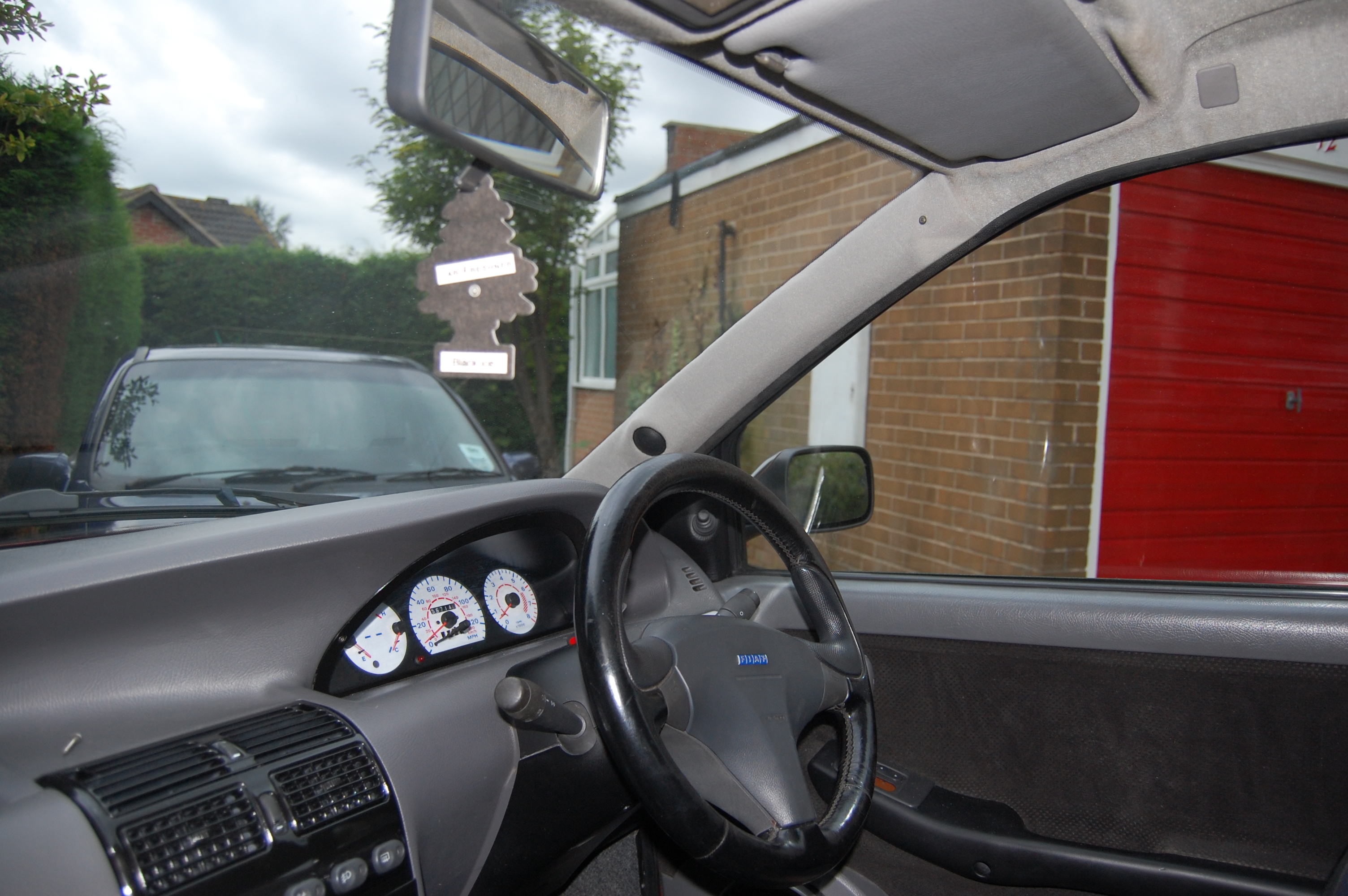

I have completed one side.
It went pretty well although there is a clear rough part where I had to tear away the Resin for it to fit in the gap but overall looks not bad and sounds a lot better- which I was going for in the first place. I would have chosen black too!
What do you think?
They look pretty good, the only things i would say is that it might have been better to mount them slightly higher - more at head hight, and also that it would have been better to try and angle them more into the cabin - so that all the sound is directed at the people in the car.
But they look good, pretty professional for a first go, sure you could sell that sort of thing on ebay or to other members :)
Cheers.
I tried having them higher when I did the test but they sounded too trebally (word?)
Lower down sounded a lot better.
And they rotate on their axis so I can point them at the driver, in the pics they were flush pointing where the mounts were but I can swivel them towards me, to an extent though obviously.
That bottom part is p****** me off though where the resin had to be broken off and you can clearly see the outside. Perhaps I could think of something to solve that.
The other side though seems bang on a perfect fit with no hard resin having to be removed so it's all smooth. Will get results up on Sunday.
