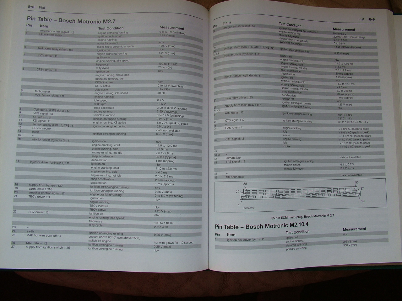

If this is your engine Series number 176 A4.000 this data below may help. Let us know please to help others.:)
