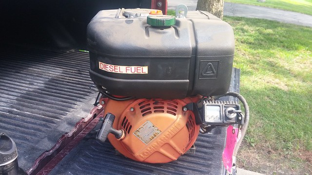

It was suggested that I start a thread on the trials and tribulations of my retirement project, known as the Jatalian.
The Jatalian will be the result, hopefully, of stuffing this electric start 315cc Lambordini diesel
into this pile of parts that was once known as a Suzuki GS550L.:D
Japanese bike, Italian Diesel=Jatalian.

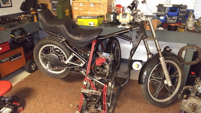

The original plan was to use the ‘zukis 6 speed transmission even though the Suzuki in kit form was missing a lot more than I was led to believe. Not one to let things like that deter me because our motto at ‘Outhouse Engineering And Fabrication’ is “Measure Once And Hope For The Best”, I tore down what was left of the engine.
Then separated the crankcase from the transmission with long Sawzall blade.
That lead to a lot of measuring, once, and head scratching. Like how do I stuff ten pounds of potatoes into a five pound bag?
More to come.
How to stuff ten pounds of potatoes into a five pound bag? You make a bigger bag. Or in my case, I cut the down tubes.

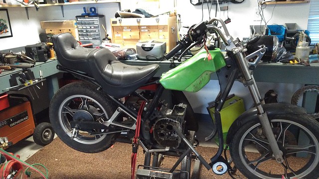

Three months, still no tubes. I decide to fit the fuel tank. Ya know what? The Kawasaki tank and the Suzuki frame don't play well together.
Those two smaller tubes that run along the main tube and down to the gusset need to go. So do the Suzuki tank mounts.
Otherwise, the tank will sit like this. Not cool.
I cut the tubes and mounts off but found that the part of the small tubes that were welded to the main tube needed to be modified. Break out the BFH and the hot blue wrench. It took an afternoon, but I got the tank to fit.
As you can see, I'm contemplating either a cafe' style seat or the stock king/queen seat. I'm leaning towards the cafe' and the missus wants the other one. Which is surprising, because she doesn't like riding two up on my CX500. She prefers the Ural sidecar.
