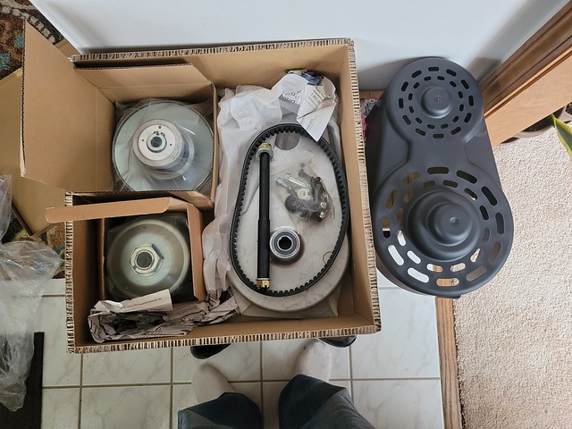

The CVT showed up 4 days earlier than expected. Big thing.

One step forward, two steps back. It was great to get the CVT four days early. Not so great that of three possible bolt circles on the crankcase, the CVT fits zero of them. Not the end of the world. Just one more facepalm and head shake that causes me to walk away for a few days and work on something else.
