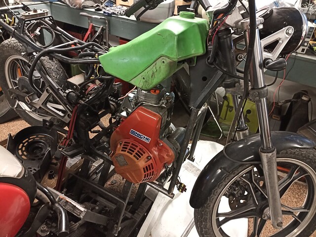

A little luck and progress this week. I should have bought a notcher years ago, just not this one.
One more square tube to fab up and I can tack everything in place and see what else I didn't think through.
Finally have the engine bolted in place.(y)
Now, I can take the engine back out, remove the wheels and the triple tree, then take the frame outside of the garage and weld it.
