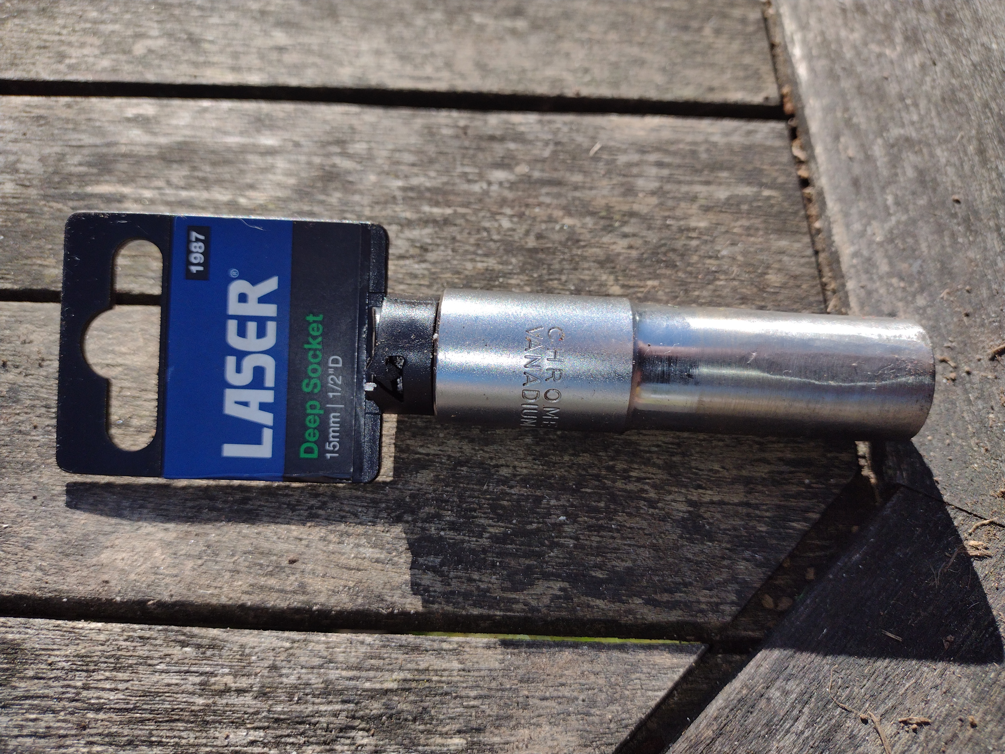

I attempted it at the weekend but my 15mm thin-wall socket isn't thin enough so I'm waiting on a new one arriving.

No amount of 15mm thin walled sockets would fit through the threaded hole, waiting for a set of box spanners off Ebay to arrive!

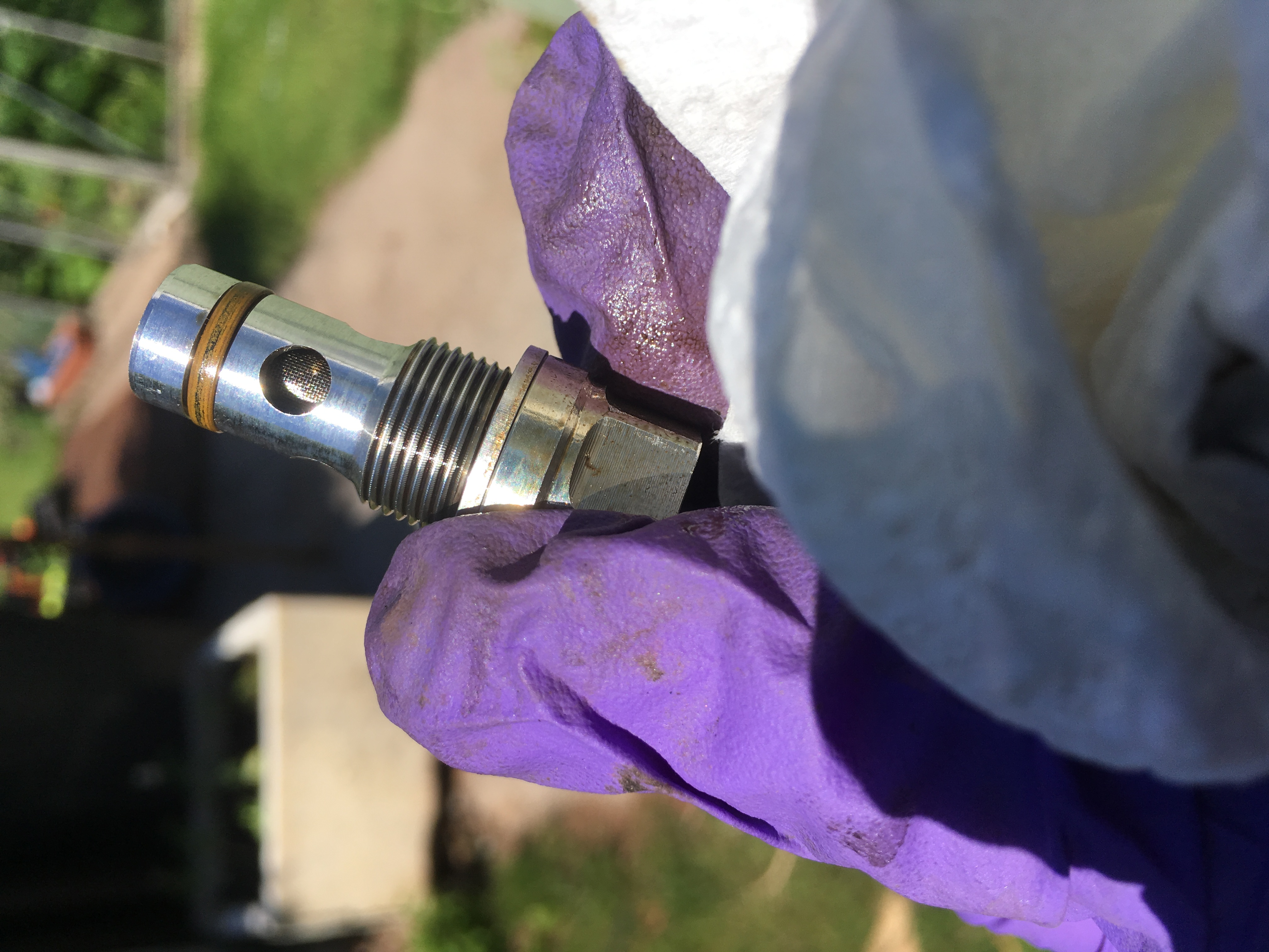

Finally got around to cleaning it, the box spanner tip was a good shout.
This is on oil that’s done 13000 miles, I thought I’d look at it on old oil just out of interest in case changing it flushed out any gunk. This is the longest it’s ever gone without an oil change, usually i change it after 10000 using 5w40 as it’s a 2012.
No horrors - no lumps, no gunk, just oil. Not bad for 90000 having seen the state of some of the Multiair strainers after 50000. Before and after blasting with carb cleaner shots below.

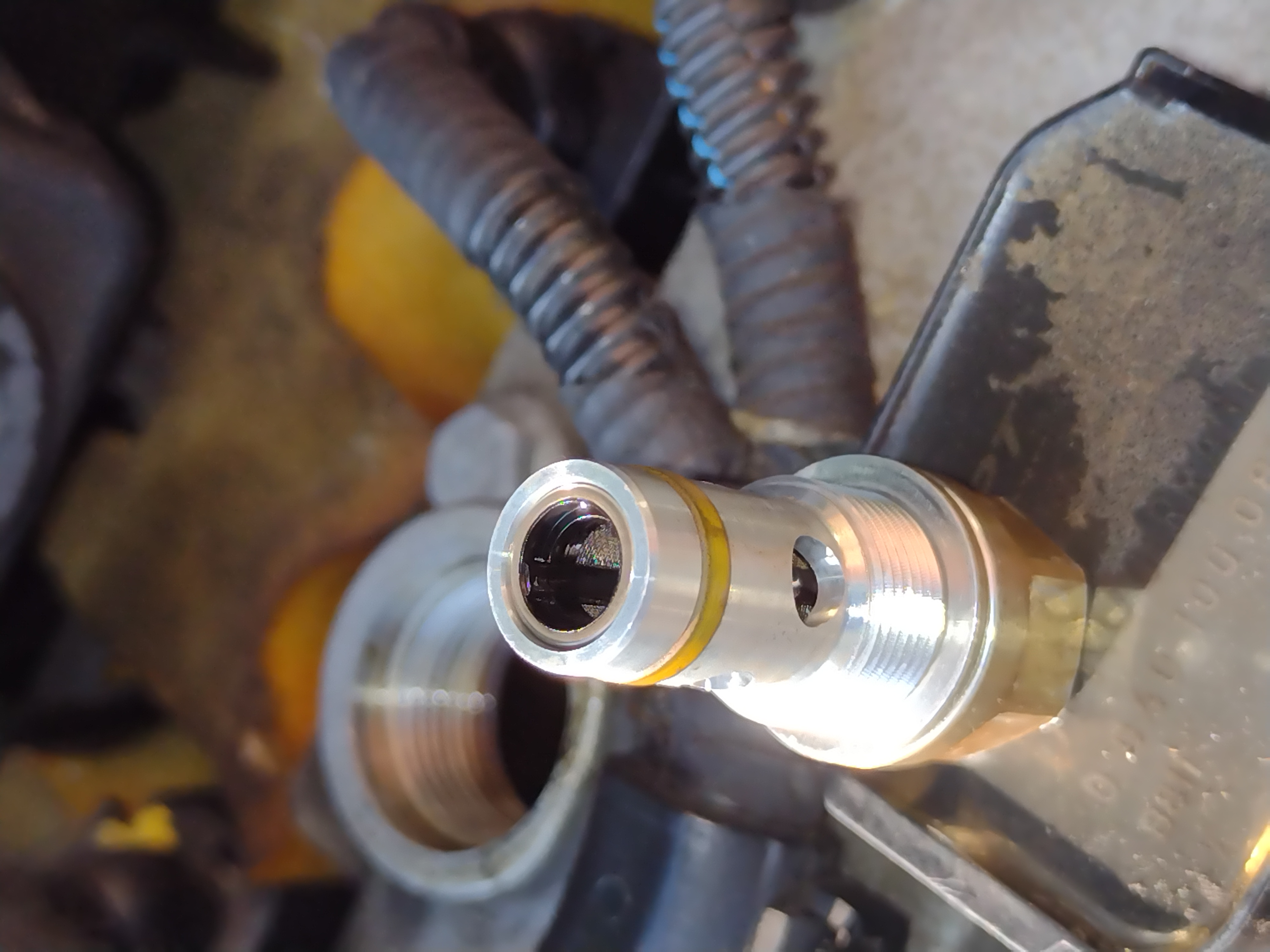

Just done mine on the Punto TA.
Mine had the metal plug & I couldn't get any socket small enough so I ground one down with an angel grinder. To make it extra thin wall deep reach.
Forgot to take a before pic but was much needed clean out
What size hex?
I will need to prepare one :)
