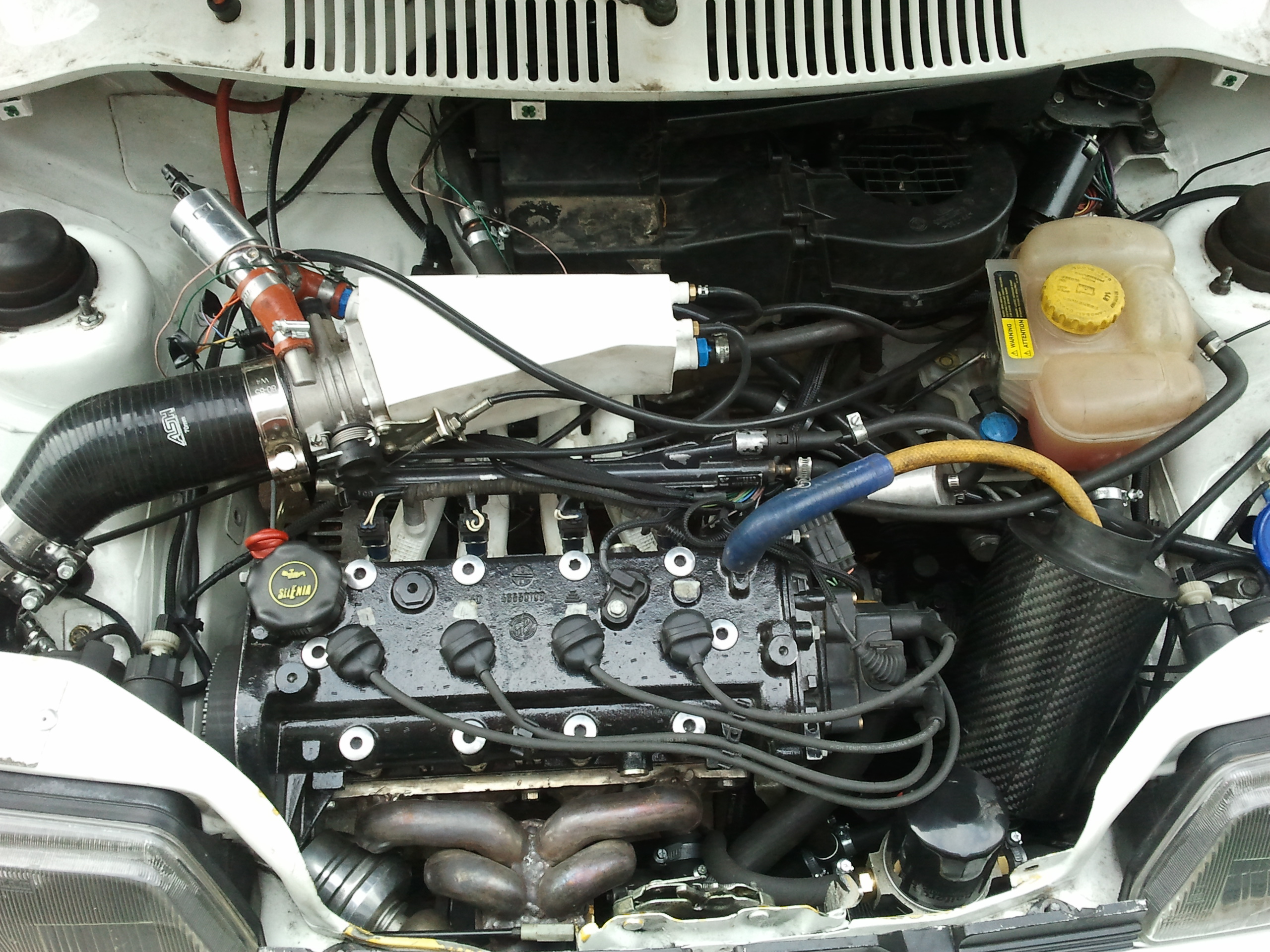

IT LIVES!!! took it for a few laps around the block... no problems :)
yet to weld a silencer on the waste gate so it is loud (scremer pipes really do scream.) but not as loud as i thought.
the power output is VERY smooth compared to the 8v but right now its running way to rich (using munkuls maps with the required fuel bumped up) and has an on throttle misfire. oh and the throttle only opens 60% because ive yet to mod the cable so hard to say what it will be like. but so far im happy

all I can say is the waste gate has a 0.5bar spring in it (so low boost) and atm at anything above 70%throttle and 3500rpm the engine has a massive rich missfire thats like hitting a brick wall but up to that point the car accelerates faster then the 8valve ever did, even when it ran at 3bar due to a split hose.
it is truely fecking rapid.

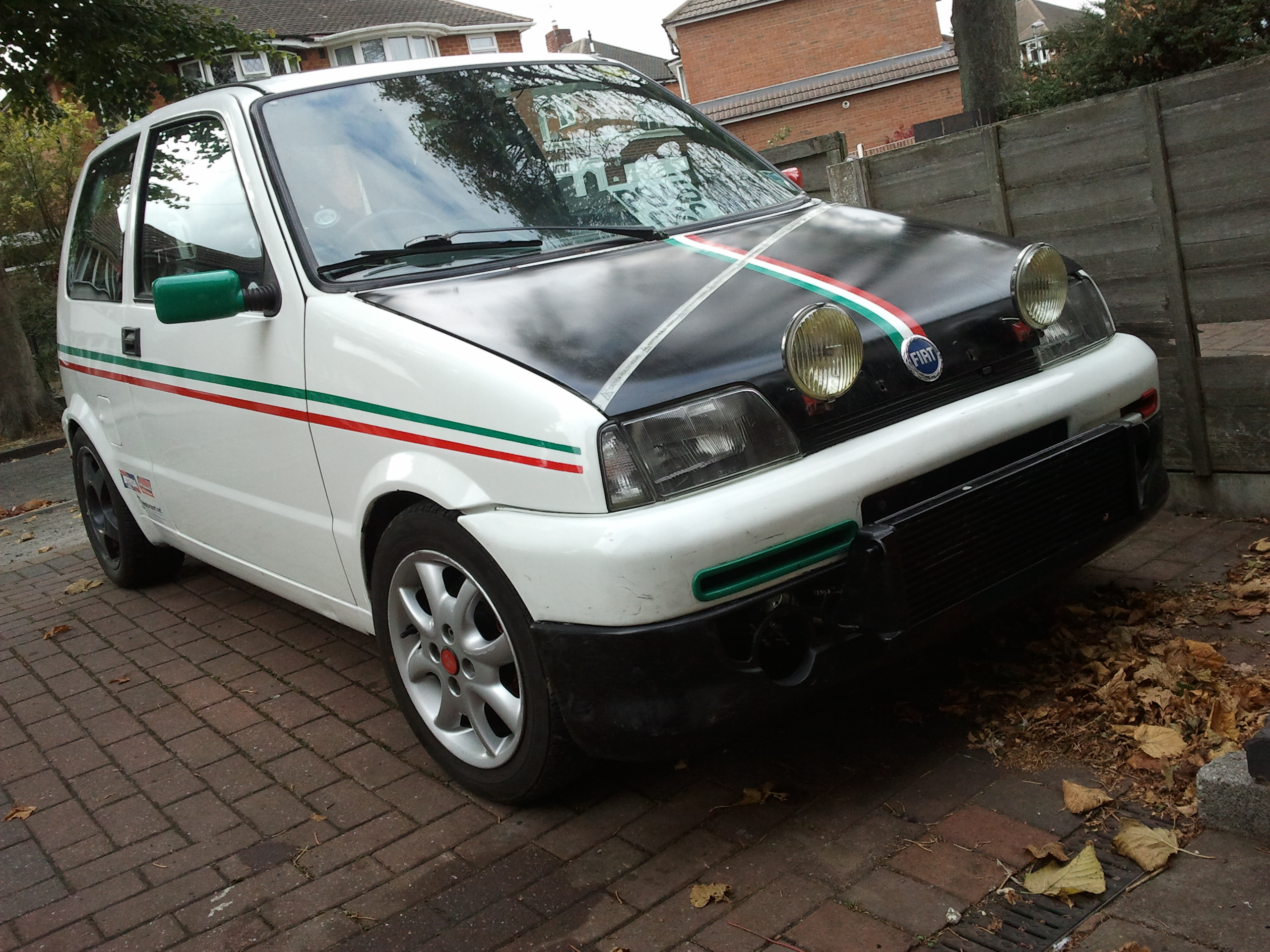

yeh white sei look poo.
took the car for a blast down the lanes today. its sooo much nicer to drive the power output is so smooth that you can really get on the throttle without fear of boost sending you into a fence/ditch.
its got a bad miss fire at above 80% throttle and on boost that is not nice. tired to sort it but nothing seems to help. its a strange one. if i take it easy it wont miss at all all the way to full throttle/boost 100+mph :p
looks good :) apart from all those pipes/cables everywhere! Surely you can do a neater job than that :p
IMHO sounds like a weak spark... could be low dwell but if its same as I had it should be fine... could also be a weak coil or HT lead.
Ive had similar problems and it was a HT lead causing it, and you're still running standards which are pretty wanky. K1 ones are reasonable and have a lifetime guarentee :)
EDIT: oh you said it makes full boost :eek: strange... it isnt the ECU losing sync then? Have you done a lost sync log?
:O bugger off! Id like to see someone do a better 16vt with oil cooler/remote filter with less and neater hose work! lol
after I posted on here i did think that maybe the dwell is a bit low (not changed it since the 8v with the two single coils) the coil stays cool so might crank it a little and see... could be the HT leads also i guess.
No its not losing sync or restarting. I run hall sensors on both cam and crank and the signal is perfect.
