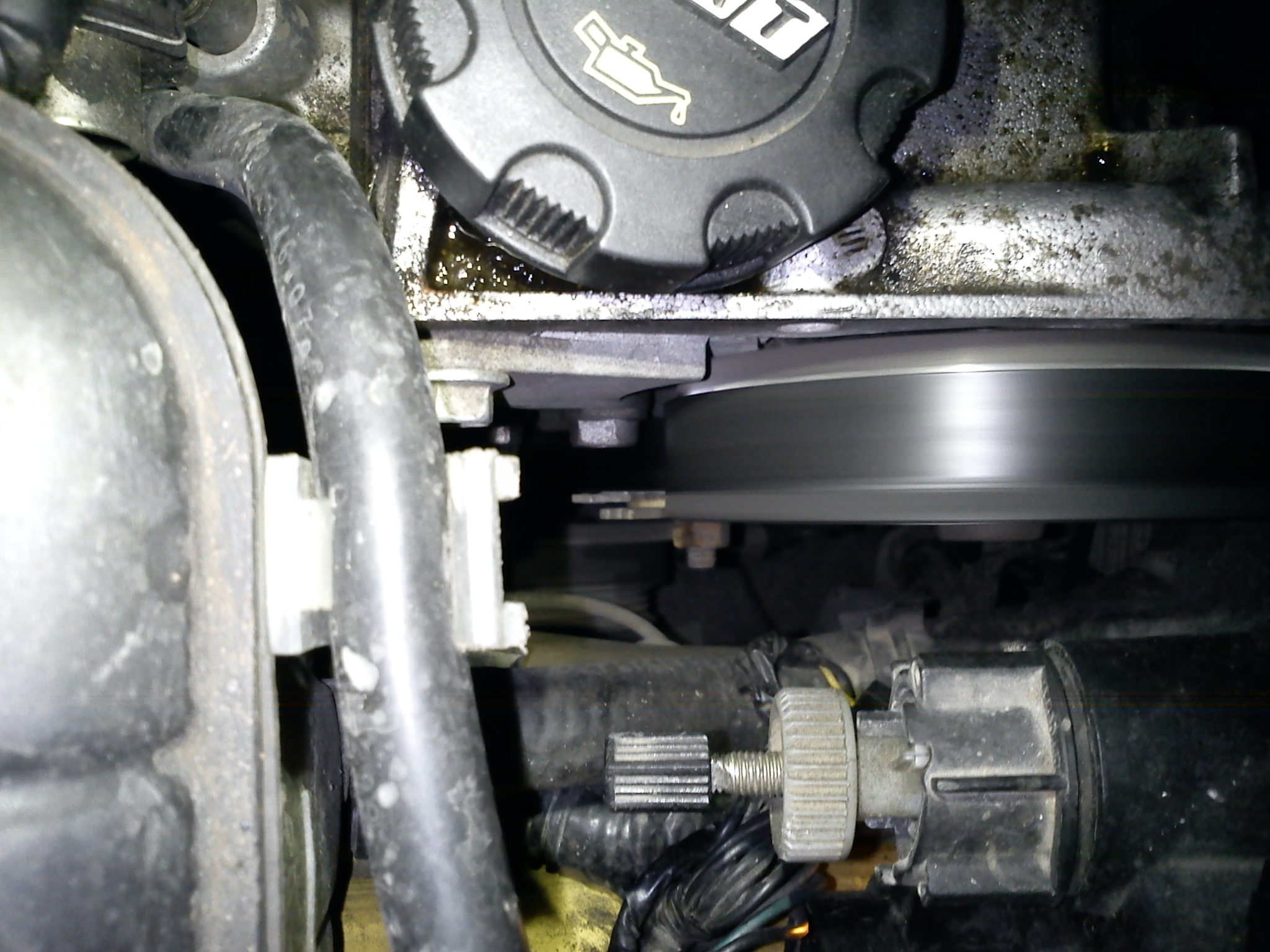

i changed the tensioner on the car, its on a stud with a nut holding it on, just drop the engine on the drivers mount and it will..... just.... allow you to get it off, although may scratch your head :p

I'm amazed that you can stay calm and put out the engine after putted it in for a tensioner change :D
Every job like this requires a lot of patience, but this stuff like tensioner problem will probably **** me too much :D

Here are the pics, is not the clearest, but you can see there are loads of room between the tensioners to the chassis!

ming that is strange. every cento ive seen you have no hope in hell of removing the pulley.
