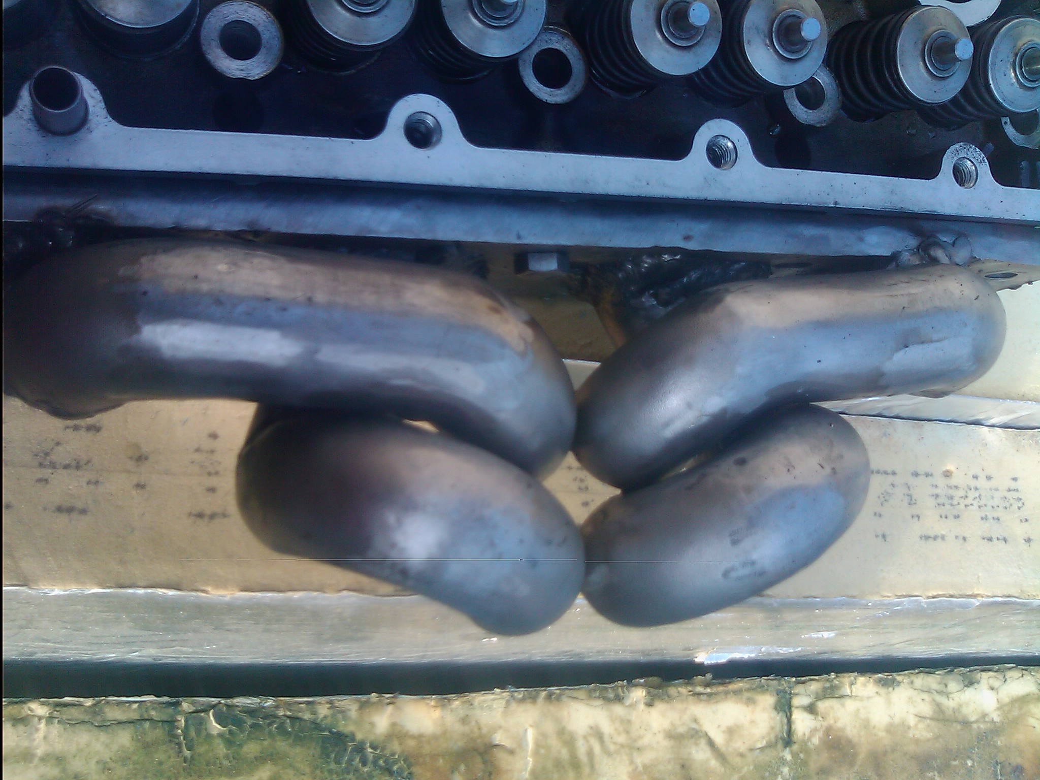

progress...
welded the two inner tubes. sorta... the welder went all pissy on me with the gas not coming out the nozzle! took it apart about 4 times before stripping the whole thing to find the liner has pushed itself to the end of the gun and started to melt blocking gas flow (n)
getting there though!

lovly work i have to say :)
and rome wasnt built in a day
