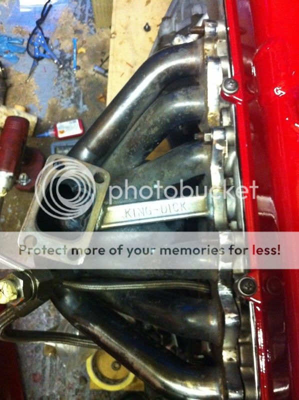

Know you prob did a test piece but hows ur penetration on the ss? if it was me personally i wouldnt be worryed about dressing it id be more inclined to know the weld was decent and not going to crack under heat etc as you can gt a weld to look decent but it can still be **** weak, just a thought as i know on the coupe ss manis theyve cracked around weak welds?

in theory, yes. That is why some high end cars have swivel rose jointed fancy turbo hangers.
In reality, not really. Having got a great insight into the drift world, where 99% of people use one or two solid manifold braces, I'd say if your manifold is ok, you position your brace correctly, and your engine mounts are ok, then a solid brace will be 100% fine!
There is no other motorsport that puts as much stress on car parts - drivetrain, engine, mounts, turbo, exhaust, etc etc, if drift cars work, then any car will.
I havent got a pic of mine - all it is is a small bar that bolts to the block and the turbine housing, to stop the pull from the exhaust through engine movement.
how would I go about with bracing?
surely if i weld a bar from the turbo flang and onto one of the many unused bolt holes on the block (aircon) then wouldnt the manifold expand with the heat and the brace wont and so make it more likely to crack?
That'd be my view, anyway. The correct way to do it is to build a tripod mount which is rose jointed (the roses needn't be anything special). Thus, the charger is supported and free to expand in 3 dimensions, so you can't get cracking (or at least stress related cracking) at any point. You can probably pick up suitable stainless tube for next to nowt -- it's not as if you'll need a lot of it.

interesting stuff... came up with something differant though which I seen and makes sense to me...
simply mount the turbo down pipe to the engine... do it so it supports most the weight of the turbo... but mainly it isolates the turbo from the rest of the system.
the manifold expanding won't be a problem as there is more then enough flex in the thin wall down pipe.
and best of all... cinqs have on bolted to the back of the engine as standard... just need to find it... beef it up... make it work with my exhaust

I'd also do the old drill a hole and hacksaw trick to the exhaust manifold flange -- essentially it'll allow for expansion there without cracking or distortion, and it's absolutely free.
