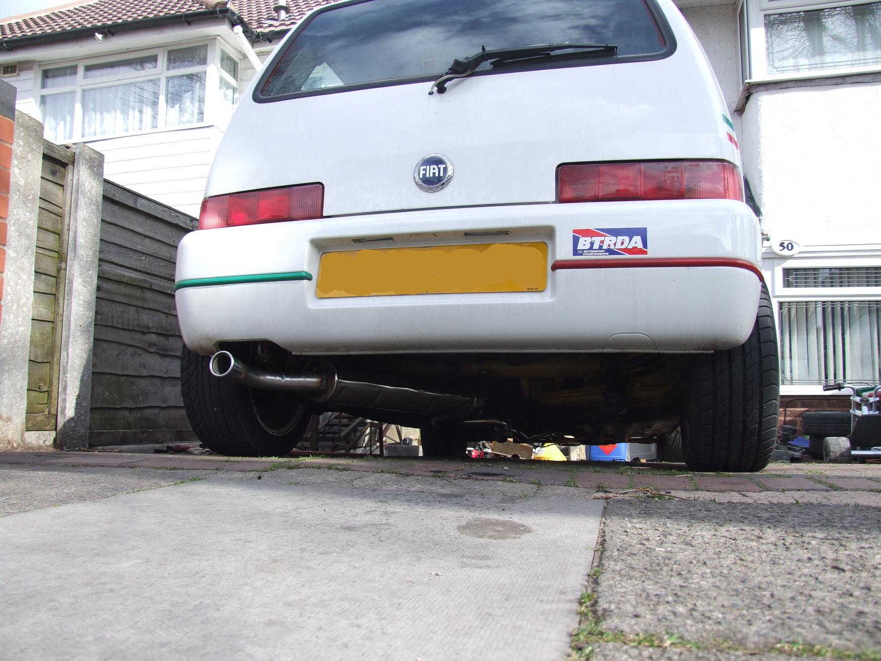

As for exhasts if you want it quiet put a cat in, not only does it help save the planet it makes it a quieter place too. I really didn't how loud mine was with the decat pipe in so once i was sure the fuelling was right I fitted my sports cat and it had zero impact on the performance.
I have a sports cat that i will fit when the car it finished been tuned (no point melting the thing when it hits boost and goes uber rich)Ill probably only fit it for mot to be fair... if you fueling is set up well enough a cat wont effect emissions much anyway
