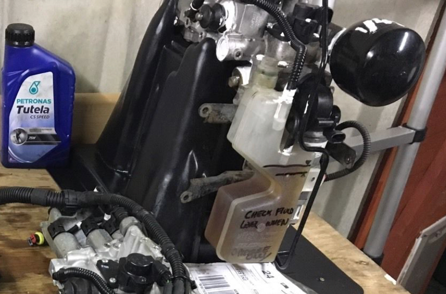

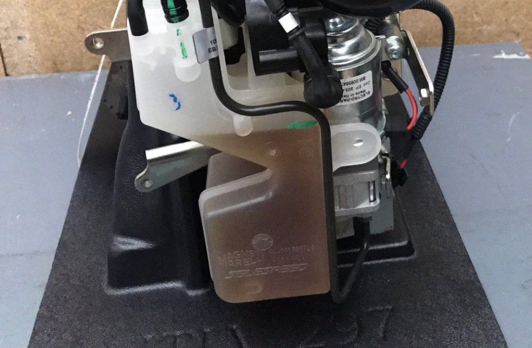

The level of the hydraulic fluid can be seen with the car up on a hoist, the plastic tank can be seen from the nearside (UK car) wheel arch. You can get to it by removing the battery, tray and shield surrounding the tank.
You need the software mentioned above to depressurise the Dualogic system (or unplug the wires to the pump behind the tank and turn the ignition on without starting the engine and move through the gears to do this). You cannot see the correct level while the system is pressurised.
I have added some pictures to give you an idea of where the level should be. You must only top up with CS Speed oil as shown in the picture

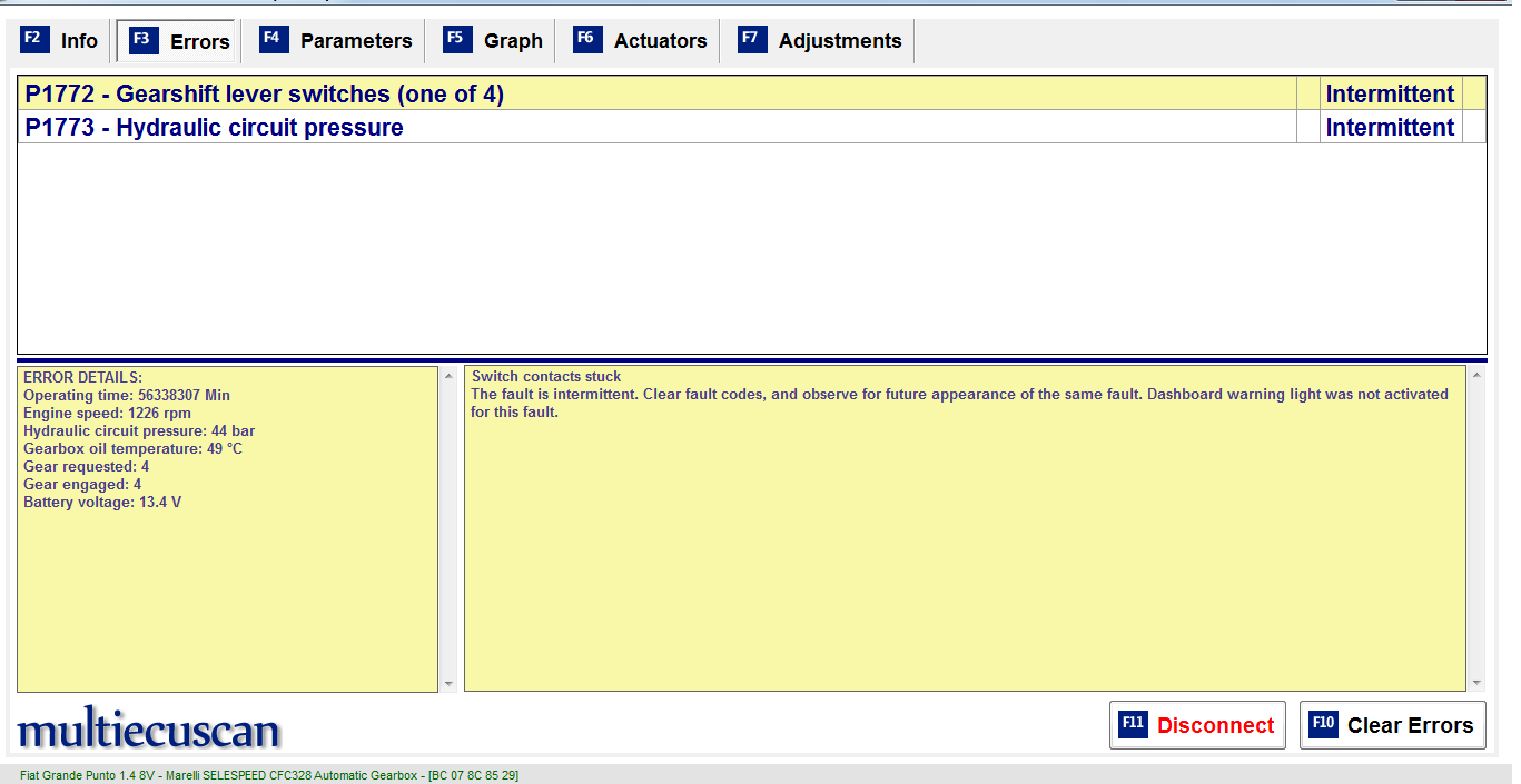

Car info display is now showing 'Manual transmission not available' with red warning light. when i shake the gear leaver little bit it will disappear and coming after sometime again.
I connected the multiecuscan and scan for transmission issues and found below 2 codes.
P1772 and P1773 (image attached)
Checked the oil pressure and it was 48bar and pump is working as expected.
Can these errors cause the issue? Really appreciate your help.

140000miles is good going and shows what the 1.4 engine and Dualogic control unit is capable of, with parts and servicing.
Your MultiECUScan is very clear, the gearlever switch unit is faulty or damaged and the Dualogic Actuator or Accumulator has a pressure issue.
Although since the P1773 code relates to anything on the Dualogic unit, it could be the Solenoid, the wiring, or pump and accumulator IF there is no leak from the actuator.
If the accumulator is failing, the pump will run the majority of the time and also prematurely fail etc.
The pump should run for 3-5seconds on opening the drivers door and on every 5th gear change (with the car stationary and you operating the gear lever from A/M to R etc). The pump should not be running the whole time.
So a hydraulic pressure issue will cause the Dualogic unit to drop into neutral and a damaged gearlever switch isn´t going to be able to communicate to the ECU what gear you want to be in LOL!
I would suggest that you change the gear lever switch unit first ASAP and this will probably cure your issues...
A hydraulic fault will cause the unit to drop into neutral, BUT it doesn´t wait for you to touch the brake pedal first etc. This to me sounds like all of the issues you are experiencing, relate to the gear lever.

So the gearbox control unit is the same part as used on the 500 Dualogics also.
What you suggest is that the accumulator - Selespeed Vessel is tired basically. I am assume you don´t have a leak.
I really do think you have two separate issues though.
You have a faulty gear selection switch - which is capable of sending the message to the ECU to put the car in neutral when you press the brake pedal - which you can do on any Dualogic car, by selecting neutral and braking, even at speed.
A leaking actuator and/or pressure issues can cause the gearbox to drop into neutral - but it doesn´t wait for you to press the brake pedal (as if you had selected neutral by the gear lever on the Dualogic).
There is then a hydraulic pressure error - there is only one error though. If the actuator isn´t leaking, then in my opinion it´s a tired accumulator - Which is a fairly simple fix and less than a 100 pound if doing it yourself!
Depressurise the control unit, using the multiscan software and unbolt the accumulator and replace with a new one - https://www.shop4parts.co.uk/?name=store&op=Details&ProdID=5986&sku=64973
If the actuator is leaking - due to the cost of a new replacement and the value of the car (12 years old and 140K miles etc), you may want to try one of the reconditioned units on eBay for a 1/3 of the cost etc.
