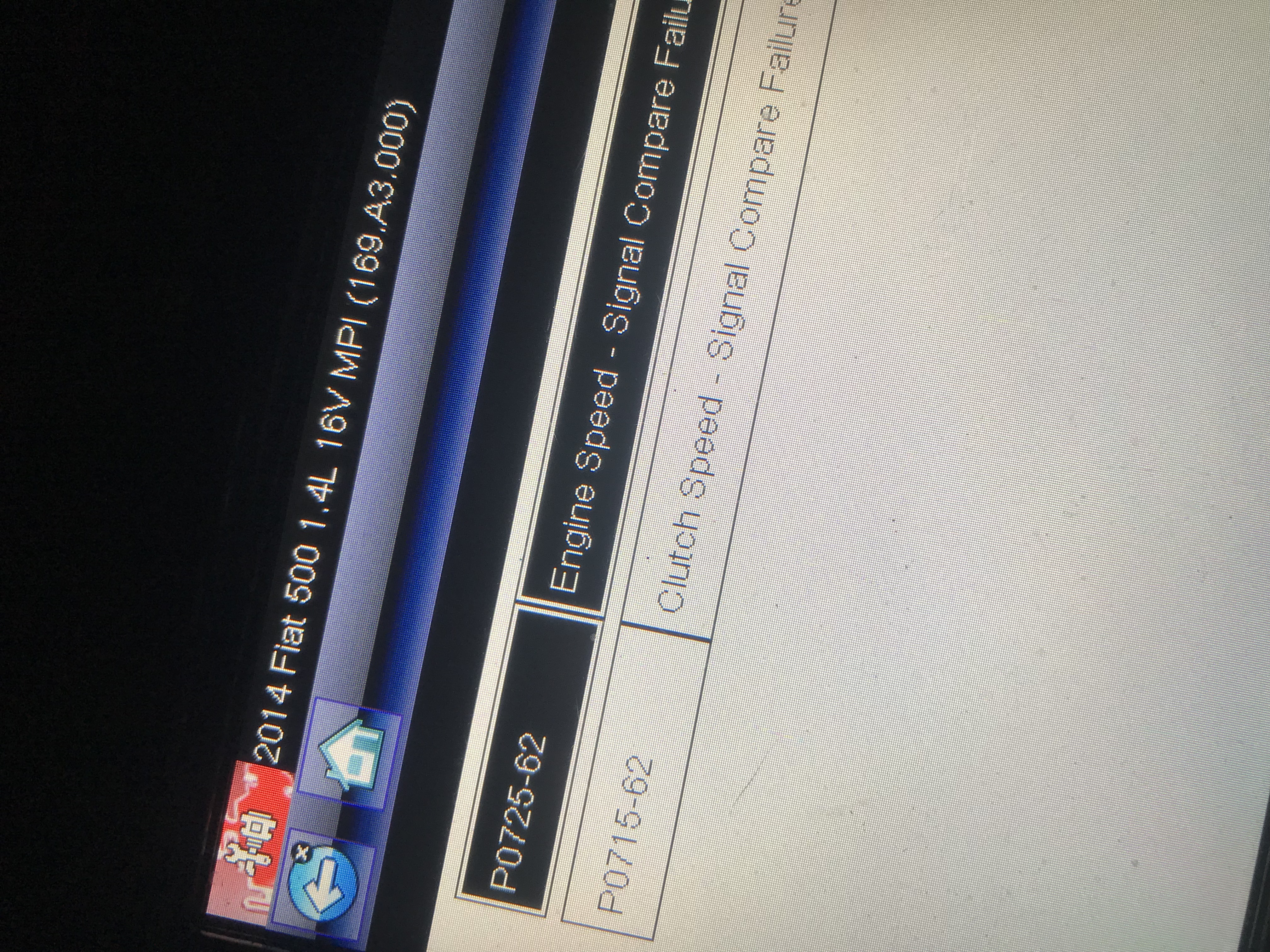

Hi
My partner has a 1.4 2014 semi auto 500.
We have recently just got a issue with the transmission.
It’s jumping out of gear randomly at times, goes into limp mode only allowing 1,2&3 gears.
I plugged the snap on computer into it tonight ..
Any ideas on what the actual issue is and how to fix ?

Hello and welcome.
This problem is so common we've a whole thread devoted to it (this one).
I've copied this across to here so as to keep everything in one place.
Have a read of the previous page; another 500 owner with a similar issue posted only a few days ago and the replies are just as relevant to your situation.
Do not expect to be able to diagnose this properly with a generic code reader. Fiat specific software (either a franchised dealer, or multiecuscan) will likely be required.
As is often said, you need to find a mechanic who truly understands these gearboxes; even main dealers have been known to spend a lot of their customers money replacing unnecessary parts.
