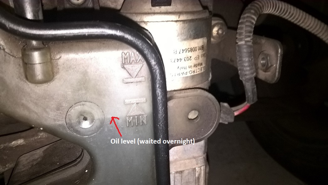

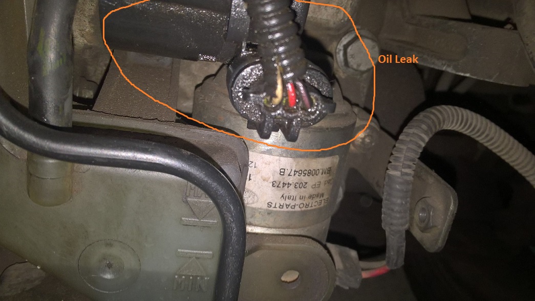

I checked the selespeed oil level (waited overnight) and its little bit under the min mark. (pics attached) also found a small oil leak from the position sensor.
Think this can also be a reason for sudden neutrals.
Yes this could be the reason, but so could the gear selector (as before, pressure issues and the unit drops into neutral - but it doesn’t wait until you press the brake etc)
The system needs to be completely depressurised to get the level correctly.
Do this from the software or unplug the motor and select random gears with the ignition on etc.
You may find that the leak is so small that topping up gives you months of driving without issues - trying to be realistic on the mileage and value of the vehicle etc
I suspect that the pump is still running too long, for what probably is a tiny leak.... so que tired accumulator and then much later a worn pump
