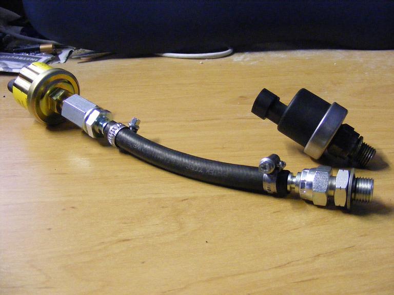

i've also had loads of deliveries recently including gauges, spacers, mounts etc etc.

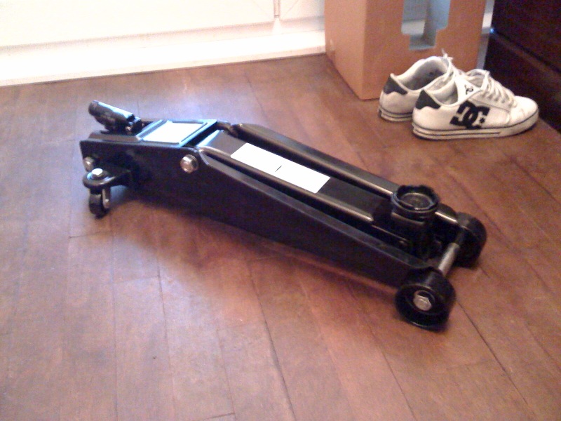

got my mum to pick up a new jack for me while she was out.
Its a halfords speed lift 2.25tonne jack, seems better than my old ones although a little heavy when lifting the car, i was a bit concerned it wouldnt go under my sideskirts but it just about did with a little push.

Stopped in to Pirtek today to get some help with fitting my replacement oil pressure sensor so i can fit the guage i bought awhile back, i was told the sensor supplied had a silly imperial size thread on it and wouldnt go into anything properly as they only supplied metric.
i bought all the bits and the closest size metric adaptor which allowed me to simply wind it in and slightly cross the threads, the pitch different is so small its just adjusted them a little really.
the hose is to allow room for it to bend around a bracket on the back of the engine block that would otherwise be in the way, in total this cost £21.71
