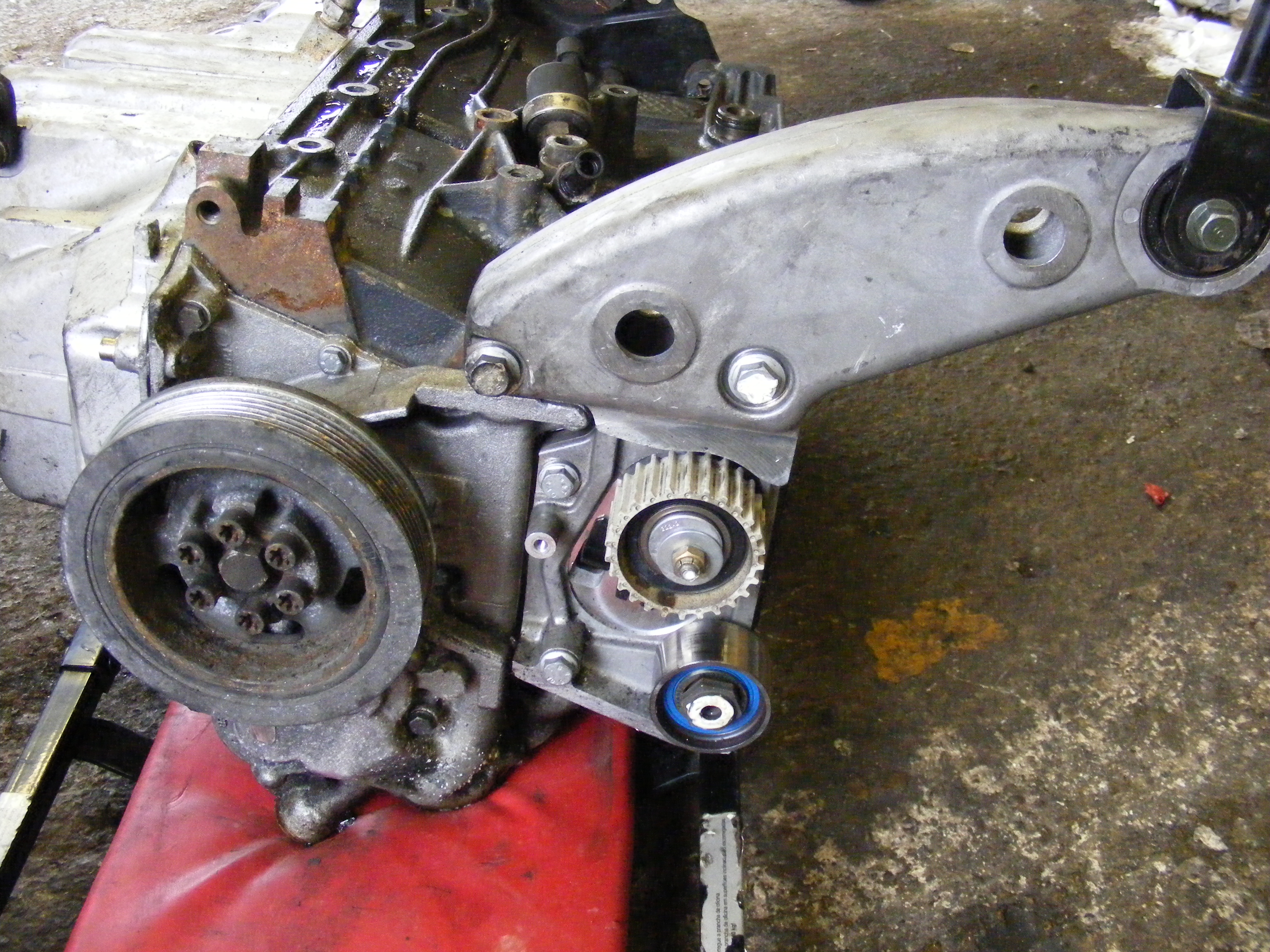

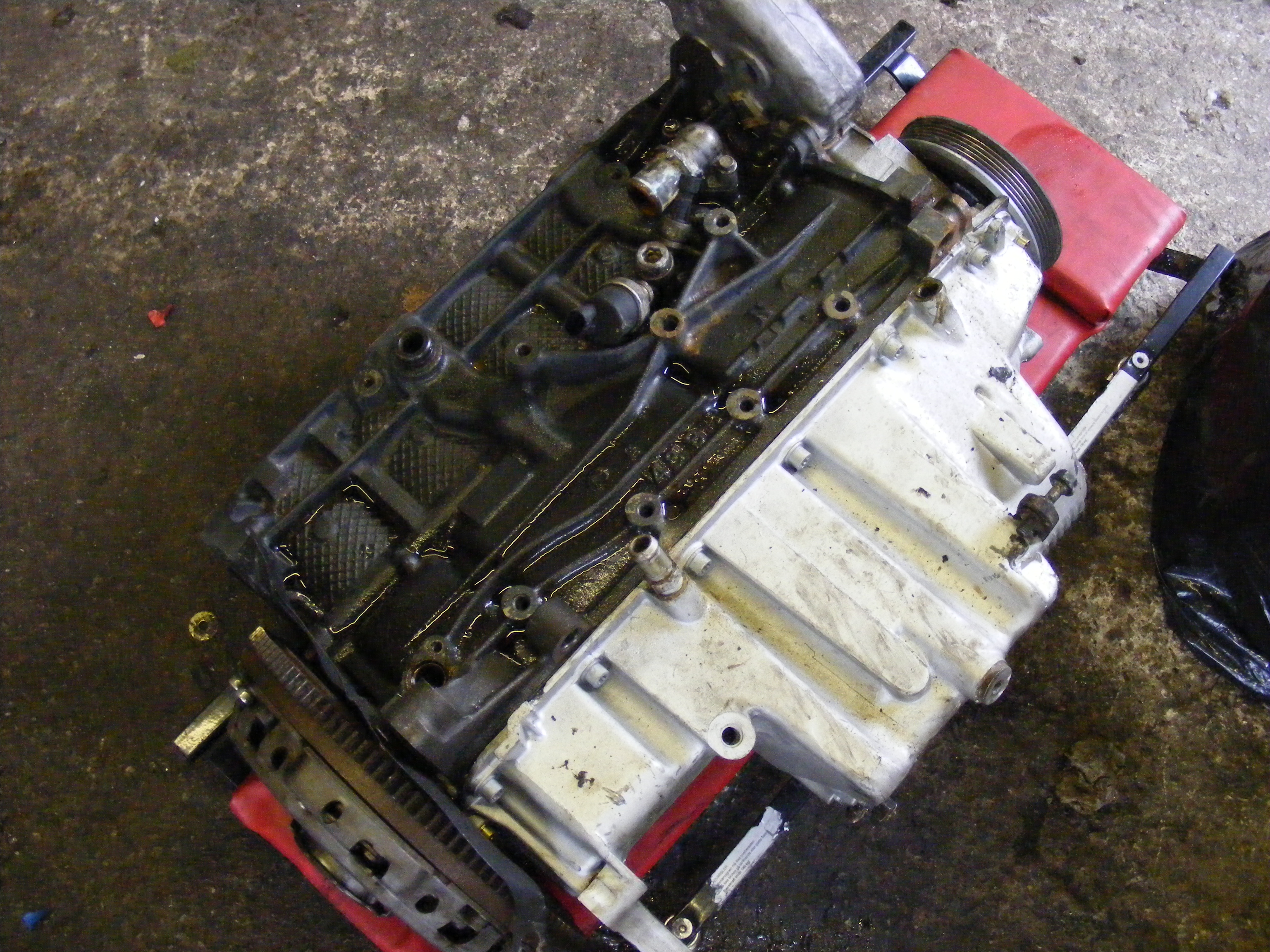

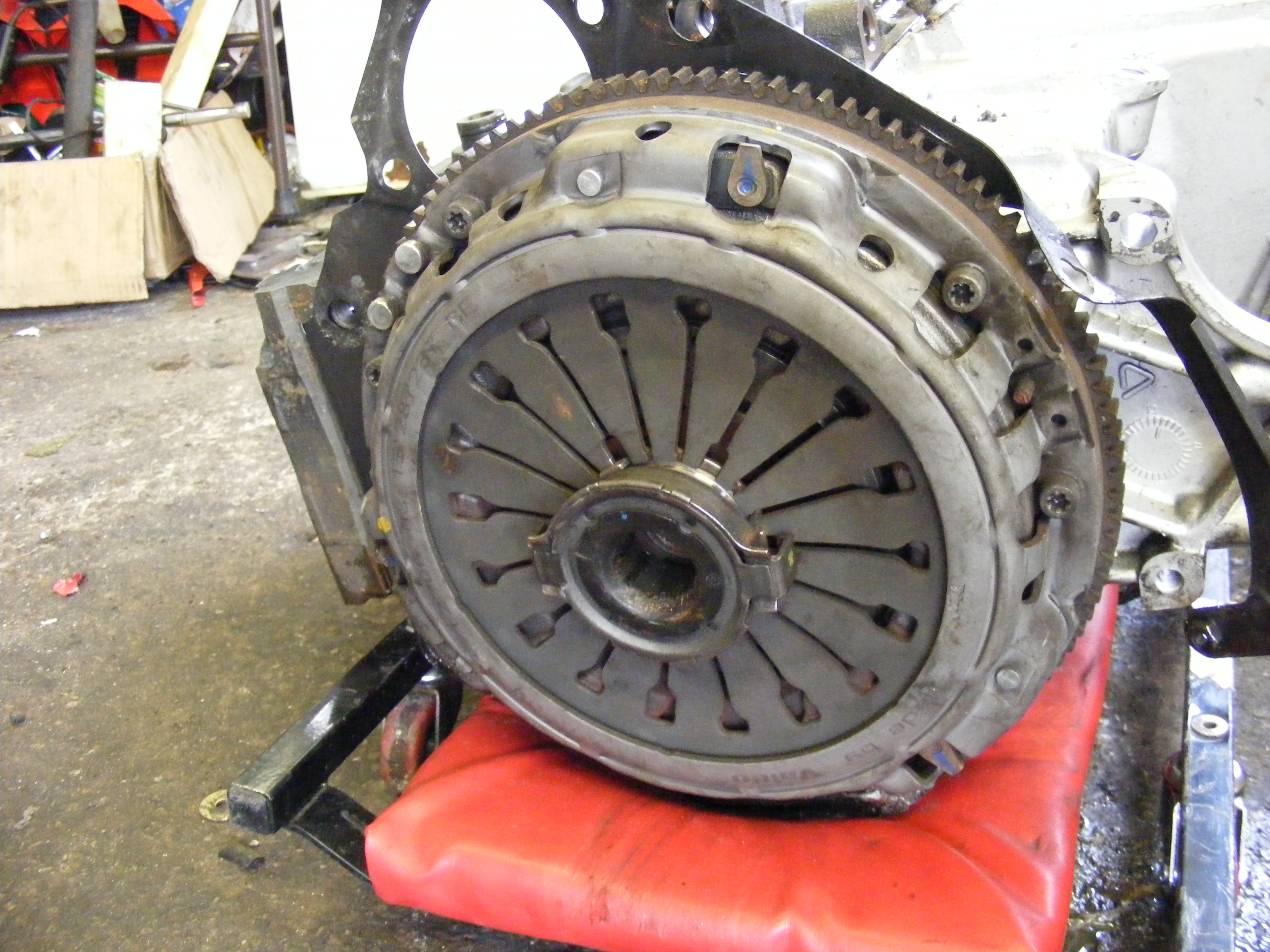

saturday i took a trip up to Stoke on trent to collect a new block and pistons, came off a 47k coop and looks in excellent condition, so i did a little work on the car and here she stands now almost ready for the engine to come out.
i just need to remove gearbox linkages and the slave cylinder then its droppy enginey time :D
once its out i need to strip it down and get the crank out, order up the new shells (apparently there are 3 types so i cant order until the crank is off to identify which i need) along with new bolts.
once this arrives its off to the machine shop to be balenced and then back to me for final assembly, i still need to re-assemble the cylinder head so will fo that in the mean time.

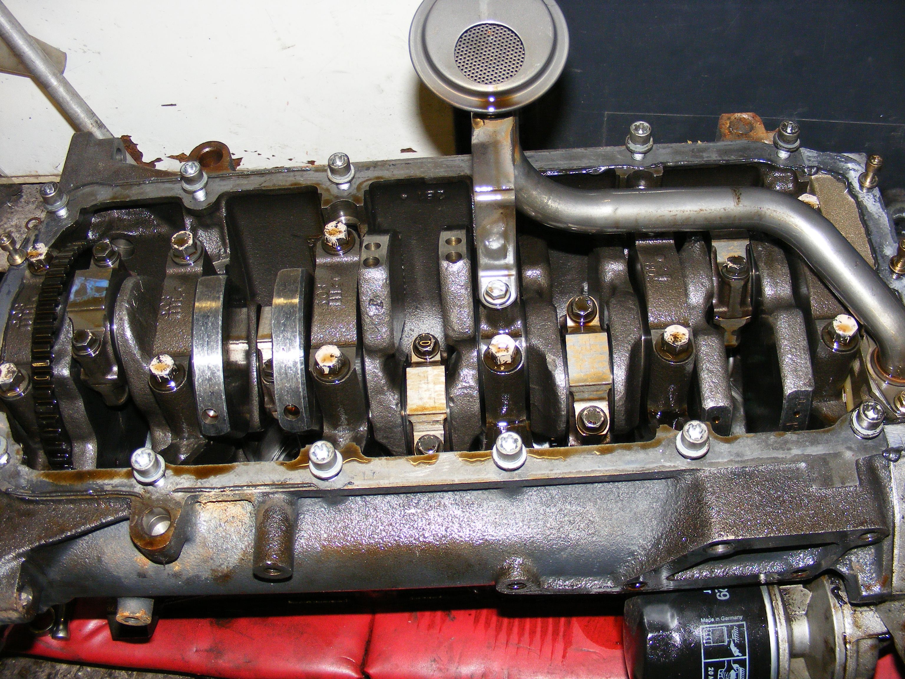

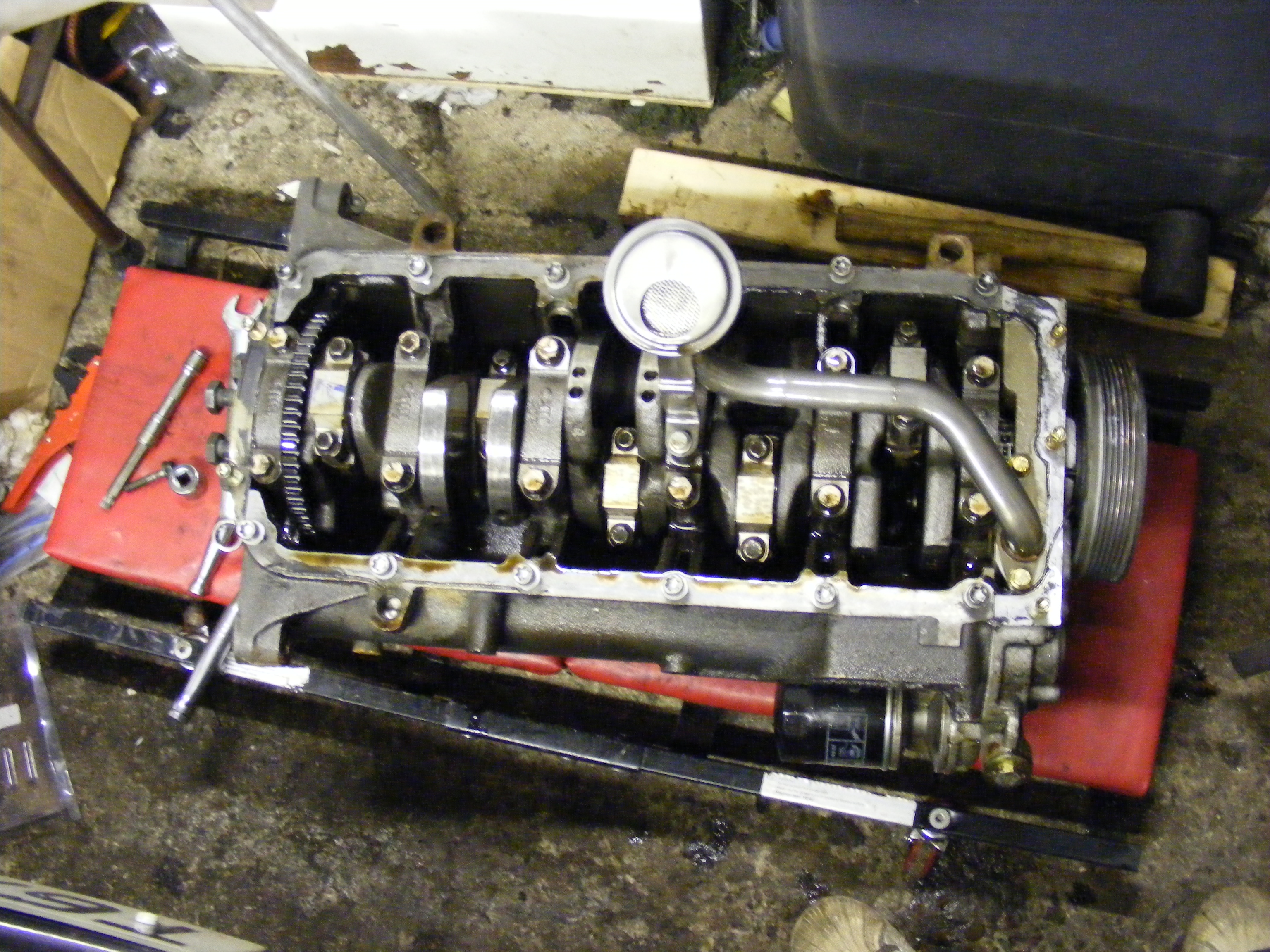

Okay, tonight i re-assembled the bottom end.
went well, first i changed all the bolts and torqued it all down.
then i fitted the oil pump and feed back on
applyed the sealent for the sump
and fitted sump and torqued it down :)
looks dirty, i think i have some more cleaning to do and some Autosol'ing 8)
i need to source a gasket seal for the crank on the oil pump end but i cant find it on the ePer so will have to phone around.
i was hoping to get the cylinder head bolted on tonight but by the time this was done it was 10:00pm :shock:

well, here we go again!
Picked up my new bottom end this morning
as you can see from the pictures it has been recently rebuilt, infact its not even finished bedding in the bores and the honing marks are still clear as day!
i'm pretty impressed with myself finding this one, was even quite close to me and i really look forward to fitting it!
she will live once again :cool:
Ry :D
Wow that does look good :D
Are you going to strip it and check everything or just fit it?
Good luck Ry (y)
Once bitten, twice shy.
Trust no one Ry, check it over and make sure oil pump is OK and oilways/waterways are clear mate.
Also check how much turning force is required to turn it over using a torque wrench mate.
Good luck
i'm just going to fit it, it looks pretty decent from the ouside so not really worth the hassle just to check the shells out.
if this one breaks i'm giving up lol
Ry
Mate just give the once over, you'll be kicking yourselve if it goes again.
It's not going to be too much while its out on the floor, make sure no crap has got in where it shouldn't be and just take the sump off for a visual inspection, whats a few gaskets at this stage.
When you put the head back just do a quick compression test prior final assembly and install.

i'm sure you'll be glad to hear i've put my money worries aside and will be replacing the big ends after all.
i removed the sump tonight and still cant get it out of my head that this looks like a new engine rather than a rebuild
Ry :)
