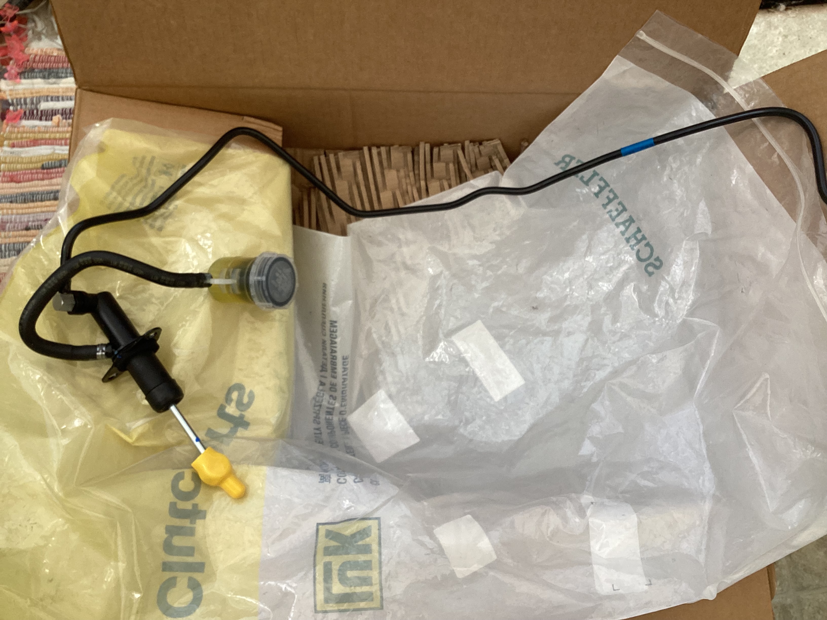

erm, help pls?

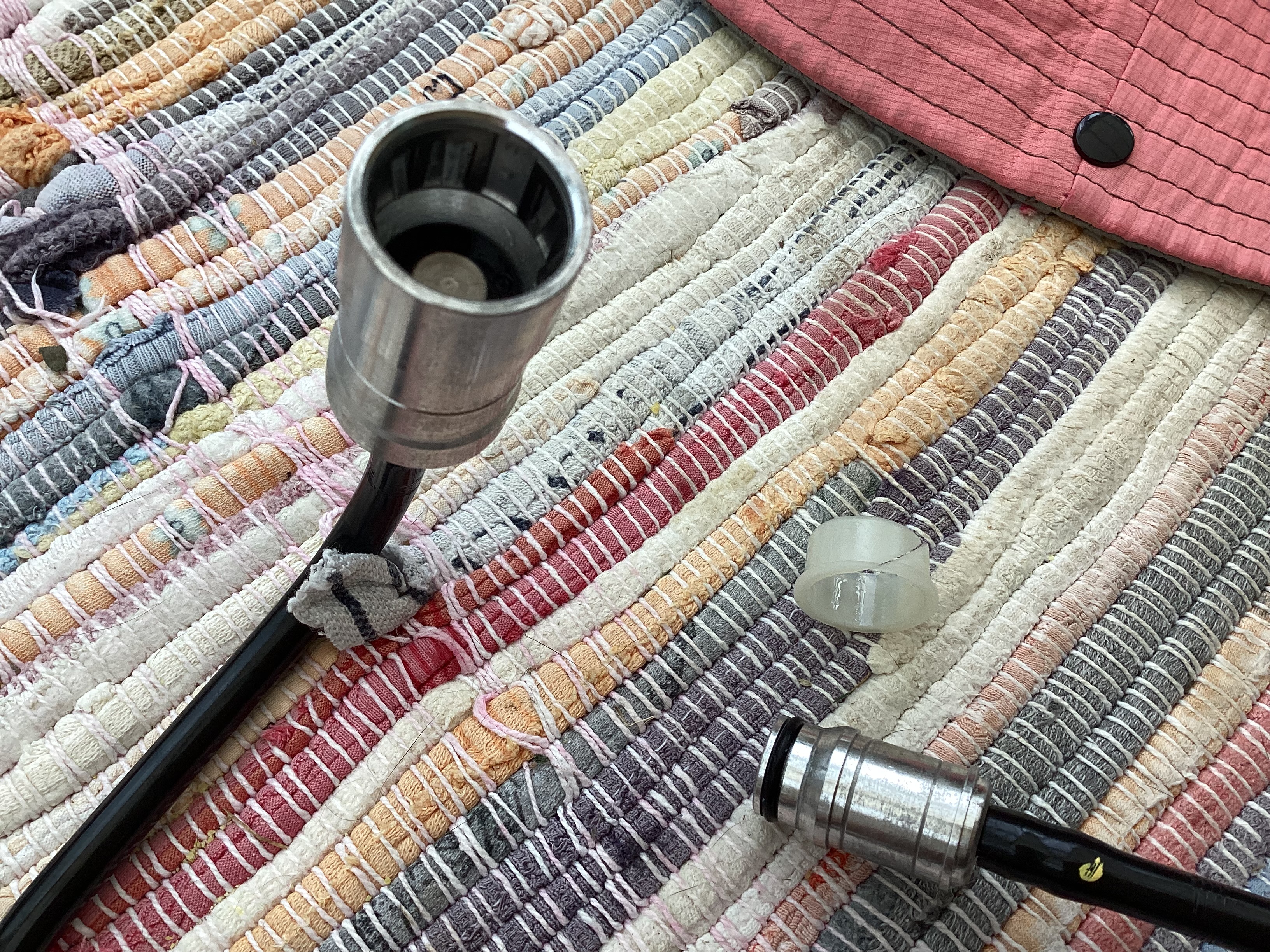

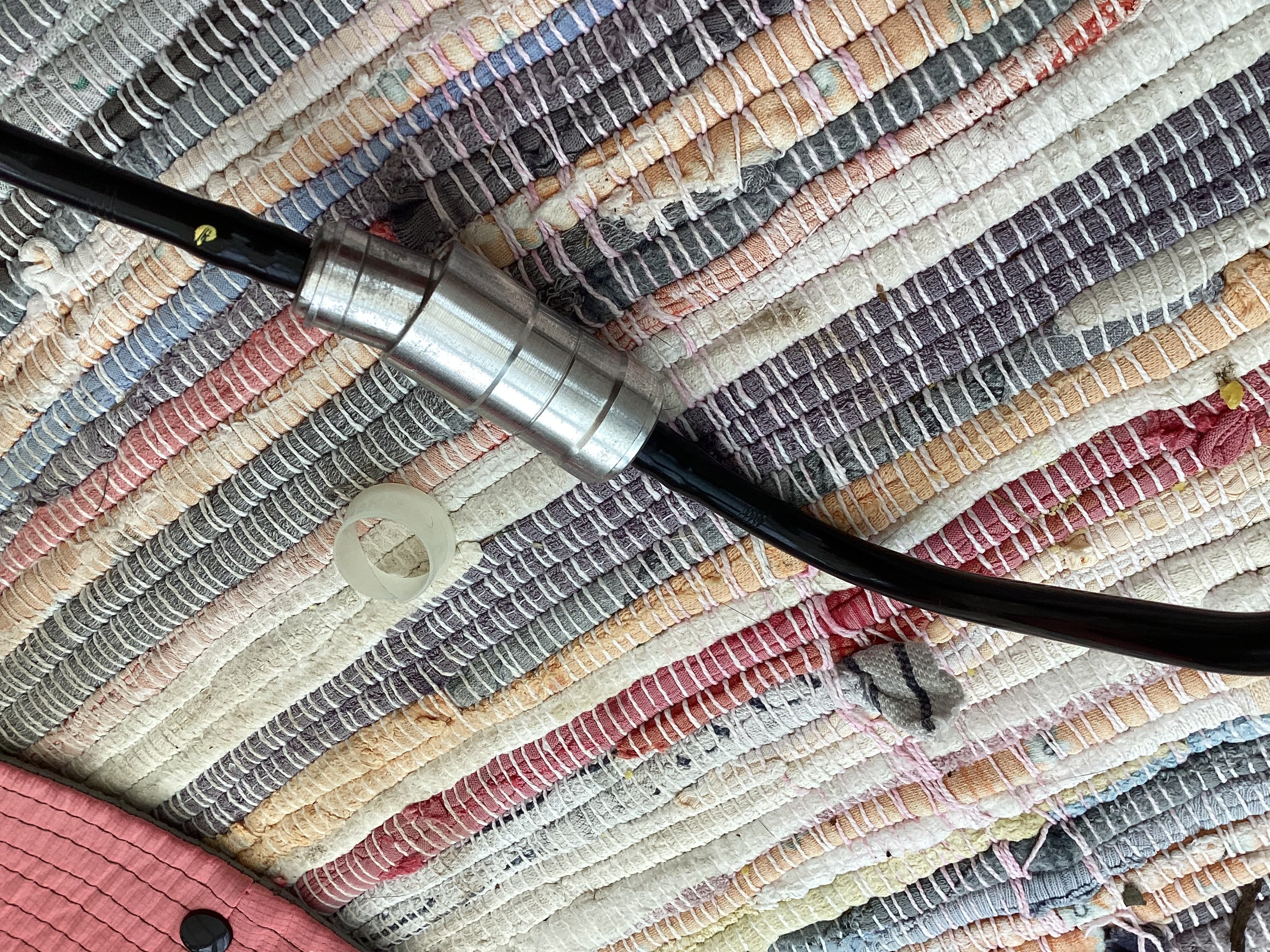

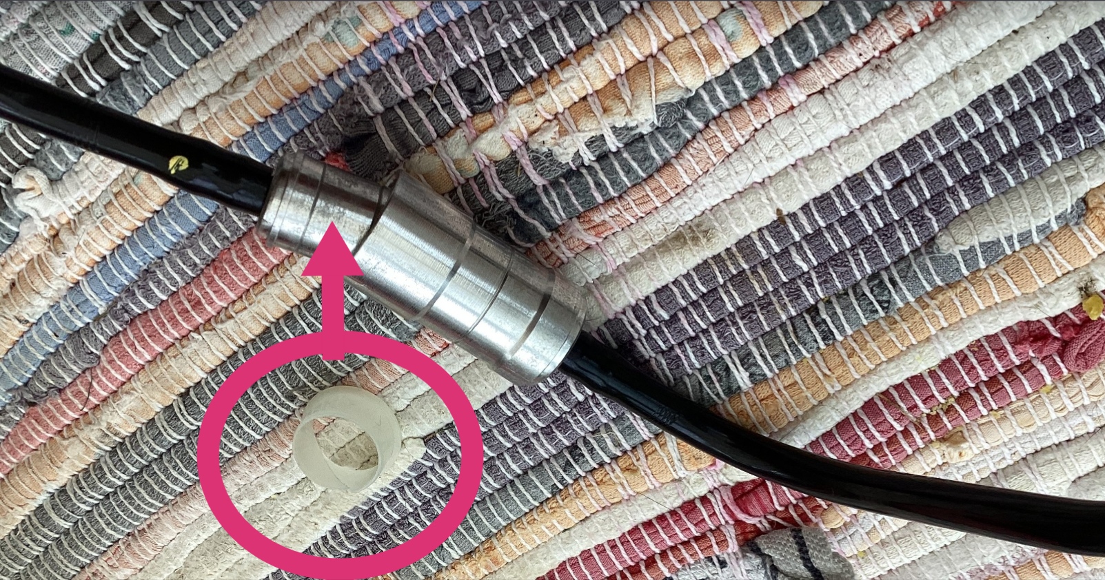

i thought id see how they go together, before I do it...erm? they dont stay together? What am I doing wrong pls, ty.

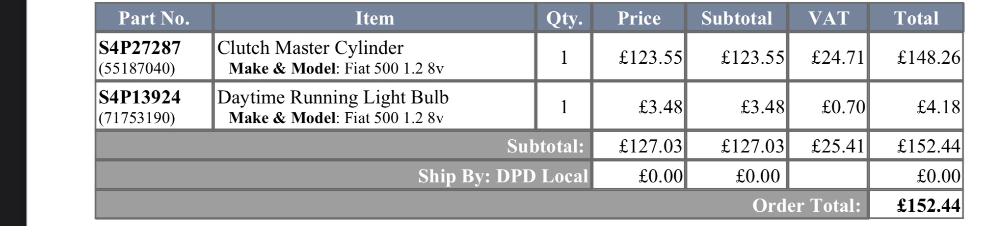

edit: heres i what i ordered, and what they sent. did they send the wrong thing, or am i doing something wrong? ty.
The numbers are different, and it says panda, but i know some panda parts are the same. so i wanna know before i call on monday.
Edit: i googled the part number, and its meant to be right, so why doesnt it fit? Do i need another part pls?

Should this nylon collar not be on the male part?
thankyou so much. I tried it with it on, and it still fell out. 😭😭😭

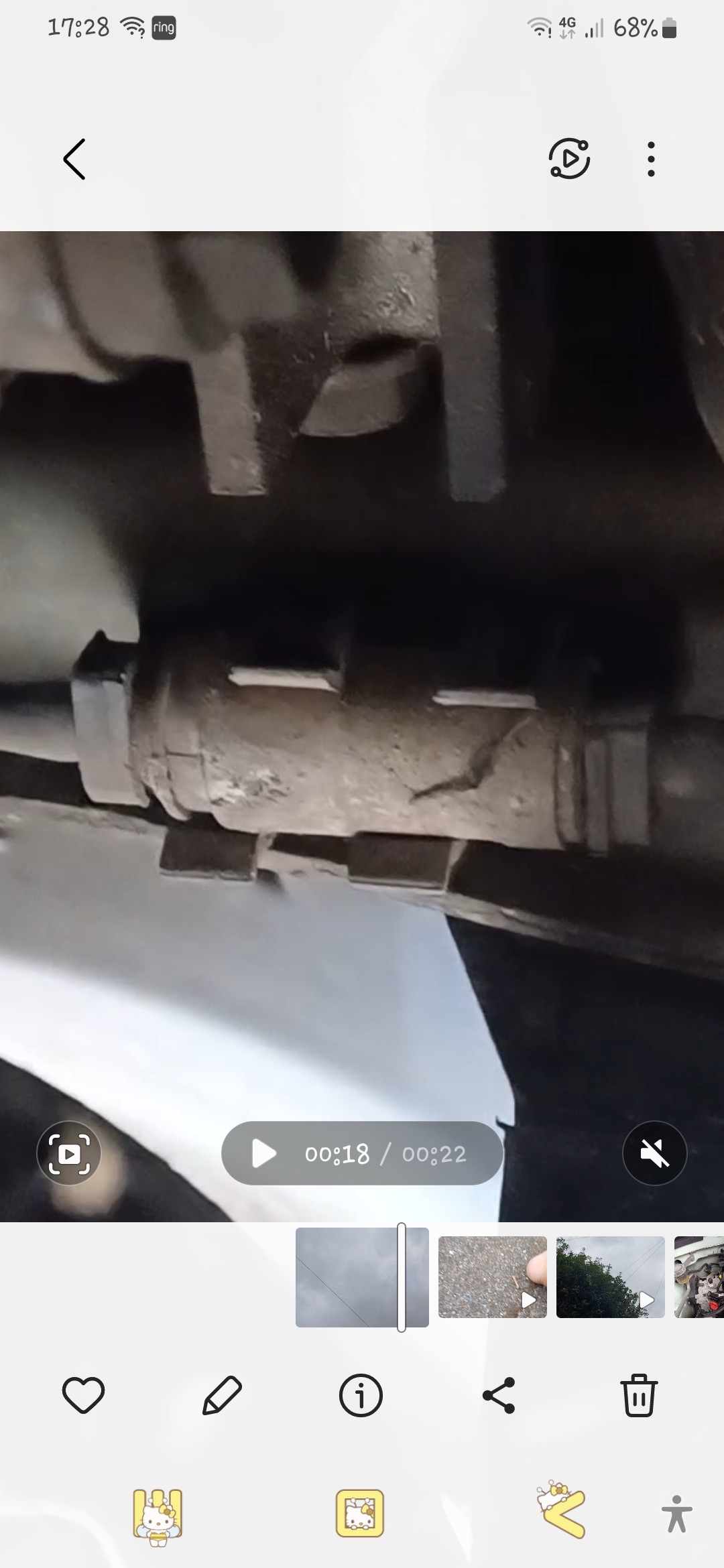

edit: i went under the car, and heres my connector. 🧐
Well, looks dry at least.
Here's someone else had the same issue trying to attach the two halves of a new QD connector:
@John202020 suggested quite some force is needed to force the two together :/
omg ure amazing, tysm. idk it seems like one bits too small? but on the pic in that thread they have that cream plastic bit on it.
im not sure how to force it in, like force it to where? Australia? 😩
Yeah, i was happy it looked dry. I guess tomorrow I will try and change the master, and leave the pipes alone, and do them another day when im 100% theyre the right bits.
