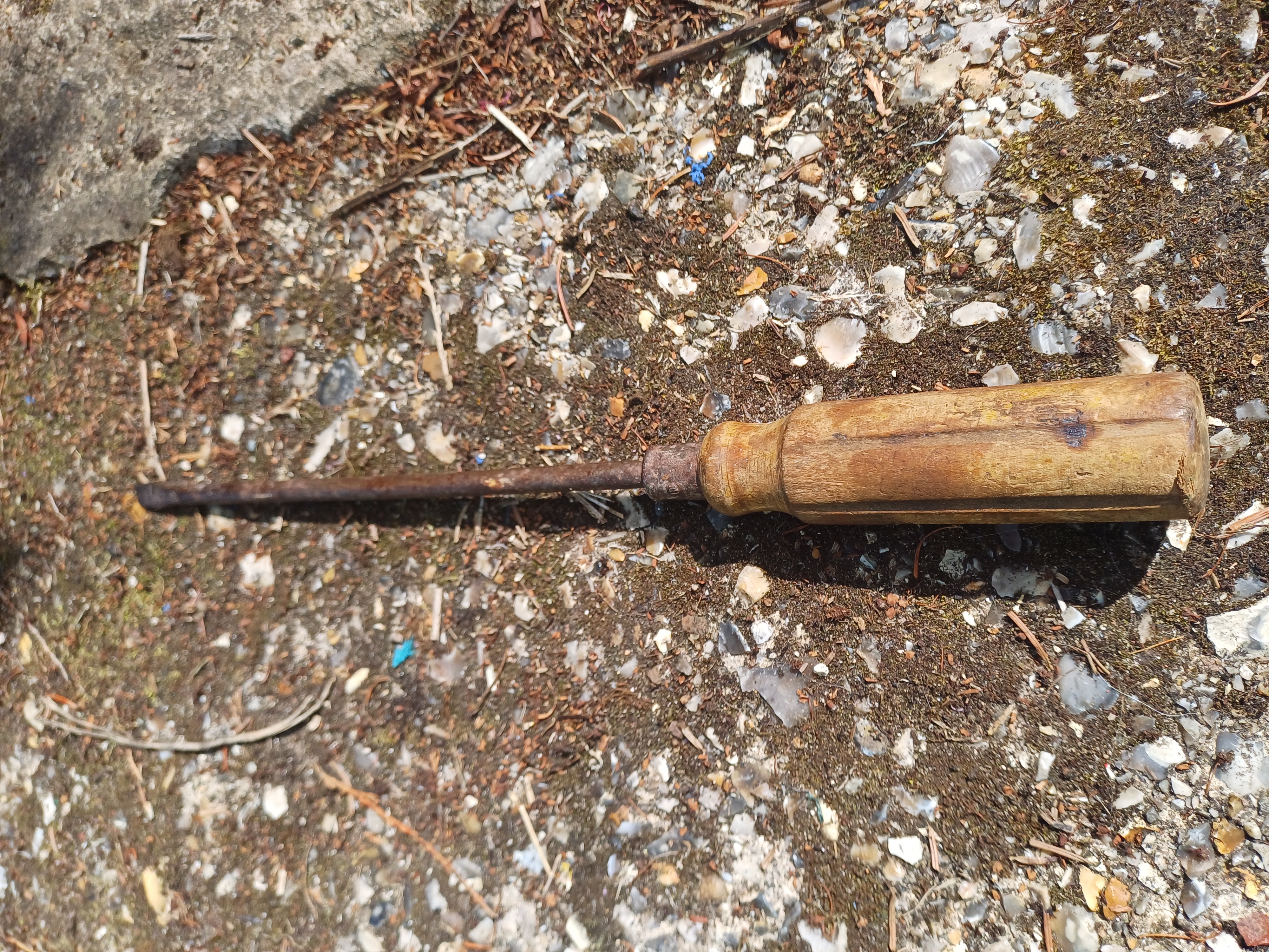

soooo, turns out my Dad had a massive one. Blimey. See pic 1. Sadly, I wasnt used to wiggling things into place, and after ten minites, rage quit.

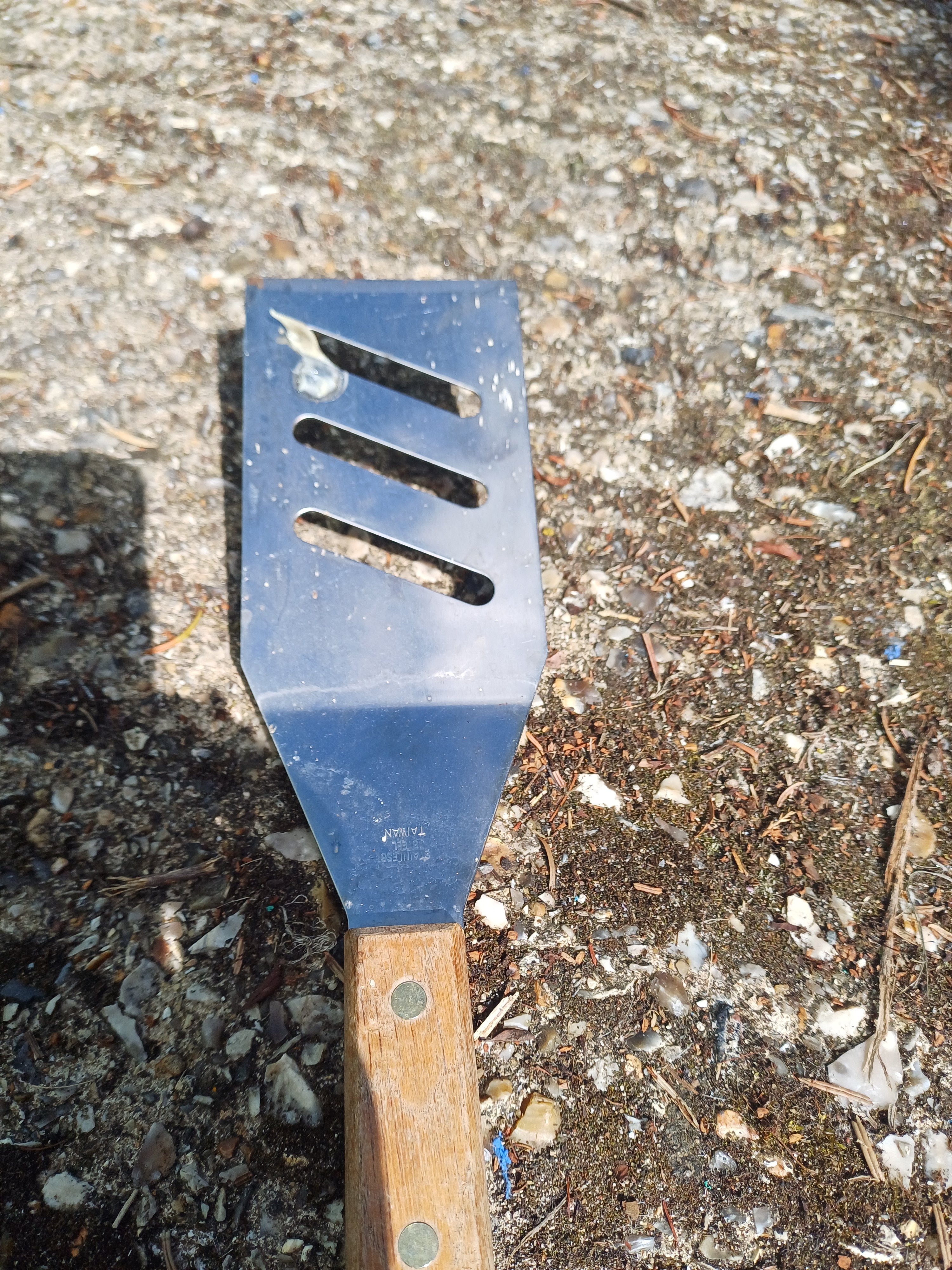

i went looking for something wider, and BEHOLD, a choir of angels sang as i laid eyes on the bbq burger flipping spatula thing. so i swear, i put it in the gap, was getting the torch, and heard a click. THE POWER OF THE BBQ TOOL WAS SO GREAT IT LEPT INTO PLACE FROM SHEER TERROR ALONE.
i then got over confident itd be done in 10 mins. so yeah.
