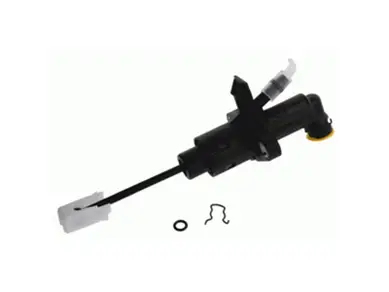

Do you happen to have a tip for getting the pedal onto the new master cylinder. I cant get the balljoint back together. Tried allsorts. Thinking there must be a knack, I clearly dont have. Thankyou!
Is it something like this design I had to fit on my daughters VW Golf, a right pain. The idea is the white plastic clip stays on the master cylinder as it engages in the pedal and two ears pop out to lock it into place, if it is that sort.
I'm trying hard to remember what it's like. I seem to remember it's rather more like the ball connector on the gearchange cables? it presses on from the side if I remember - been some time since I did one, but I seem to remember my biggest longest thickest screwdriver came into it somewhere - being used as a lever? Or am I thinking of another one. It's not like the VAG one, I don't think?
This was on daughter's 2010 VW Golf Plus 1.6 diesel with plastic pedals and clutch cylinders. The ball end rod going into the master cylinder had that plastic piece that swiveled on the ball but engaged into the plastic pedal, locked into place by two ears in the white bit.
ty, no. i cant get a pic now, as its dark. but the clutch pedal has a ball on it, on the side, and theres a plastic cup on the rod thing from the master cylinder. it swivels, and its meant to go on it. I just cant get enough force. ive tried various pliers, a hammer and screwdriver as leverage, those wrench things that you can lock into size, idk, i think theyre mol grips, but im not sure. anyway, i dont have the strength in my hands, and theres no room to be able to hammer it on.

yeah, the ball is on the pedal, the socket on the rod from the master cylinder. I got it off with a screwdriver as leverage, but theres no room to get it back on, and my hands arent strong enough to force it back on. ive tried the entire toolbox, and all the swears. 😭

A photo will help , but looking at a pedal assembly on eBay, if it is the same one it appears the ball fitting on the pedal is at right angles to the pedal press down position , so I see what you mean about getting enough force to push sideways in a limited space in foot well.
The only thing I can suggest is a bit of suitable grease in the cup and on the ball, then whatever leverage you have to push them together and then with your third hand??? Possible operate the pedal a little as it may ease engagement onto the cup.

Another thing is I have several different size mole grips and if you have a suitable one to get in there, adjust it so it is only just pushing the two parts together, then wriggle the pedal and gently increase the tension on the mole grips by the adjuster screw at the same time to progressively encourage the two parts to mate. It does need doing gently as you do not want to damage the plastic cup.
I've just popped mine back on
Using a long screwdriver to lever it on against the steering column
Had to push the pedal down a little
And a blob of grease in the cup probably helps

omg ure an actual angel! i was gonna try wedging a piece of wood beside that thing, as i was worried about breaking it. i wasnt sure what it was. i was gonna make the bit of wood take the force. i now know its a steering column lol. thankyou so so much.
