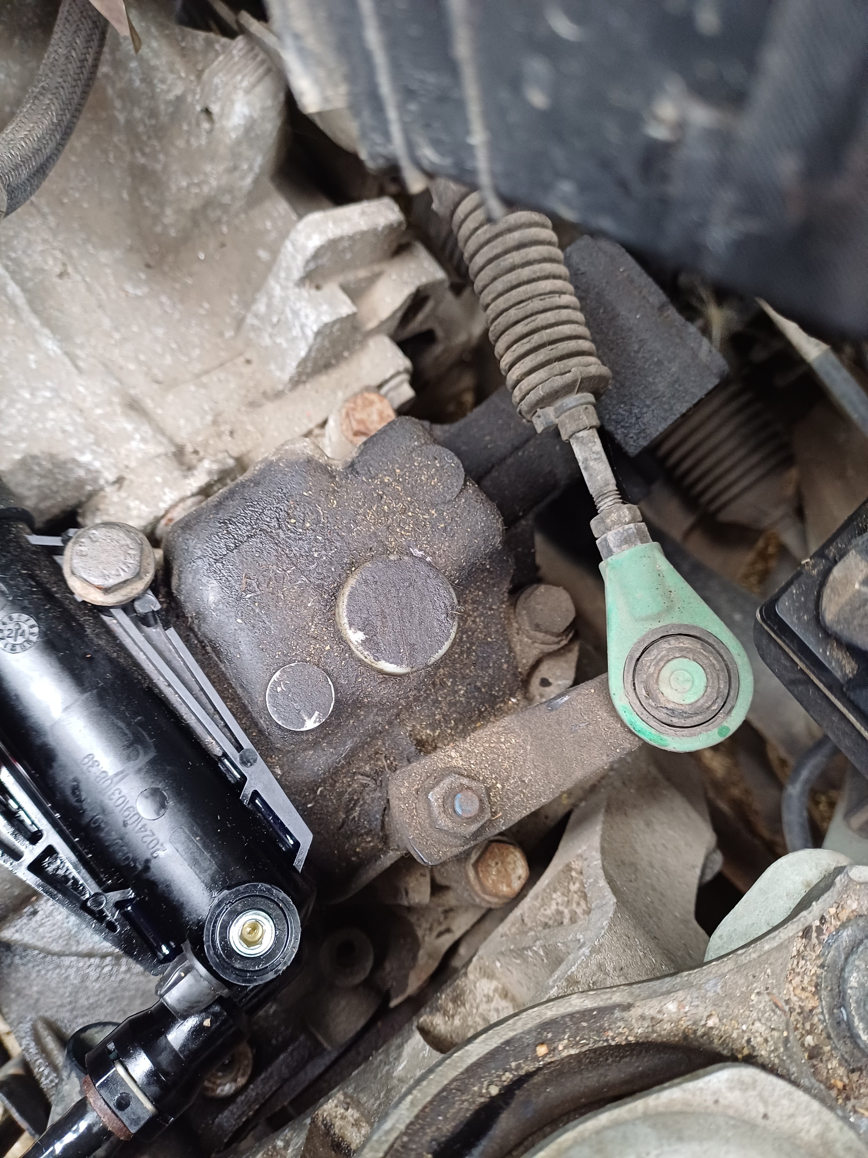

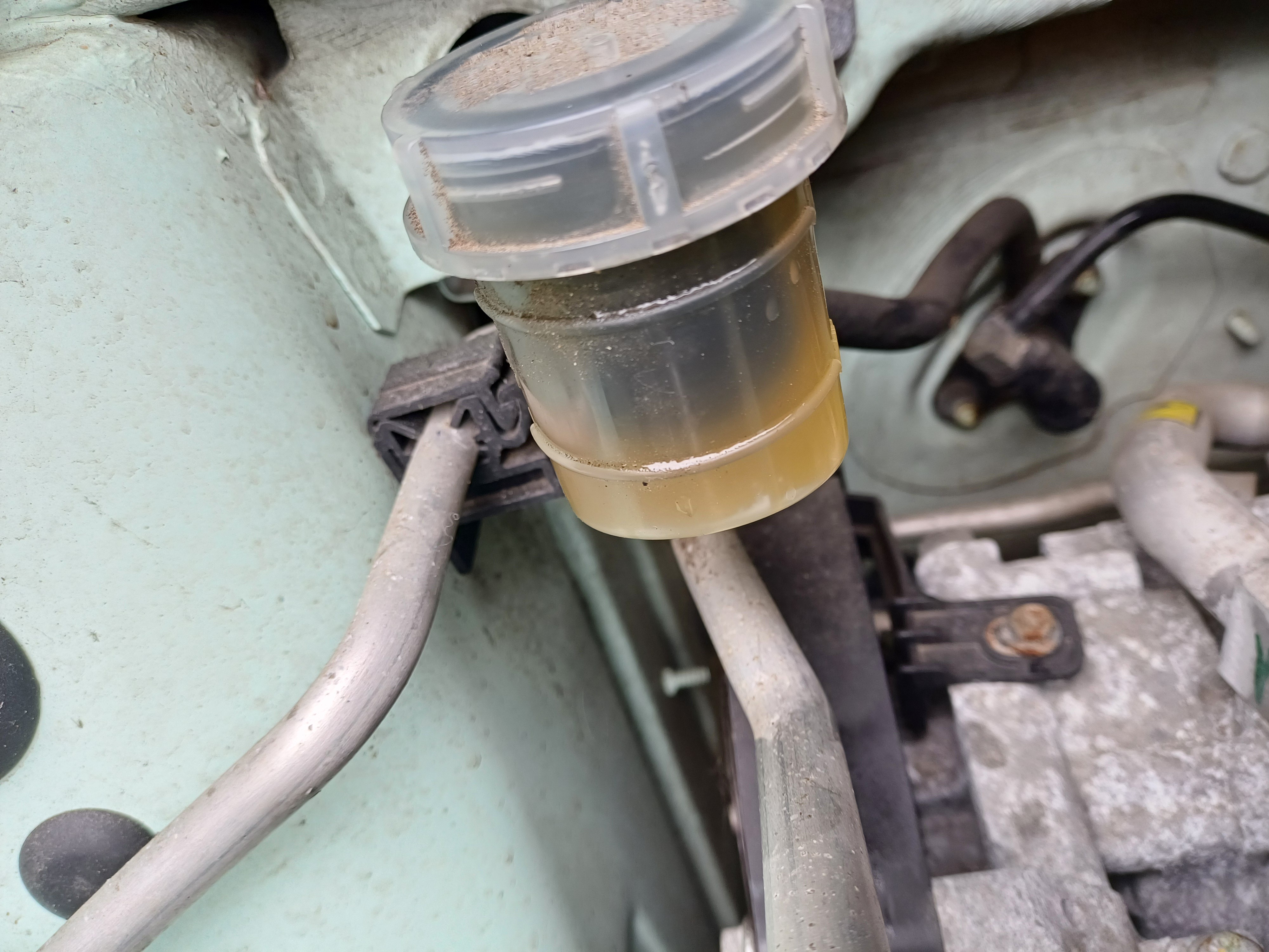

4. Here is a pic of that cap thing, does it look ok?
5. Next to it there is a cap that wobbles like crazy. Is that meant to be loose like that?

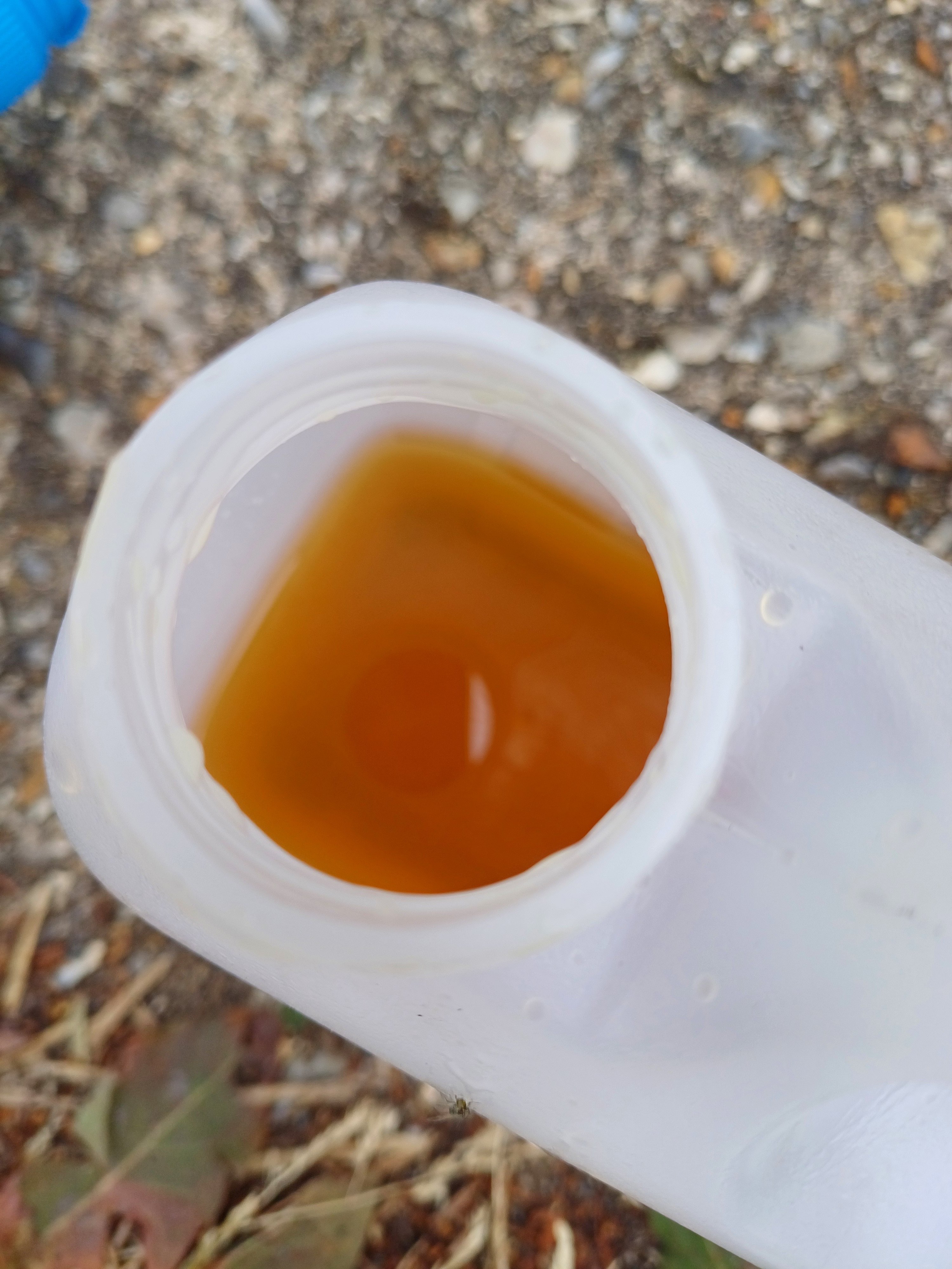

The dark fluid is the one i bled, in comparison to the new fluid. Granted there's less in the lil reservoir thing, but its still lighter.

4. Reservoir can't tell us if there's any air in the system, it's only to check the level.

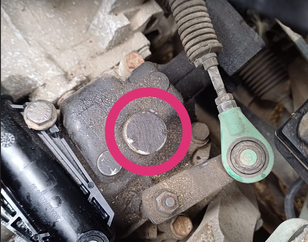

5. This wobbly cap?
That's the plastic cover of the gearbox breather. Leave well alone, it's fine if it's loose :)
5. This wobbly cap?
