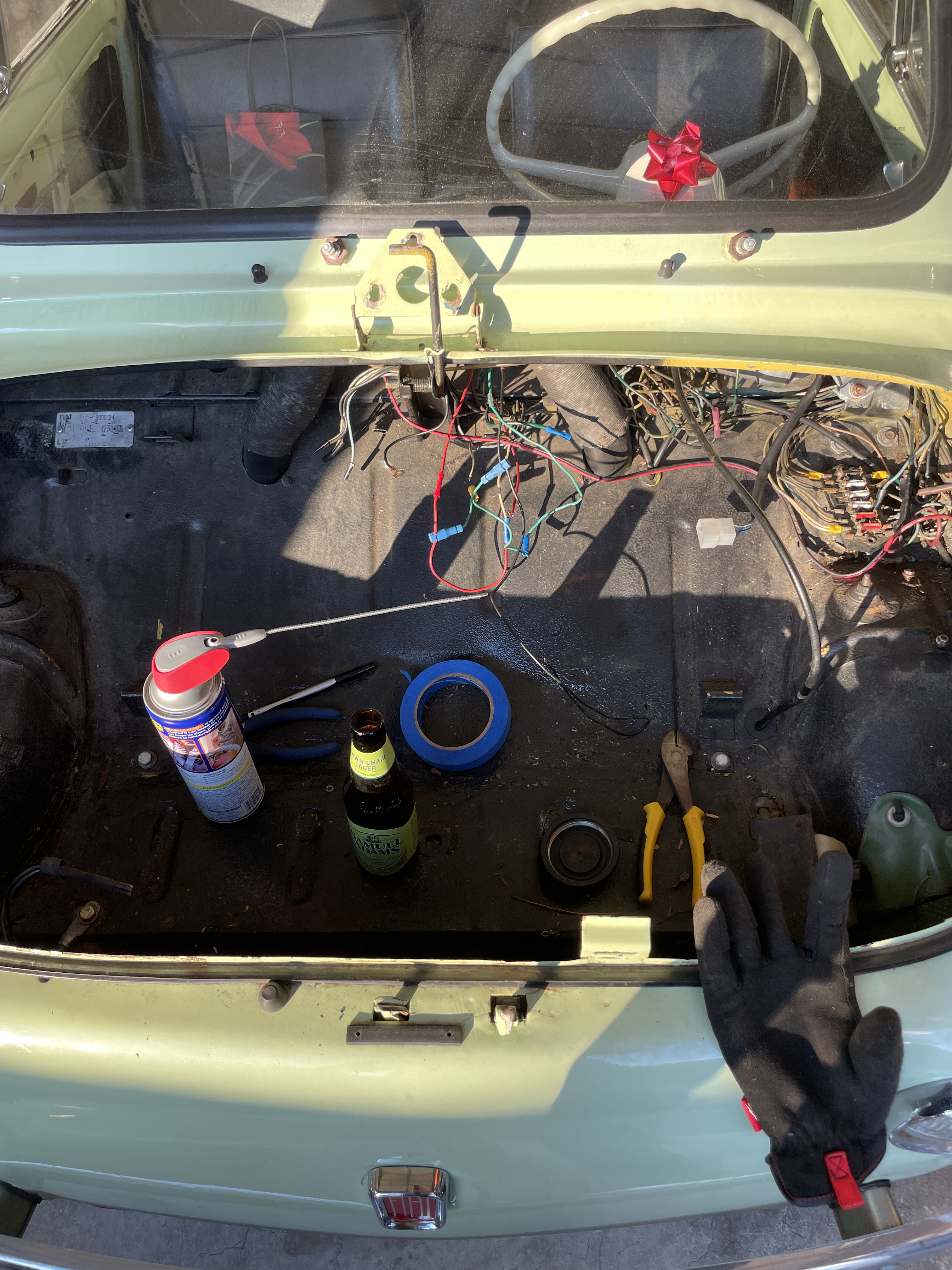

The wiring is also quite a mess, with lots of splices and things not working as they should. I ordered a new loom and will be rewiring the whole car.

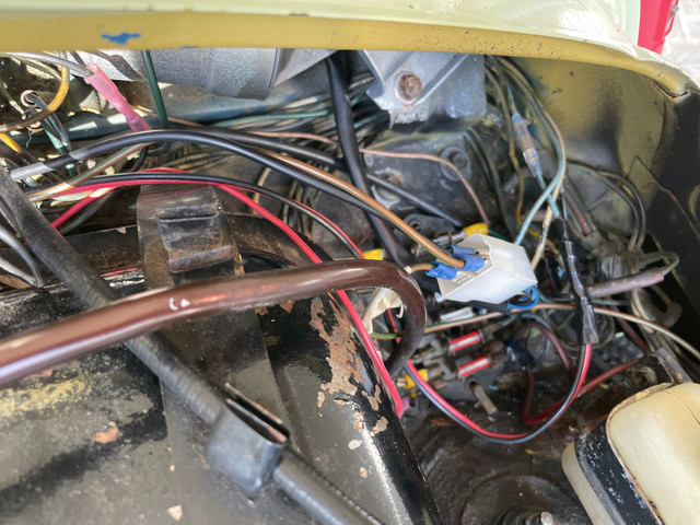

Electronic Ignition. If anyone can give pointers on how this needs to be wired into the loom, it would be greatly appreciated.

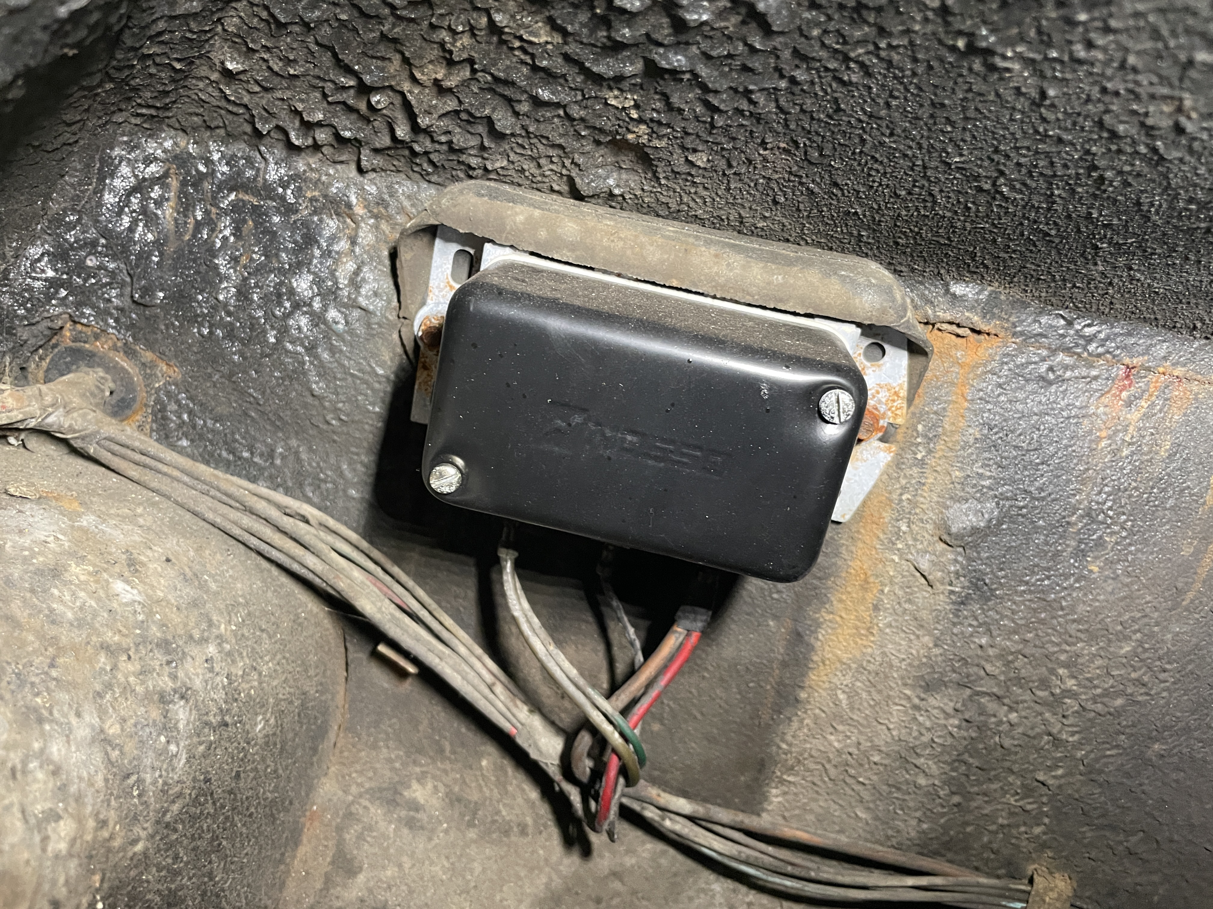

Can anyone tell me what this is? Voltage Regulator?

Is this something that should be replaced? It looks larger than the stock ones. Maybe something to do with the electronic ignition?
It's a Nosso-brand voltage regulator. They make replacement VRs for a ton of different makes. You can probably test it the same way you can the OEM one. There's a thread on here somewhere about it. It shouldn't have any bearing on the electronic ignition, but may be the fault in your dynamo not working analysis.
As for the ignition... does that have 3 wires (Red, Black, Blue) or 4 (..and yellow)? Several forum members have that style 123ignition, so they should be able to chime in. I had the 2-wire style with a traditional distributor cap, so I can't speak to the extra wire(s).

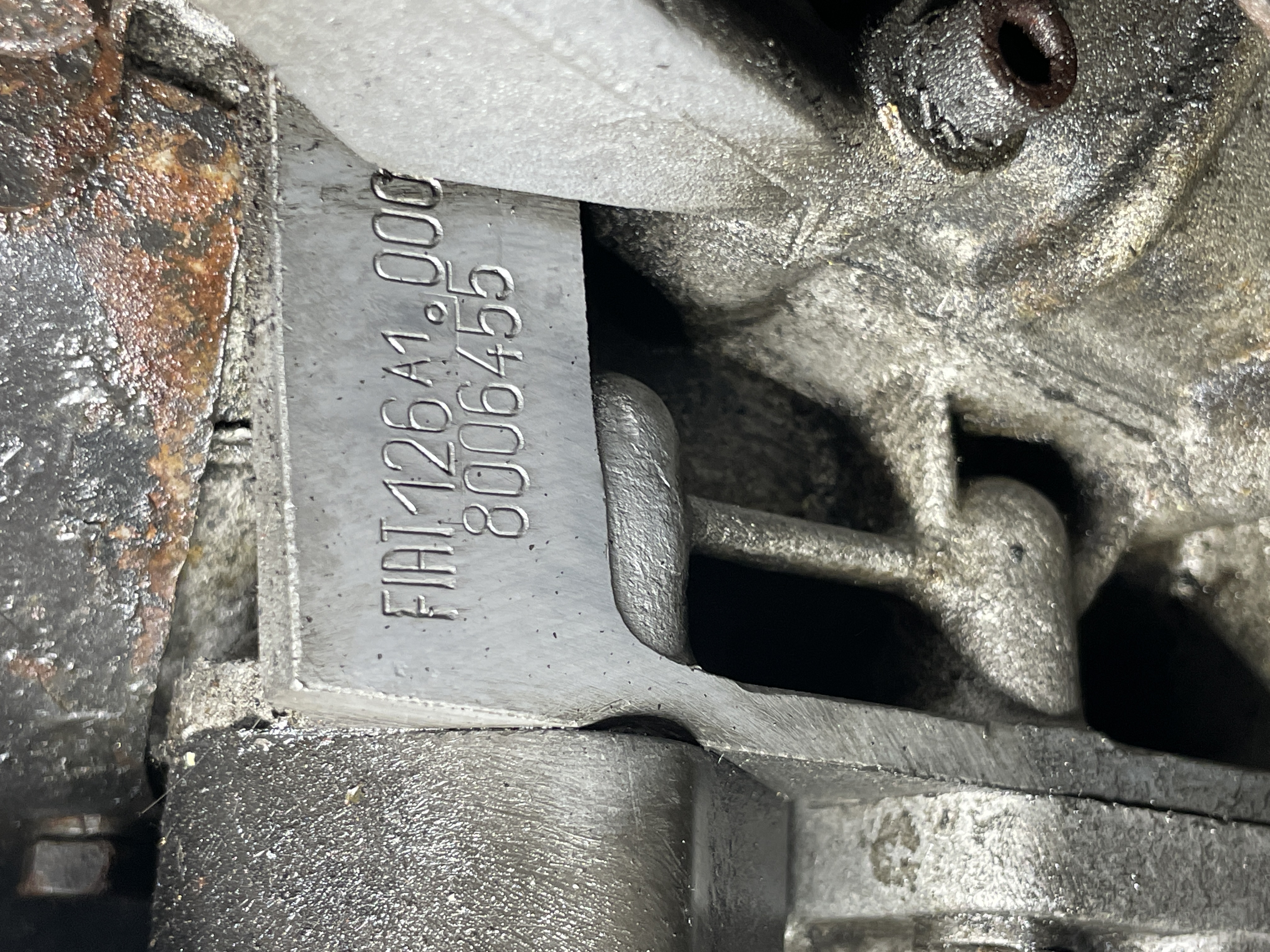

126A1 denotes that it IS a 652cc engine Ryan----8006455 is the ACTUAL engine number. Both my '650'engine have engine numbers in the late 46,000 and early 47,000 so your engine could possible be quite a late engine.
