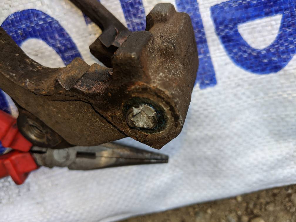

Get a blow torch on it till it gets red hot or as hot as you can get it then drop it in a bucket of water. Repeat at least 5 times.Dropped a bit of a clanger.....
The slider pin was ridiculously tight all the way and the very end snapped off in the carrier for some reason. Typical!!!
Any ideas?
Due to get new tyres Thursday, so need to sort it tomorrow!View attachment 210117
