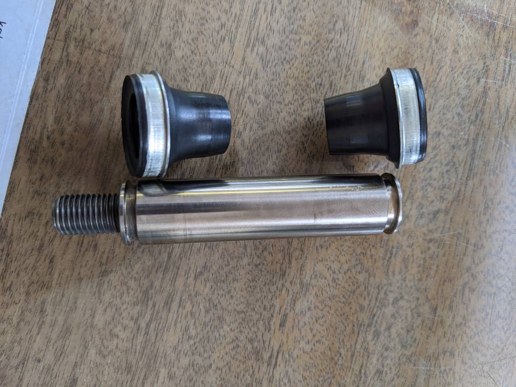

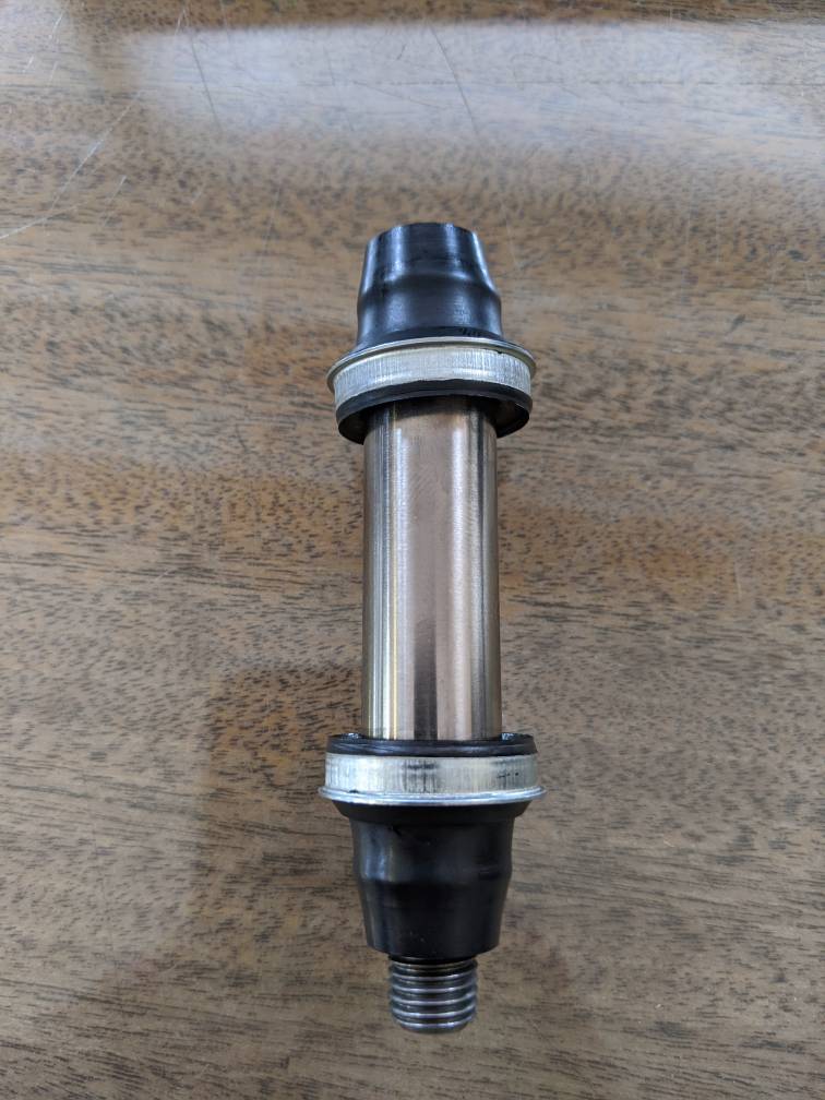

What I was going to ask, the new slider comes with 2 identical boots. Given the old caliper slider didn't come off properly, what way do the new boots go on?

Do the boots go on like picture 1 or 2? IMG_20200617_134632.jpegIMG_20200617_134659.jpeg
