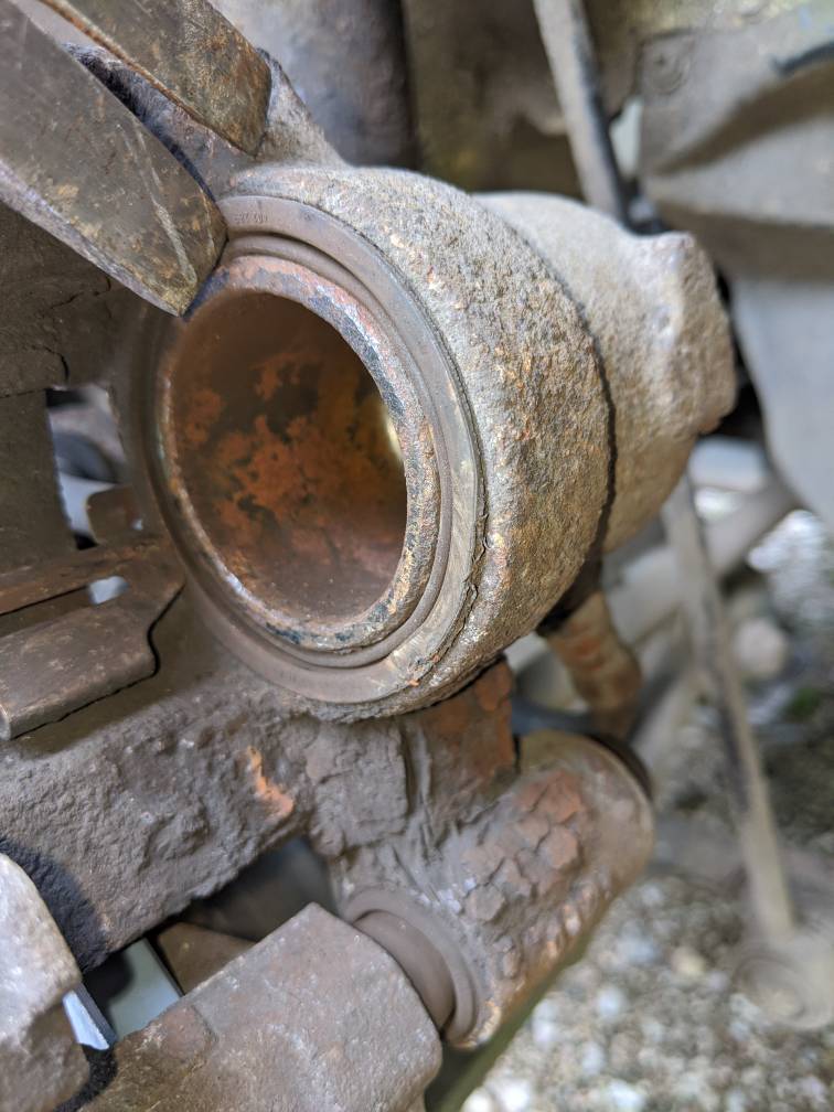

Also, the seal around the piston has a tear on one side, I suspect didn't help when I used the g-clamp to retract it.
Does this need sorting asap? If so, is a rebuild kit the easiest option?
Edit - and if yes to rebuild, do I just get a seal kit and use the same piston?
The hydraulic seal is a square section O ring (like a piston ring) inside the cylinder. You have a damaged dust seal which will lead to internal corrosion.
Looking at the state of it, I would get an exchange rebuilt caliper. Pair actually as the other side wont be much better. Also check the brake hoses for perished rubber.
When pushing pistons back, open the bleed nipple with a drain tube. It's easier to push and blows the old oil out of the caliper. Top up the master reservoir as needed.
Looking at the state of it, I would get a rebuilt caliper. Pair actually as the other side wont be much better. Also check the brake hoses for perished rubber.
Do I really need to get a rebuilt caliper, or can I just get the rebuild kit and do it myself? It doesn't look particular difficult to fit new seals + piston.
