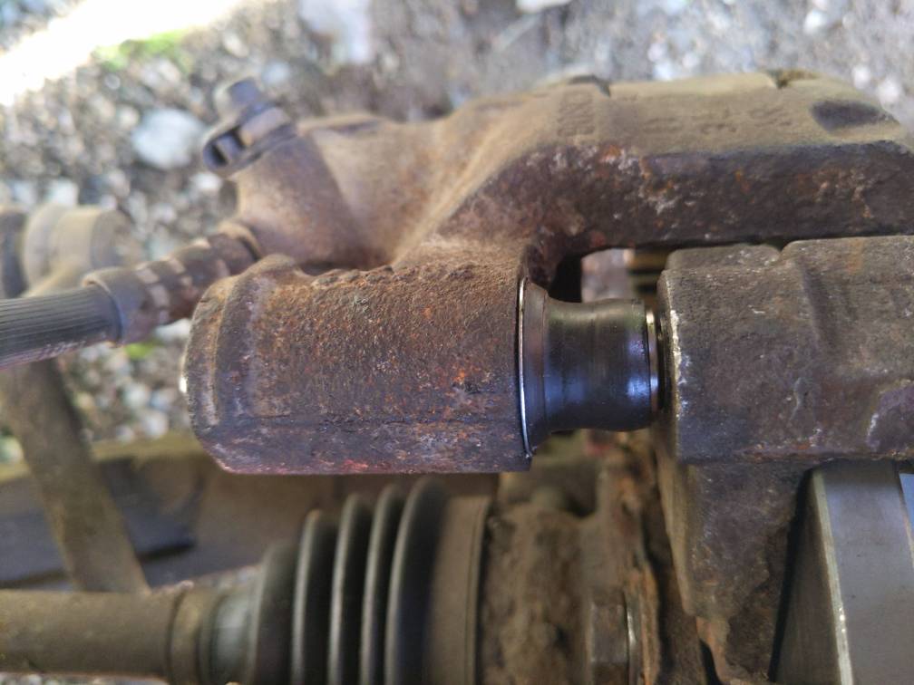

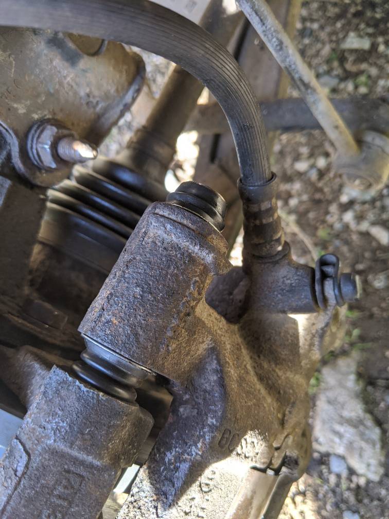

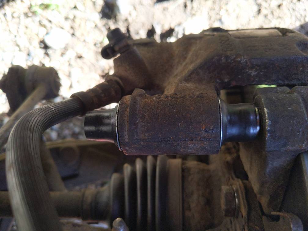

Is this correct? The boot seems to scrunch up a lot as the slider moves... I put the one closest to the carrier on, threaded the pin in and then popped the outer boot on. Image%20(5).jpegImage%20(6).jpeg
The slider hasnt got enough movement to get the caliper over the pads even when it's fully retracted?
Update - managed to get it all back on.

Looks perfect.
