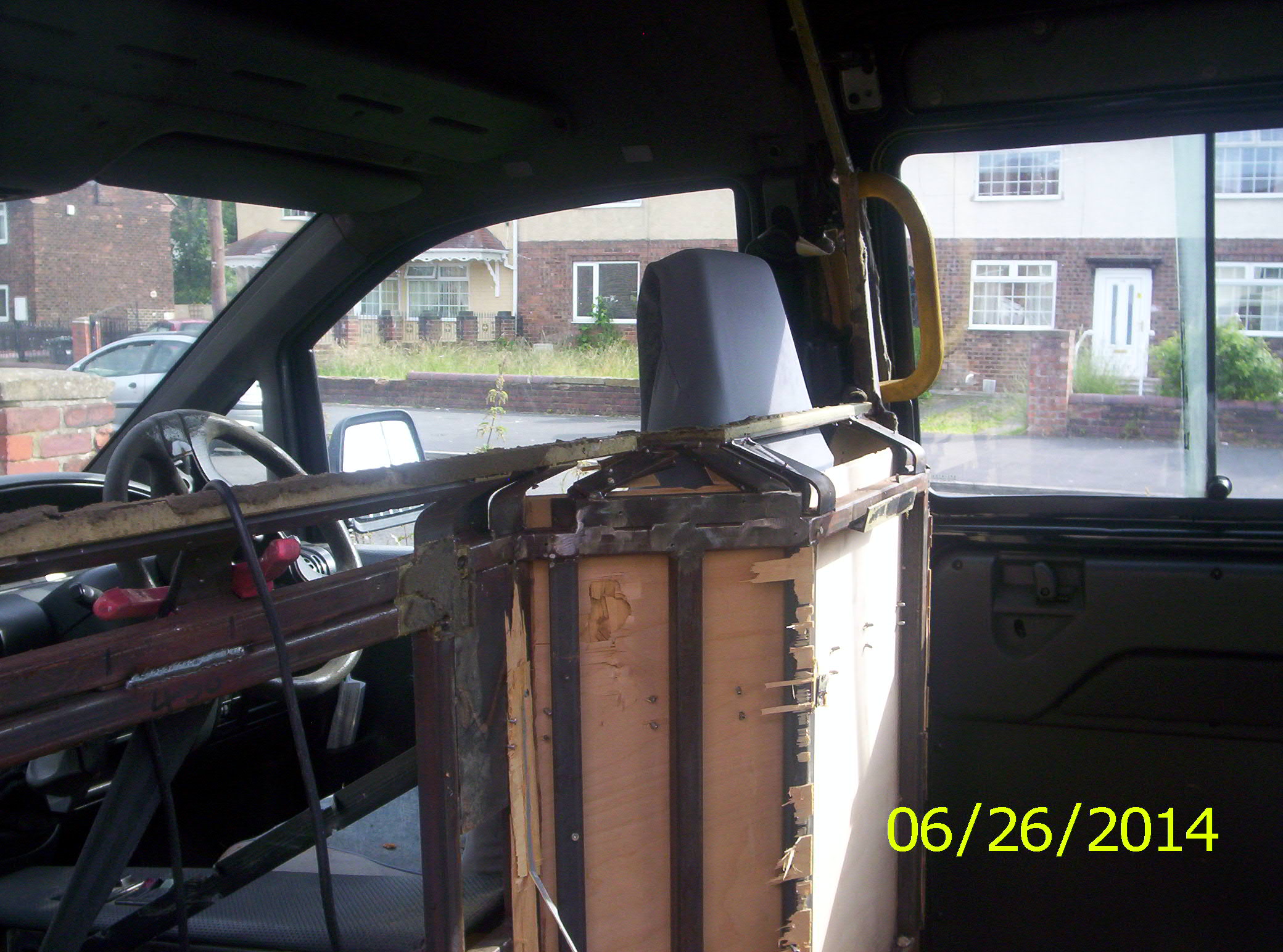

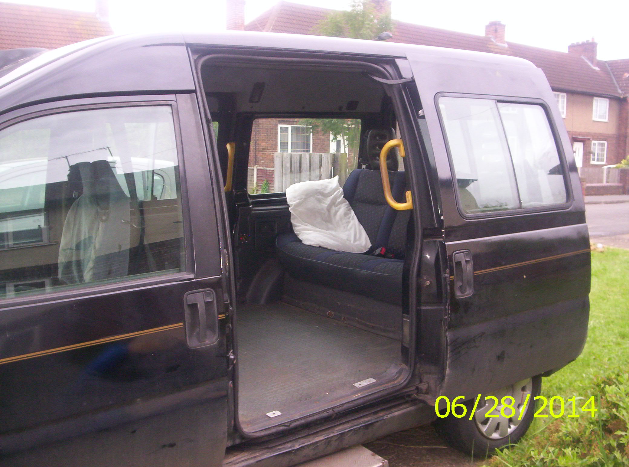

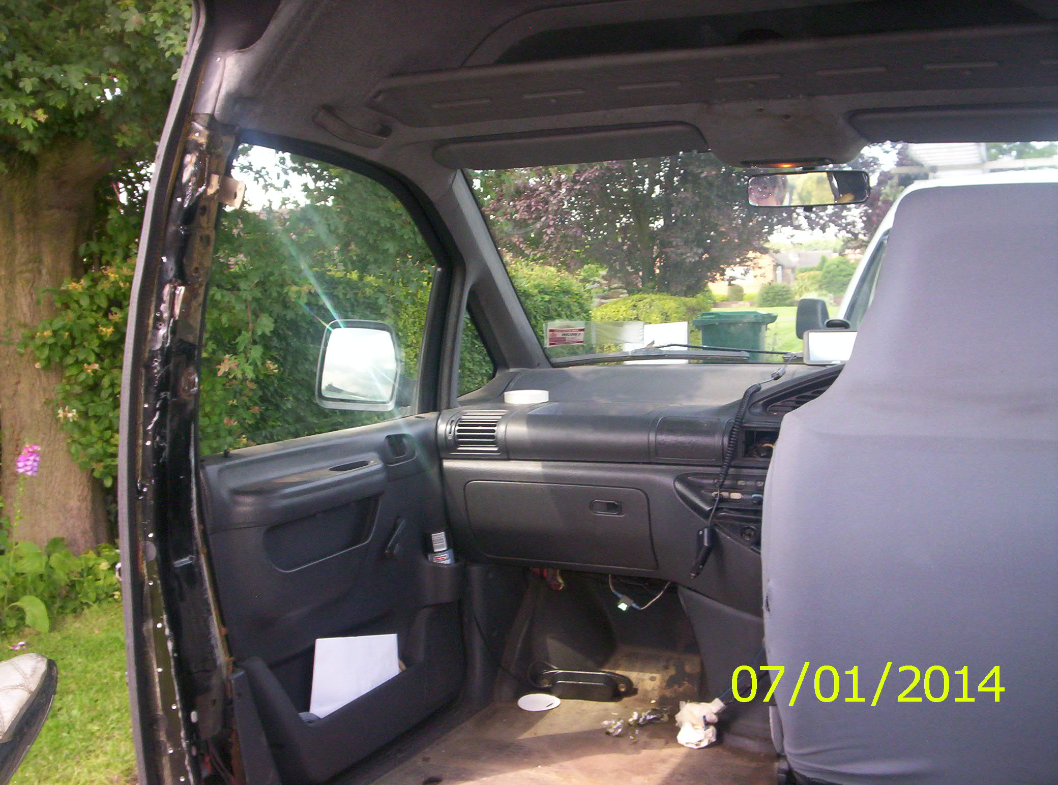

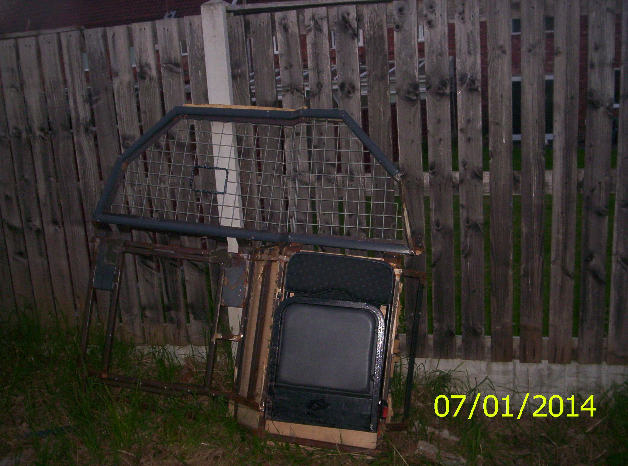

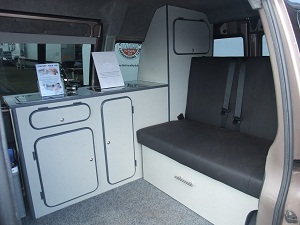

kewl, I'm converting a 1999 1.9 ex taxi, though mine has windows all around. sketched out a plan, removed the taxi bulkead...hmmm, cant put in pictures from my picture folders.
ok, there is always a way, lol.
I've bought a sink and hob, worked out how to build the rock and roll bed, and even got a passenger swivel seat and new drivers seat. next purchases are the roof from another scudo van, so I can fabricate acamping roof for extra sleep space, oh yes and a new steering wheel. currently on a campervan insurance...... its dead cheap, and takes the vehicle away from being a commercial with dvla.... cheaper tax. cheaper for toll roads and toll bridges.

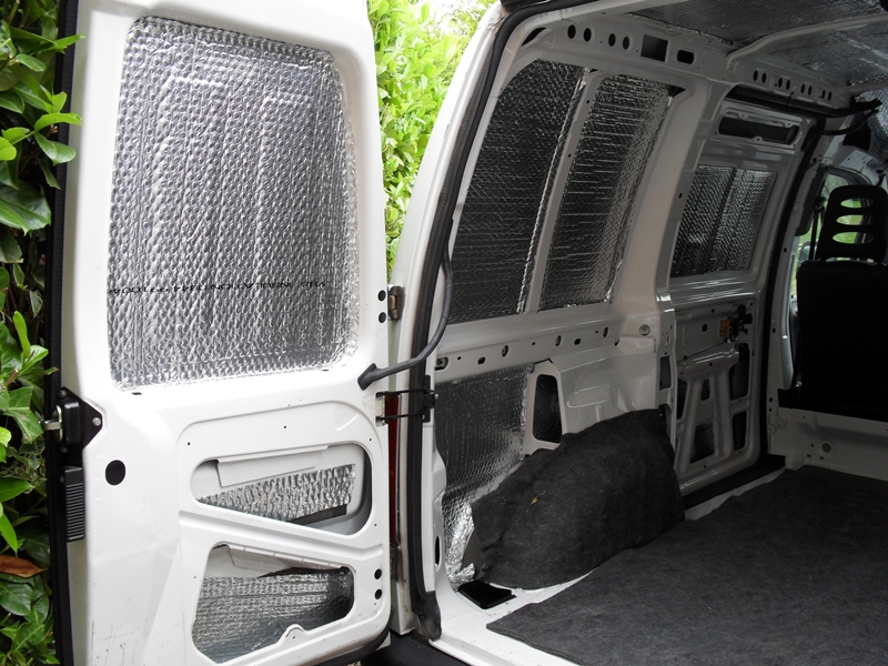

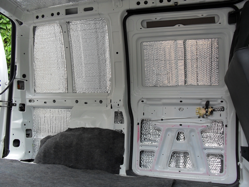

Not really done much recently, as I've been working.

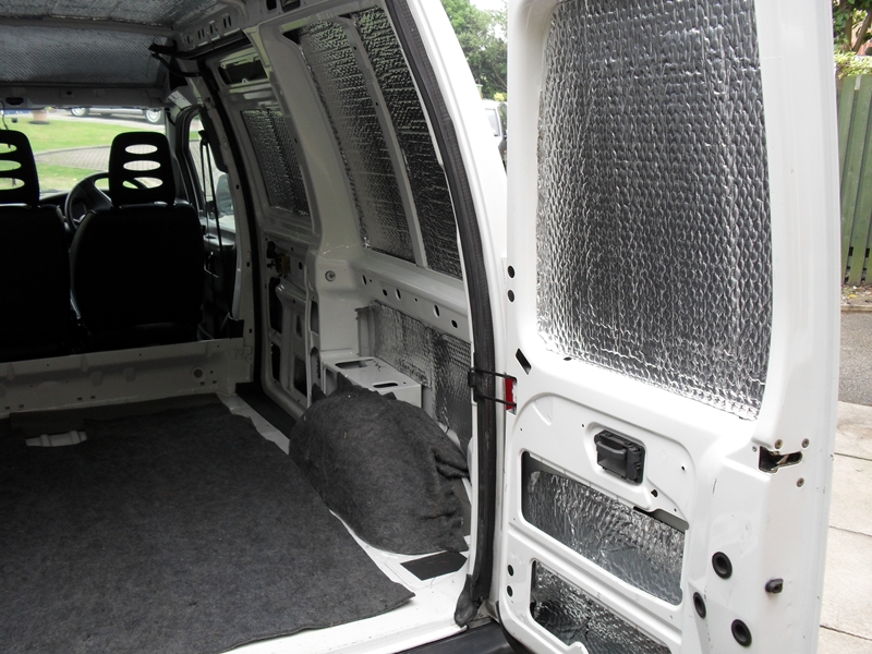

However, got the majority of the first layer of insulation done - using the trusty old 'foil-backed bubblewrap' on the panels and some 'jute felt' on the arches. There's 'Flashband' underneath all that lot - but you've already seen pics of that, and it kind of looks the same.......
The felt on the floor is just temporary to keep the noise down a bit.....

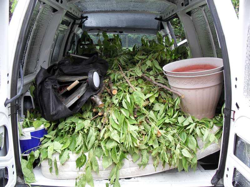

And to show that this van still has to earn it's way - here's it doing a tip run!
what have u used to stick on the bubble wrap?
