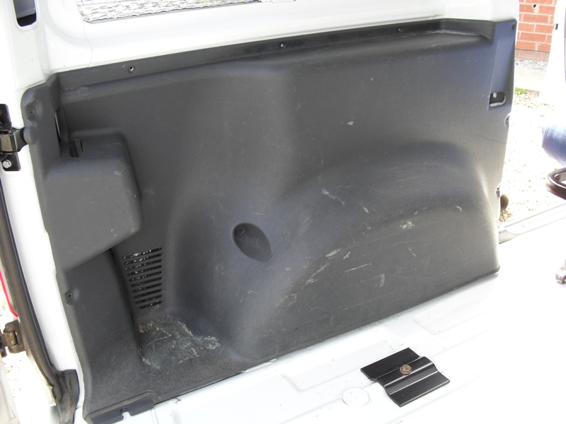

The back originally looked like this :

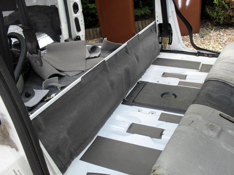

So, today I have been mostly carpetting and insulating. I finished off the roof with foil backed bubblewrap and then put 'jute felt' over the Flashband on the rear arches - this will be all hidden by the combi rear plastics that also arrived today - pics of all that lot when I've done a bit more.

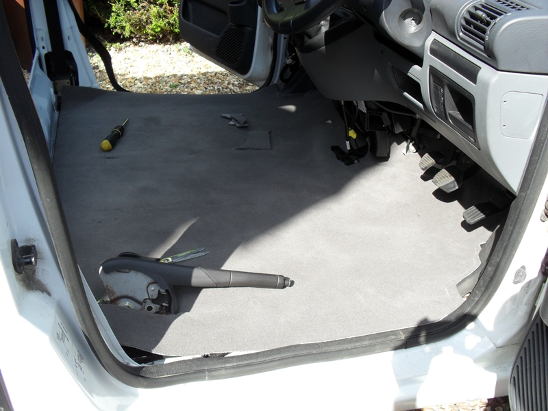

In the meantime, I also carpetted the cab area.

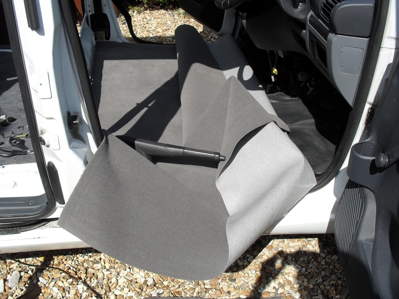

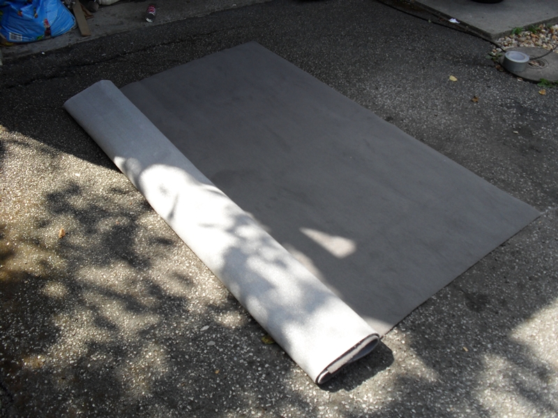

I used a carpet square from my local trimming supplies as follows :
Take a 'carpet square' (£10) :
Throw it roughly into place to take a few measurements :
Trim it to shape :

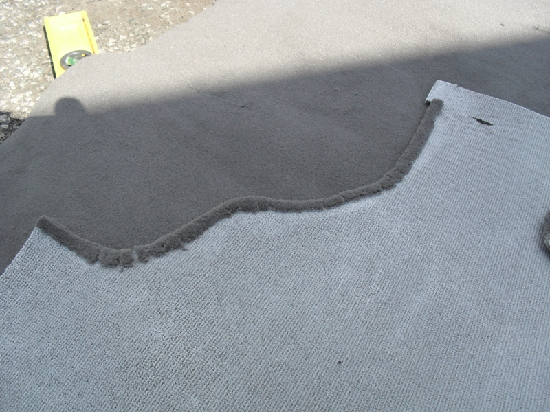

Tidy up the edges by simply cutting over-sized and then folding the carpet back on itself (don't forget the relief cuts on internal curves) :
Tidy up the mini-bulkhead with an off-cut :

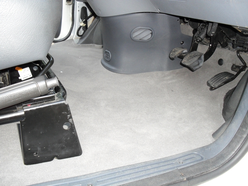

And put all the seats and trim back in :
OK - it's not really much more than a very big 'carpet mat' set - but it cost far less and makes the van less 'van-like' :)

However, got the majority of the first layer of insulation done - using the trusty old 'foil-backed bubblewrap' on the panels and some 'jute felt' on the arches. There's 'Flashband' underneath all that lot - but you've already seen pics of that, and it kind of looks the same.......
The felt on the floor is just temporary to keep the noise down a bit.....

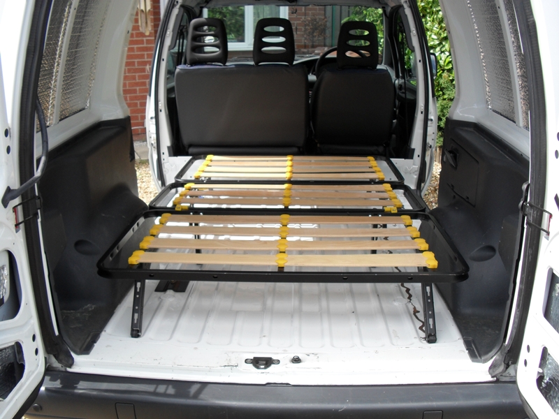

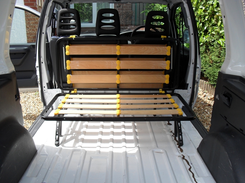

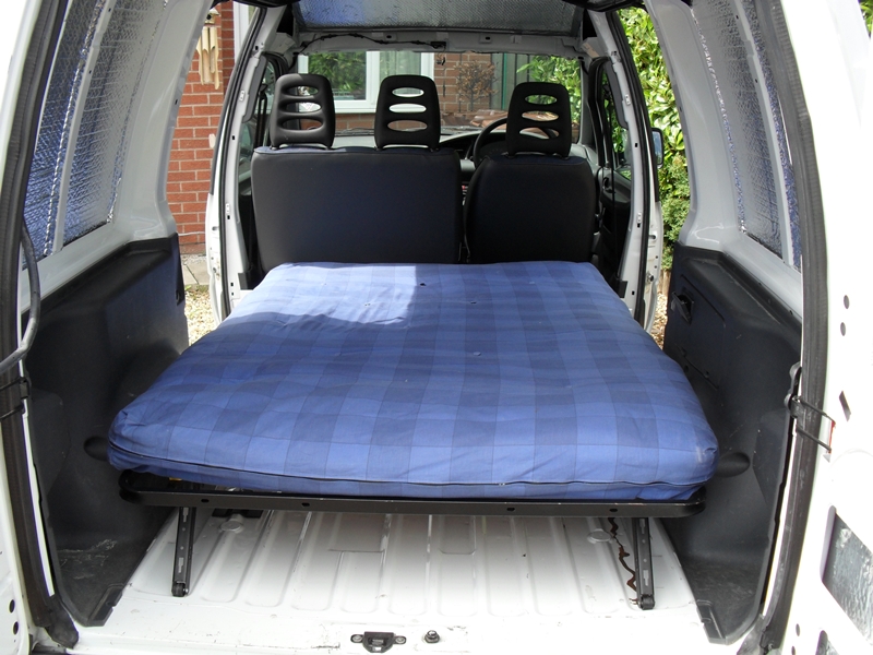

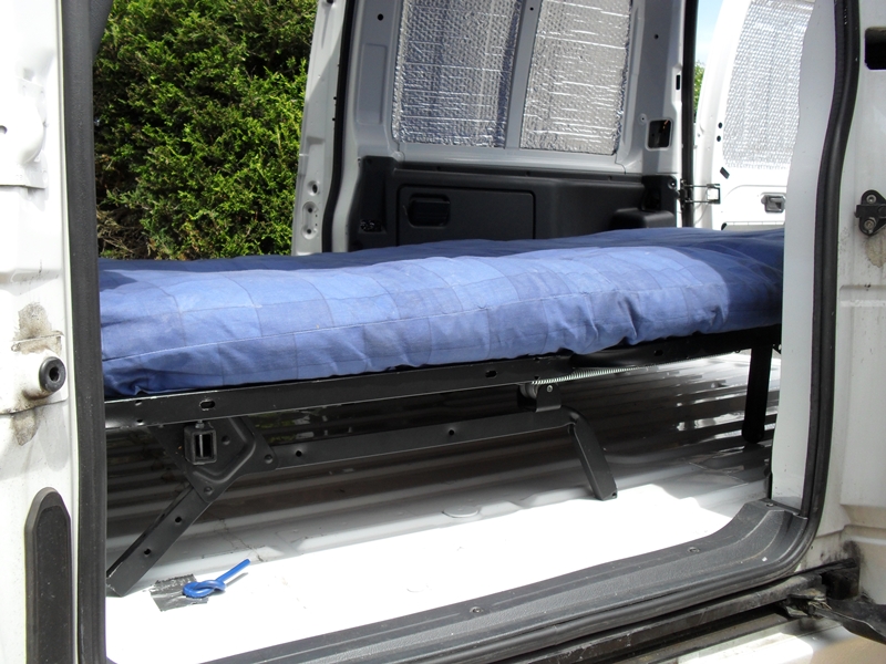

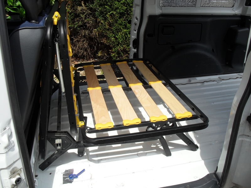

However, today I went and collected my E Bay bargain of the year - an Ikea sofa bed in very nice condition - for £4.99!
The mattress stuff is FAR too heavy for my liking, so will be getting replaced with foam at some point, but I'll secure the frame to the bulkhead bit and it's a VERY cheap rock and roll bed solution!

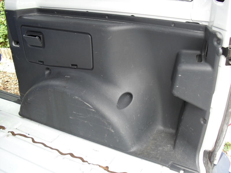

You'll notice I've had to test fit with my interior plastics that I also got off E Bay - a bit more pricey at £60, but far neater than ply lining and will look fine once they've been resprayed.
