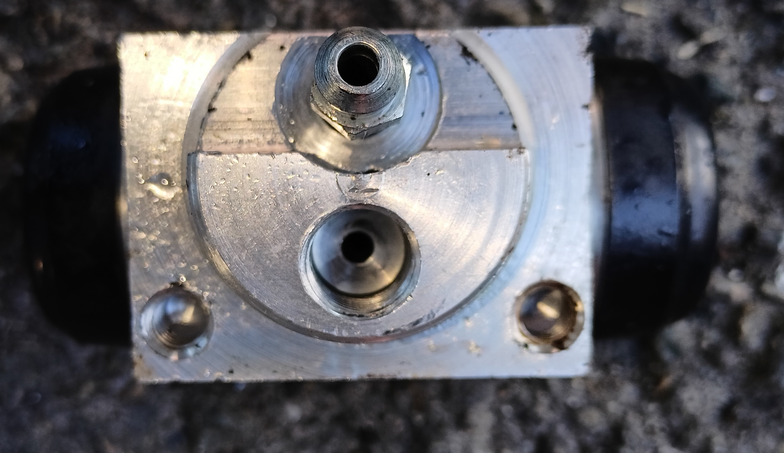

I got the new brake cylinder this morning, the bleed nut is 1mm bigger than the old one and my 8mm spanner has gone walk about, so I put the cylinder on knowing I couldn't bleed it today. After the cylinder went on I could see a leak from the nut that is going in from the brake line. It appears that it wasn't leaking from the bleed nut at all but from there. I really wish I'd put my glasses on to check where that leak was coming from :) LOL
I'm now looking for a brake line nut...do they have some kind of rubber seal to prevent the fluid from leaking out? It doesn't look like they would ever be water tight!
No. Either is got some grit on it, and needs cleaning, or the pipe is damaged or the nut needs a little more tightening say 1/8 of a turn or a little less or the brake pipe has holed inside the nut and you will need a new brake pipe. Not tight enough if you are lucky. Brake pipes go throught the brake union nut and have a flared end that then compresses against the cylinder when tightened, Metal to metal. The end of the pipe inside the union nut is the first place brake pies tend to fail. Nuts need to be tight but not too tight as this damages the flare on the pipe, Do up until secureley seated then nip the nut up just a bit more. Small spnner one hand good frim turn from your wrist is just enough. Wipe the join clean with some paper towel and inspect after giving the pedal a good push and it must remain dry.

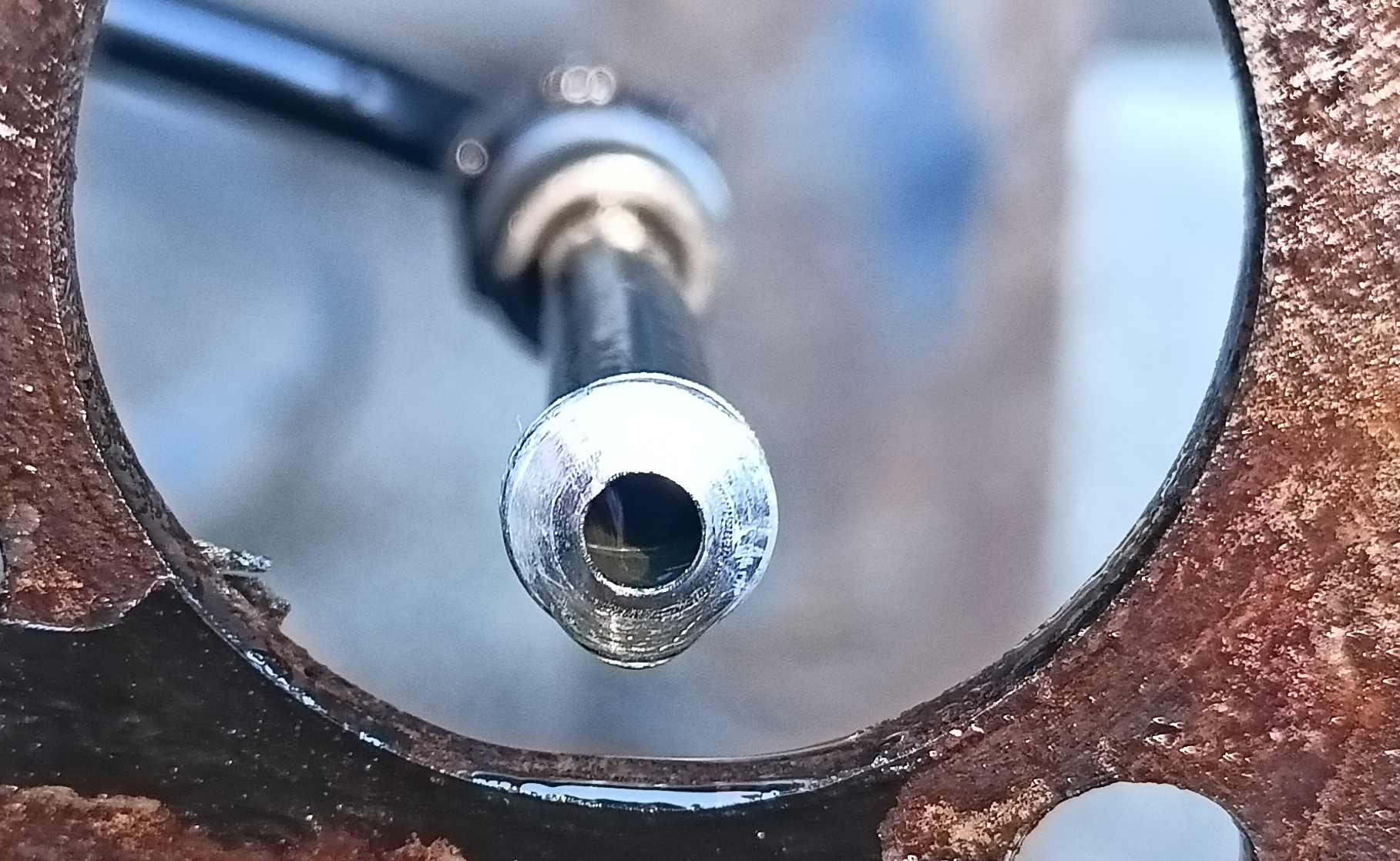

I got the pipe off OK, the new spanner was a big help. The cylinder and brake pipe flange have a little scoring/scratch, I don't know if that's the problem, i.e. I overtightened it last time. But i'll clean the thread, retighten and hope for the best...
