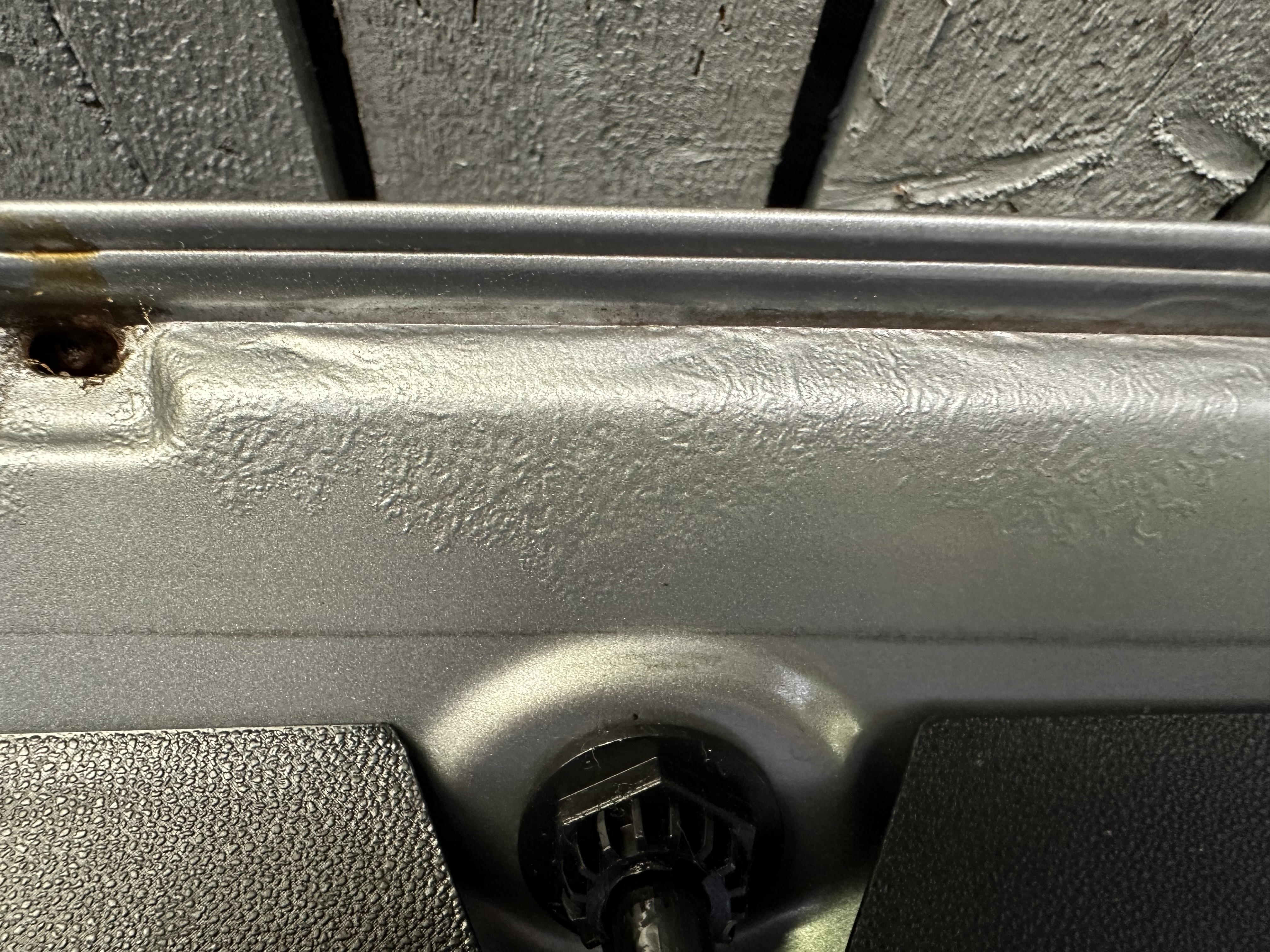

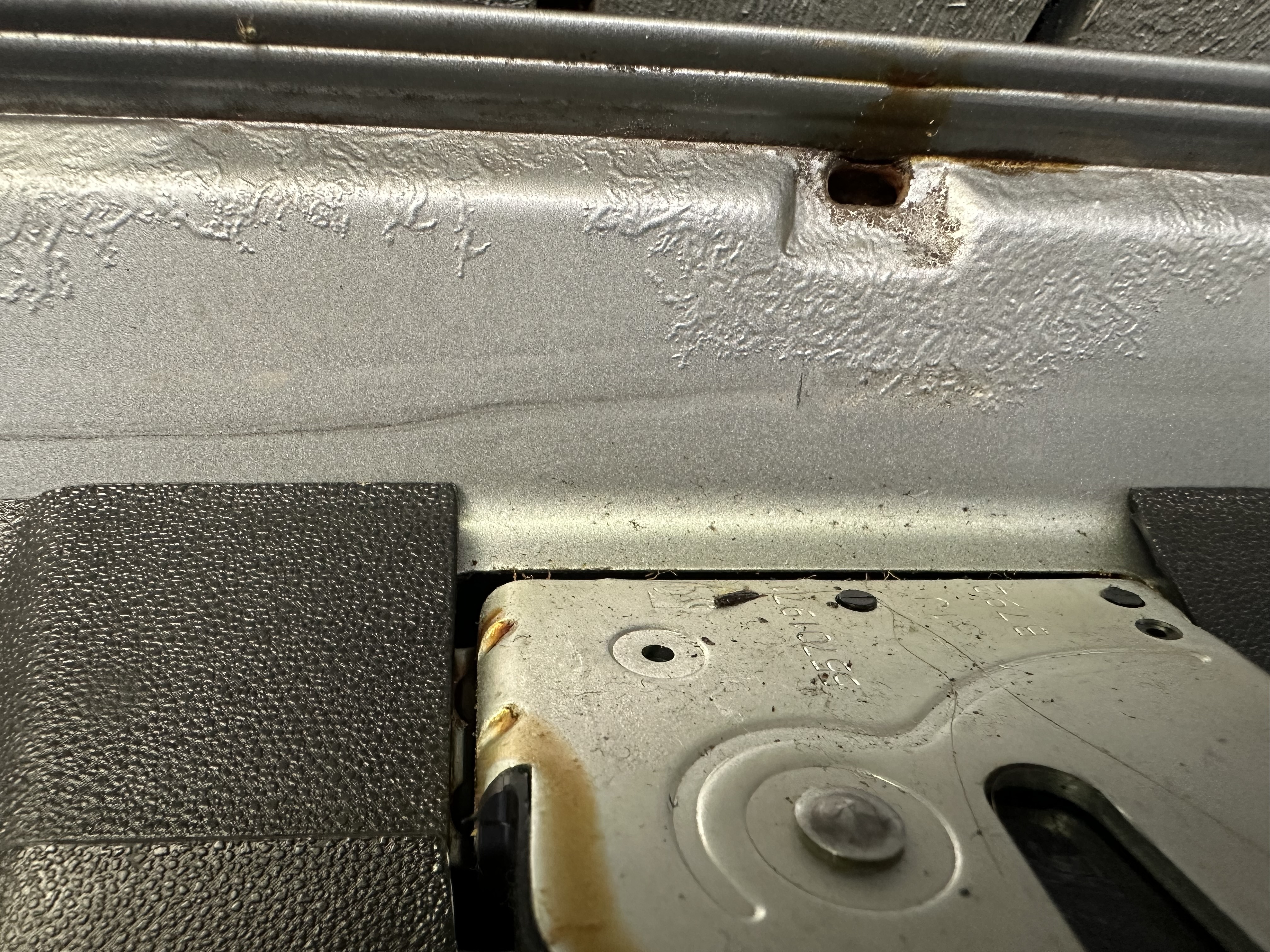

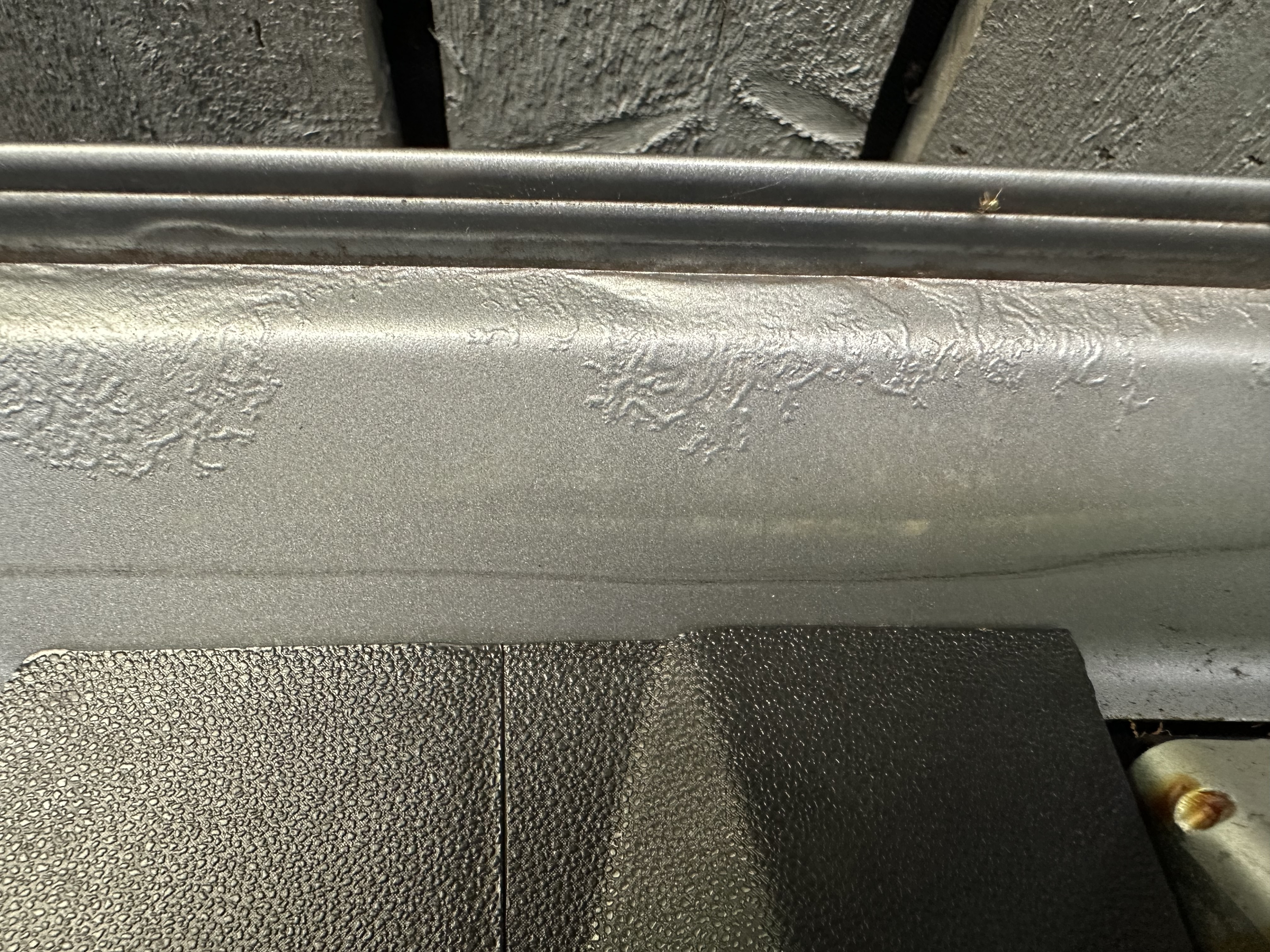

I am assuming this is rust - but it is as if the paint is bubbling up in a way I have not seen before.
Is rust here a common problem - and how should i treat and or prevent it.
Thanks for any suggestions

You've never seen paint flaking off? How old are you (~25, "Gen Z", raised by smartphones, you can't Google things etc.)? ;) OK.
Try to scrape/scratch those bubbles, with piece of plastic. Test (how bad it is - if the paint flakes easily it must be addressed this year).
Yes, it's a rust. 🙃 Possible (water) sources are: third (central) stop lamp and the wiper blade axle.
You live in a damp climate like me.. 😑
I have owned 4 x punto 199, and they all dribble water from the tailgate when opened.. 😔 (After rainy days..)
I have not investigated.. But also not seen rust..
TBH some earlier Fiat's I owned had composite tailgate.. So in my mind I had not been concerned.
My mid 80's cheap cars All rusted, 😉
I've not addressed rust since the 1989 tipo arrived 👍
@PuntoHowTo seems to be knowledgeable on "Germanic" corrosion treatment products, may be pretty relevant to you 🙂
