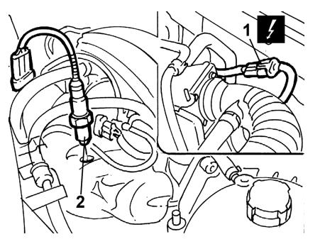

Disconnect the pre cat O2 sensor. It has a reported problem (fatal) and it takes maybe 30secs to a min to start operating to go into closed loop. Keep the rpm up and see if it gets over the 27sec barrier
O2 sensor connector is real easy to get to, near the throttle body

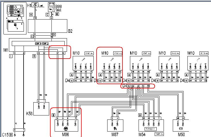

Just for info, can lines from ECU go through D4 and then thru steering to get to BC
I'd try disconnecting and reconnecting BC plugs at rear of BC. Losing connection afer 27secs still sounds like thermal poor quality connection
Poor custom fit ICE can interupt CAN system
