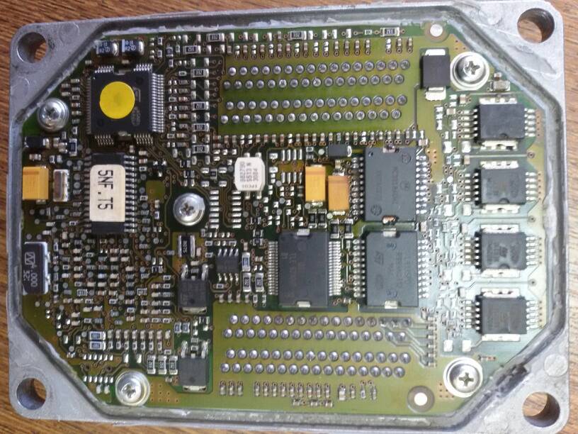

Does anybody have ecu back side picture? I have front side as the following.
