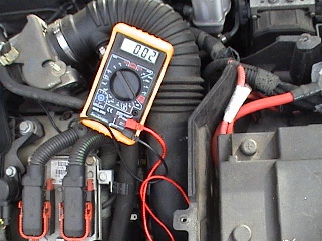

Try this
make sure you have good connections like crocodile clips and not just holding it and connect to check volts between battery neg and a shiny earth on engine with ign on. Should be well below 0.3v
Start engine- volts should still be well below 0.3v
When engine dies, watch voltmeter at the time, a sudden jump up in volts and that identifies that earth's your trouble
