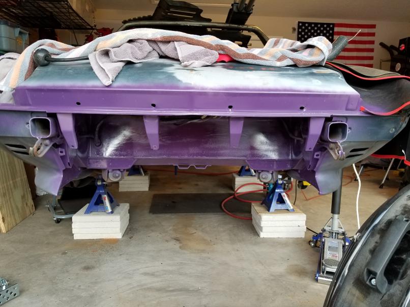

The car has so far had the following done in the last 4 weeks, working 2 hours on Saturday morning, and 2 hours on Sunday morning before the heat and humidity make my garage uninhabitable, and whenever the heat and humidity allow me to work in the evening after my regular job:
Took the hood down to bare metal, treated for hail damage and one ding, painted with rust restorer primer, and then with a regular primer. Treated the underside of the hood to a nice satin-black paint job.
Sanded the rear decklid, treated with rust restorer primer and then with regular primer. Treated the underside of the lid to a nice satin-black paint job.
Door cards have been removed, cleaned and treated, and painted satin black.
Seats have been removed
Interior old blue carpet has been removed
Interior blue vinyl trim has been removed (blue? Really? Yuck!)
Cromodora Iron Cross wheels and old Kumho tires have been removed. Tires are actually in decent shape, wheels are in decent shape, and I have a spare wheel with road rash.
New tires (Toyo Proxes 195/45-15) have arrived, and new ‘Competizione’ 4x98 15x6.5 wheels should be here next week.
Targa top has been stripped. Latches have been treated for rust and painted to prevent further rusting. The trim and the 35 year old vinyl, foam, and gritty tar-like adhesive have been removed. The top has been painted with Bumper and Trim black paint.
Doors have been removed, and the door latch areas sanded and primed
Headlight buckets and motors have been removed
Radiator has been removed
Gas tank has been removed. Will be removing old gasoline that smells like turpentine, and then refreshing, cleaning the inside, and painting the outside.
Bumpers have been removed
Bumper Shocks have been removed
Whats Next:
Now there will be a couple months of perfecting the body, surface rust removal and treatment, in the front, interior, and rear compartments, as well as treating the rust on the outside of the body, and repairing any dings or small dents that I find.
I will be creating plates to replace the headlight buckets, cleaning up the wiring, and making the front end smoother.
Will cut out the bumper mount square tubing (and tow hooks) that extend out of the body in front and rear. Then I will make some threaded inserts to be able to put in racing tow straps or thread in tow hooks when needed. This will be followed by cover plates welded in and smoothed.
Will create cover plates for the four side marker lights, and weld them in. Will also be weld-filling in the various holes in the body for things that no longer require a mount.
Will be fabricating the mounts for the projector beam H1 headlights, which are just 2.5 inches in diameter, as well as the front marker/turn signal LED lights.
Once all the body work is done, I will turn the car over to a professional for the final coat of deep metallic purple.
Then it will be another couple months of sorting wiring, rebuilding an interior, and getting the engine singing happily.
Barring any major difficulties, should have it back on the road by 1st qtr of 2018.

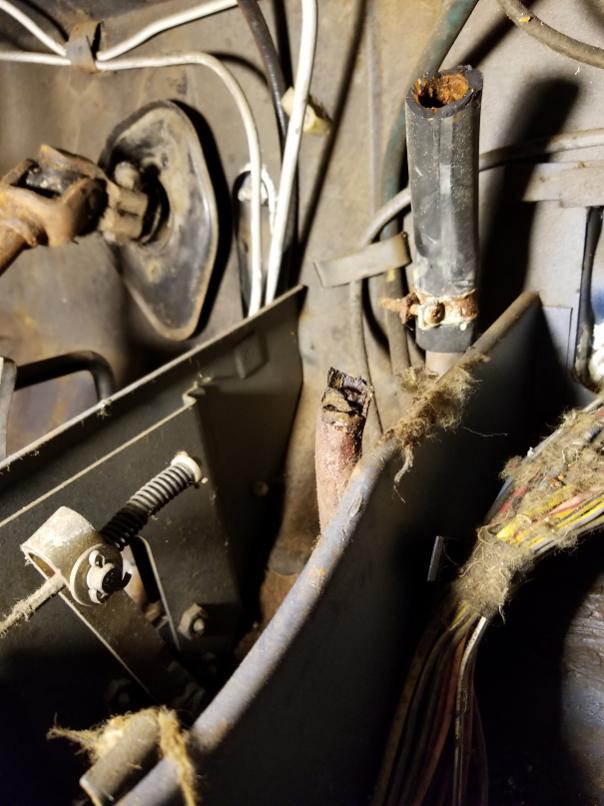

Unable to do much more, I decided to remove the heater core, since I was going to replace a non-functioning heater control valve.
Wow. To say it was disgusting is an understatement. The valve is clogged with some sort of hard waxy stuff. The valve was corroded to the heater core. I had to cut off the aluminum 'ears' to get it removed. And the pipe that gets coolant to the heater is corroded beyond repair. It looks like the scrunge in the heater valve didn't make it to the inside of the heater core.
I will be cutting out 150 spot welds to remove the channel from the bottom of the car where the radiator coolant tubes and one of the heater supply tubes runs. Looks like the heater tubes are now on the list for replacement as well, since they also run through that same channel.
And in Jacksonville, FL, there is only 1 place that rebuilds heater and radiator cores. I'll be dropping off the heater core next week.

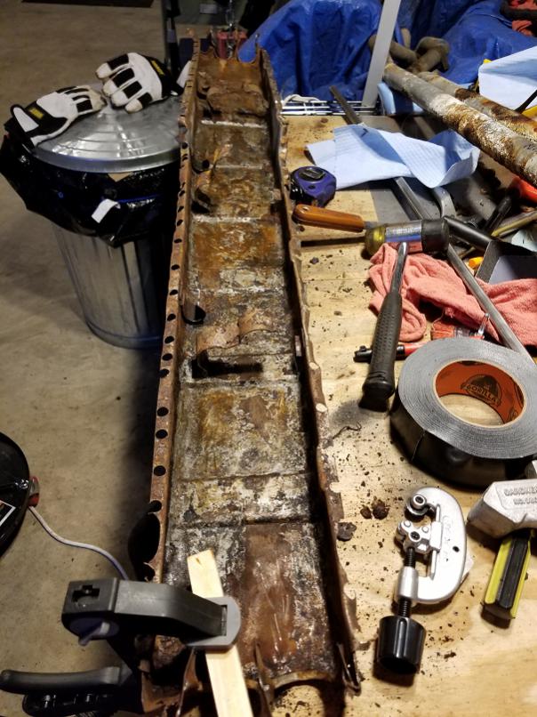

Project Mutant: Finally, a project that went faster than expected! I spent a couple hours on Thursday night, and a couple hours this morning.
I was able to get the coolant tube box off of the bottom of the car in just under 2 hours. It was as ugly inside as predicted.
There was some really nasty fluid left in the tubes. the heater tube was pretty much blocked. All in all, this is definitely a task that needed to be done!
I ordered the gaskets for the water pump, and will be cleaning and servicing that as well, before I finally put it back together. Stainless tube and corrugated stainless radiator hoses. I also ordered 4 45 degree stainless elbows, and will weld up the back part myself. From there out, it is just ad-libbing my way through.
So I will take the rest of the day off, and congratulate myself on a task well done.

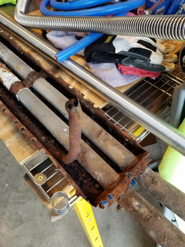

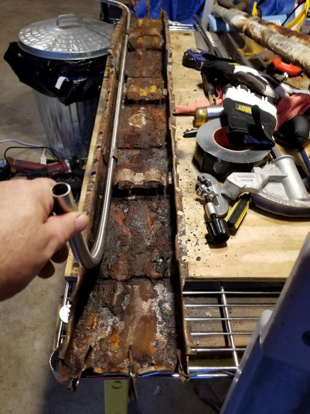

Project Mutant: The coolant box is on the bench, and the coolant tubes and heater tube have been removed.
I've bent a new heater tube that looks pretty good. Should fit and end up where the old tube ended up.
I started cleaning the inside of the box, and after some 45 minutes of scraping, it looks like I should be able to get out the wire brush and start removing the rest of the scrunge real soon now. Then, some rust restorer primer, and some satin black paint, and then sand off and repaint the outside, and it will be awaiting the installation of the new stainless coolant tubes.
I will start fabricating the new tubes this week, and will get to see how much my welding skills have deteriorated with 15 years of not being used. :D

Would it not be easier to fabricate a new coolant pipe box? Possibly even from stainless steel and rivet it to the bodyshell?
AL.
I had thought about that. Unfortunately, I do not have the skill nor tools to work with a large piece of sheet metal. No bending brakes or other forming tools.
The box actually has a couple different levels. If you look about halfway down, you can see where it 'steps' down lower. I am OK mechanically, but when it comes to sheet steel manipulation, I know where my limitation is.
So for now, I will just straighten, clean, de-rust, paint, and reinstall, and re-weld it back to the car.
As an alternative, could you omit the coolant pipe box, tidy up and repaint the car floor and leave your nice shiny new stainless coolant pipes on show (just fit appropriate pipe clips/clamps.
Stainless steel sheet is notoriously hard to manipulate/form in a home 'shop.
Mild steel on the other hand is relatively easy. Given that you can weld and the box has a step in it, it could be formed in sections at home, especially if you have access to a small box folder or bend the sections between lengths of angle iron clamped in a bench vice and then weld together. Just a thought.
On the other hand, you may be aiming for originality plus I don't know if omission of this box section would compromise safety in a collision. ( not a good way to find out!).
Re:- cleaning radiators incl. heater rads. - I just block the openings, fill with a caustic soda (drain cleaner) solution, leave a day or two, then flush with a hosepipe until water runs clear. Works fine for me, just don't let the caustic soda solution come into contact with alloy components e.g. heater valve.
AL.

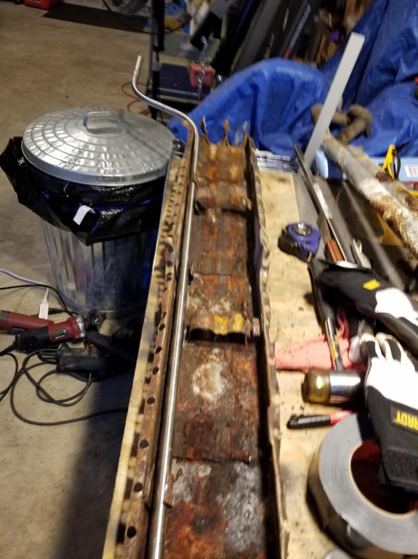

Project Mutant: Done cleaning and repainting the coolant tube enclosure from the bottom of the car. Removed the end plates, removed all the old sealer and rust, and primed with rust restorer primer, and painted satin black.
I am now working on recreating the end plates where the pipes pass through. A carbide-tipped hole saw is Da Bomb for making the proper holes. Amazing bit of kit.
I am also planning on running BOTH of the heater lines in the enclosure. One of them currently runs inside the car (instead of underneath) in the same box where the shift mechanism lives. So I'll be ordering another piece of 5/8" stainless and bending THAT to match the new one I bent. Makes more sense.
I will be rounding off the edges of the holes by welding in some tubing (like brake line) over the sharp end of the cut metal, so that it doesn't damage the stainless coolant tubes over time.
Deconstruction takes a LONG time and can be very frustrating, especially when you keep finding other related issues. Construction and rebuilding brings a smile to my face, and building something physical with my hands makes me feel good. This car will likely be willed to my grandkids when I pass, whenever that happens, since I seriously doubt that I could ever bring myself to sell it.

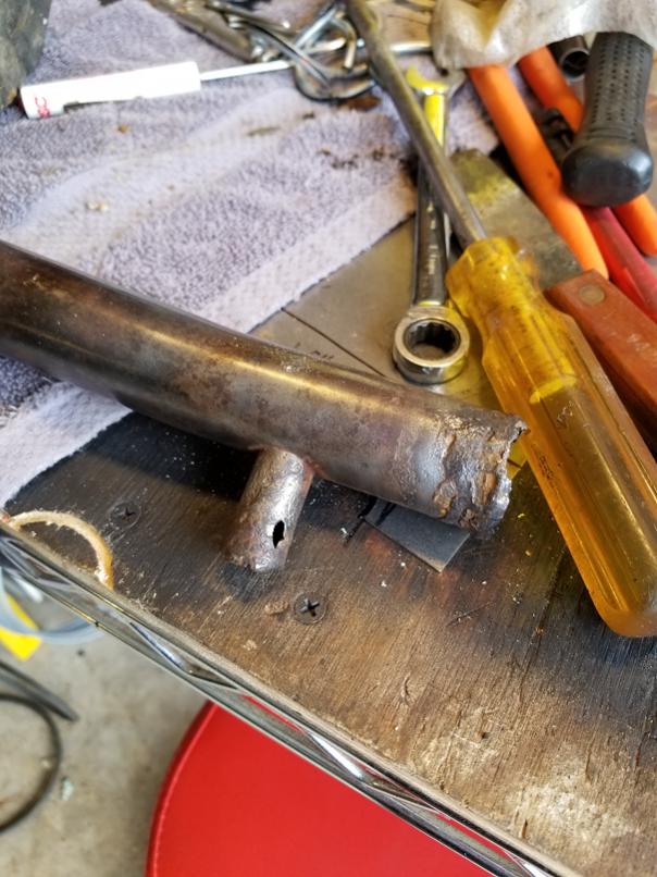

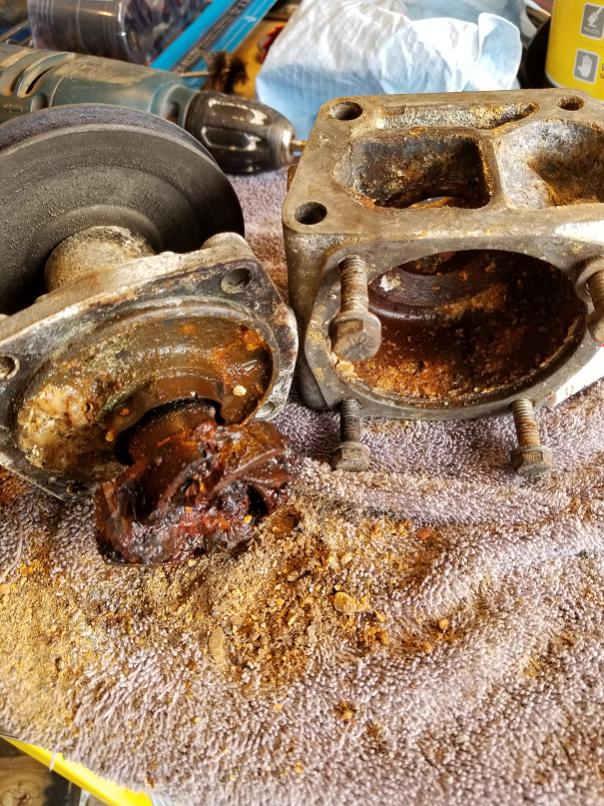

Project Mutant: Some things are just too good (bad) not to share.
It seems that everywhere I turn, I find holes in things that shouldn't have holes, and blockages in things that should have holes. I will be SO glad when I am done with the cooling system revival!
I removed the tube that takes coolant from the engine back to the water pump. It wasn't blocked, but the inside looks terrible. In cleaning it up, I found a hole in the large pipe, AND a hole in the small pipe. DANG!
Then, I took the water pump off. There are two holes in the engine block, one large and one small. So far, so good. The water pump housing itself is a different story. The large hole was disgusting, but the small hole was CAKED, BLOCKED, and that stuff was what I have been finding all over the cooling system.
I think in the past, someone used some stop-leak, or maybe a LARGE case of stop-leak, and where it didn't circulate, it decided to settle in and make itself into some form of crystalline cement.
I had ordered a replacement water pump, BUT the illustration doesn't show the full housing. So, I ordered a Beck-Arnley water pump also, where the illustration DOES show a full housing. The winner will be the first one to arrive with the full housing. The loser gets returned for refund.
I ordered an in-line filter for the cooling system (wire mesh in a clear housing) so I can place it where it will catch larger flakes and etc. It also will make it so I can view the state of the coolant.
Once I get everything here, I will remove the thermostat, hook the out and in-flow parts of the thermostat housing together with the filter, and do a full cooling system flush. Or two. Or three.
Nothing gets hooked up to my new cooling lines and radiator until I can get the engine completely flushed, and running clear. Until then, it will be flushing with a closed loop system.
For my Fiat X1/9 community friends... If you decide to remove the heater tube that runs inside the car, in the console, you will want to know that there are THREE 'clamps' that are spot-welded to the console. They do NOT want to be removed. Took some large pry bars. chisels, spot weld cutters, and a right angle cut off tool to get it loose. Then, I decided to cut the tube into three sections to remove it, since it was easier than taking it out the back.

I've often been astonished at how badly Fiat water pipes can corrode. Probably wouldn't happen with regular anti-freeze/coolant changes (iirc, the corrosion inhibitors get used up first).
As well as the coolant pipes rusting, the engine block core (frost) plugs also rust badly...... Idk if there are any core plugs in the cyl. head or inlet manifold?
I was surprised that you hadn't removed the engine and trans. as a unit. This would have allowed you to work in comfort around the engine and then refit the combined unit from underneath the car, lifting it into position with your engine crane.
AL.
It is often said that hindsight is 20/20. In this case, I would agree with you. However, since I am disinclined to go back and remove it all again, I will treat the problems I find with the engine/tran in place.
From what I can see using a flashlight and cheap borescope, the inside of the cylinder head and block look reasonable. Not nearly as bad as the rest of the pipes in the system.
And, you are correct that changing coolant at proper intervals usually leaves the pipes and mechanicals in good condition. However, since I can't go back in time and grab whoever owned it by the lapels and shake some sense into them, I am left to deal with the aftermath and bad decisions. Again: I believe someone used radiator stop-leak, and attempted to keep it as a permanent solution, instead of correcting the problem.
The further I get in this project, the more I hear the phrase in the back of my head: "Rode hard, and put away wet".

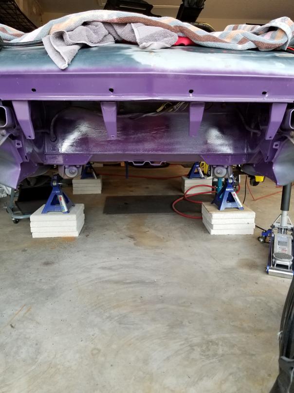

Project Mutant: Time for an update...
I got an excellent start on getting the box under the car where the coolant lines run nearly complete. Because I am running coolant lines that are slightly larger than stock (and STAINLESS STEEL), I decided to make the box slightly taller.
The larger tubes required more height. So, I extended the box sides 3/8" taller. I then fabbed up a new front end and just need to fab up the rear end, and then I am ready for the new tubes.
I am also running BOTH of the new stainless steel heater lines in the box, rather than running one in the center console.
I replaced all of the coolant hoses in the engine compartment. Thanks to Bertie from Canada, I also have an excellent condition coolant tube from the brand new water pump, replacing the one that had holes in the big tube, and the small tube.
By the end of next week I will either have new stainless coolant tubes welded (all materials are on-hand, the appropriate skill set is not!), or have a new set bent. I decided to NOT bend the front of the tubes. Makes them easier to work with and I can fabricate something for the front end of the car to the radiator.

Project Mutant: The coolant tubes and heater tubes are in the box, and after some more 'massaging', the box is ready to go back under the car.
Need to get some body panel adhesive to make sure the box is structurally sound when I mount it to the bottom of the car, and some sealant for the ends of the box to keep the nasty stuff out Then need to get the front tubes cut off where I want them to be. Then, ready to mount everything back up and start finishing the cooling system and heater.
As far as the overall job quality? It is not my best work. But in the words of a wise old woman, spoken with a deep-south drawl, for some reason in Brainerd Minnesota "It ain't gourmet, but it's food."

Project Mutant: Progress is being made. Holes in under-car tray have been filled. Seams for end caps and around pipes have been sealed with automotive seam-sealer. Radiator box has been de-rustified, and primed, and painted a temporary color.
"This isn't even my final form!"
New (correct) speedometer cable arrived.
Tomorrow, have some mikey-do items to attend to, then grind the mounting area for the under-car tray smooth (spot-weld cutter leaves behind flotsam and jetsam), and drill five new holes in the side of the tray for the new speedometer cable mounts.
Then, we clean the mounting surfaces, pre-drill a few dozen holes in the tray flange for pop-rivets to hold everything in place, and lay on the two-part epoxy auto body part adhesive. Then I have 90 minutes to get the tray up where it belongs, and pop-rivet it in place to allow the body adhesive to cure for a day. After that, it is a one-piece with the rest of the car, forever. A day later, and I can hook up the hoses and maybe even get the radiator in place.
