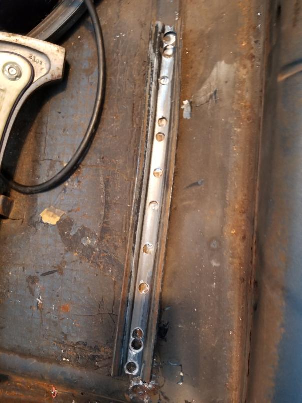

How many spot welds did Fiat use to connect the seat rail to the floorpan?
Answer: At least 9. Might be 10 or 11. Each and every one must be drilled out completely before you can pry the track off the floor.
I now have one seat rail off, and will work on the other 3 rails later.

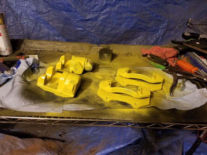

BOTH seat rails on drivers side removed. Brake calipers for right hand side ready to be put back together.

Front and Rear calipers are rebuilt, painted, and re-installed, over new rotors.
