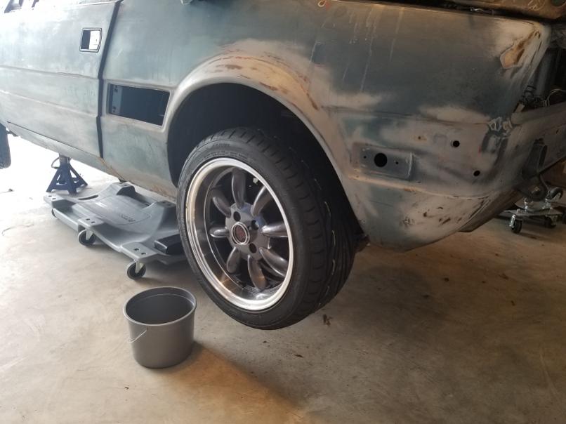

Nice wheels - Will any work be required to the arches to fit them?
I tried some 15 inch Alfa 146 wheels on my X and they did not fit due to the offset being wrong...
Those Minilite replicas look a lot better suited though.
Offset and tire combo is pretty good. Plenty of clearance on the back. about 3/8" of clearance on the front (between the tire and the strut spring perch).
Doesn't seem to need any modification of the wheel arches or fender wells.
I am considering going to a coilover suspension, which because the springs are so much smaller diameter, completely eliminates any clearance issues.
Will have it down on it's feet in a couple weeks.
I've attached some pictures showing what they look like on the car. Just put them on for looks. Will be taking them off so I can continue working on the car without damaging them.

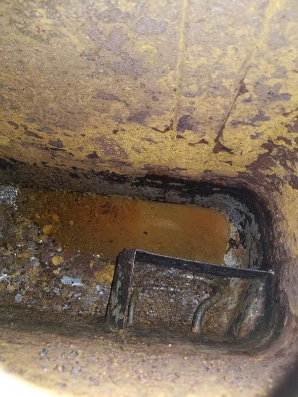

Gas Tank Removal (also known as ‘things no one speaks about):
I finally got the gas tank out. Turns out that in order to remove the electrical connection and upper hose connections (for emissions control), I had to remove the bracket for the throttle body, the throttle body itself, just to get access to another vinyl cover. Jeepers! Could they make this any harder?
Once I got the tank out, and the gas gauge sender unit removed, I discovered that the sender unit float is 1/3 full of gas, that the gas in the tank is the consistency and clarity of tea with cream added, but smells like turpentine. And now that the tank is drained (luckily there was only a couple ounces of fluid) and empty, there are still some clunky rusty bits rattling around inside. I guess I’ll be ordering a new tank and sender from Vick Auto.

A few pictures showing just how bad the gas tank is. Also drilling and tapping the targa top for thread inserts for the latches. And the progress on the side of the car. Black = rust reformer primer, and you can barely make out the crazing of the primer underneath.
