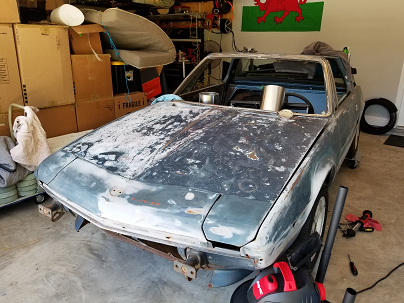

Now, some 35 years later, I found the desire to bring one back from the grave. I found an 82 (first time I am dealing with fuel injection) that has sat in a pole barn for several years. Maybe 5 years. Parts of it sat in the woods (hence the hail damage and really terrible primer on the hood hiding surface rust bubbles). Someone started to prep it for paint, and did some disassembly, but it was literally a basket case. When I went to pick it up, I ended up with 4 crates of parts and components, as well as a pickup-truck bed of other parts, hoods, engine covers, etc. It was Mediterranean blue, and various shades of primer and rust and etc. There was some surface rust, but no rust-through areas. It had over 100K miles, a clean title, and a key, no battery, and it looks like most of the parts are there.
The car suffers from being exceptionally dirty (a couple wasp nests, LOTS of leaves), and there was some water intrusion in the various cavities. Those issues have been handled.

Took the hood down to bare metal, treated for hail damage and one ding, painted with rust restorer primer, and then with a regular primer. Treated the underside of the hood to a nice satin-black paint job.
Sanded the rear decklid, treated with rust restorer primer and then with regular primer. Treated the underside of the lid to a nice satin-black paint job.
Door cards have been removed, cleaned and treated, and painted satin black.
Seats have been removed
Interior old blue carpet has been removed
Interior blue vinyl trim has been removed (blue? Really? Yuck!)
Cromodora Iron Cross wheels and old Kumho tires have been removed. Tires are actually in decent shape, wheels are in decent shape, and I have a spare wheel with road rash.
New tires (Toyo Proxes 195/45-15) have arrived, and new ‘Competizione’ 4x98 15x6.5 wheels should be here next week.
Targa top has been stripped. Latches have been treated for rust and painted to prevent further rusting. The trim and the 35 year old vinyl, foam, and gritty tar-like adhesive have been removed. The top has been painted with Bumper and Trim black paint.
Doors have been removed, and the door latch areas sanded and primed
Headlight buckets and motors have been removed
Radiator has been removed
Gas tank has been removed. Will be removing old gasoline that smells like turpentine, and then refreshing, cleaning the inside, and painting the outside.
Bumpers have been removed
Bumper Shocks have been removed
