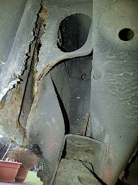

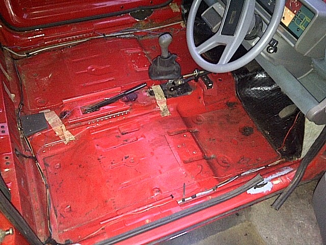

Well this weekend I finally managed to have a thorough look at Belladonna's underpinnings. Well it had to be done, but let's just say I have found more work.
It seems that I have the A-Z of Panda rust spots!
For your entertainement here is a selection of pictures.

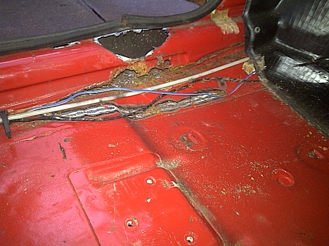

And to add to the fun, when I got the floor covering out, the driver's side footwell was very wet. So I need to track the source down. If you have any ideas please let me know!

Ha ha . I meant the source of the water in the footwell! When I first got her, the 2 little drainpipes on the bulkhead under the bonnet area were very wet, so I unblocked them.
May be it could be something to do with that? I don't think it's the sun roof because the seats are dry.
Looks like all the common Panda spots, all doable but it will take a fair amount of work to do it properly. You will need to cut the outer sills off to repair the inners correctly, anything else is a bodge imo. Of course you are bound to find more when you start cutting aswell. Are you going to be having a go at the welding yourself or getting someone else to do it?
