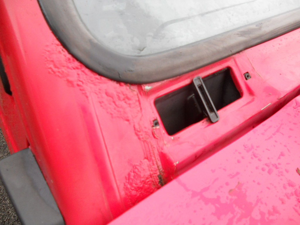

The bottom of the windscreen pillar on the driver's side is solid, but the paint is bubbling. (see picture).This needs attention ugently. Any suggestions?
The passenger's side is fine.(see pics.

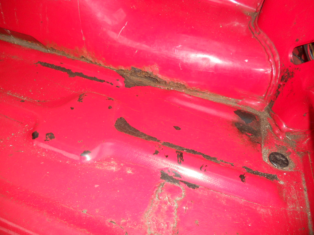

Then I decided to hold my breath and take out the boot floor covering.
Yes Mr Welder is going to be required! In the right hand back corner, and the right hand seam. (see pics).

Looks like you will need to remove the windscreen to sort the rust on the pillar out, probably started from where the windscreen has been changed before and the paint was scratched in the process. I wouldn't be surprised if you find a hole underneath. There shouldn't be a seal behind the outer vents, only the inner bit that you remove by turning the vertical piece of plastic in the middle of the vent hole round and removing from underneath the scuttle. That has foam which goes hard and crumbles into dust.
I have just done the same repair in the inner rear arches on my Sisley, unfortunately I never took any photos of how I did it, pretty common area though. Took me a while to do as I replaced almost the entire edge of the boot floor and inner arch panel, but it is now solid as a rock and shouldn't need any attention for a long time, plus it will be hardly noticeable when it is painted.
I dont think that is right too bad myself, on pandas.. sort out rust. lol once it gets in it can turn bad very quickly so i'd suggest getting the windscreen bit sorted out.. it looks to be all behind the air vent cover so i'd chip the old paint off, rust treat it and repaint it. it is a shame that it has gone behind the windscreen rubber. you may have to take the windscreen out like panda1408 said..
i had to take the windscreen out of my sisley to fix a rust issue. i found it quite easy to do.. others seem to find it more difficult. i even managed to reuse the old rubber seal too.
i had to fix a hole in the boot floor but it was not a big one. sills, and just behind the front wheels (in front/forward of the plastic wheel arch liner) had rusted through too.

All good advice so far. (y) If you do decide to remove the windscreen yourself though be very careful, we're not all blessed with Dragon Man's skills. The slightest twist on it will break it so you may want to consider cutting the rubber and refitting with a new one, or calling in the professionals.

Also I took the bubbled paint off the front screen pillar / scuttle area. I haven't taken the screen out, but had a delve under the rubber with a small screw driver, and it seems pretty solid so far. (see pics).
