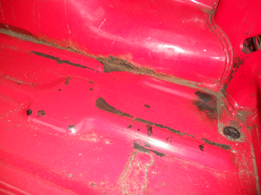

What would be the technique for repairing the seam between the boot floor and the side wall? View attachment 114715
Is it cut out the seam, some from the floor and some from the side wall to make the seam bigger, and then weld a patch in, or something else?
Is it best done from the inside or the outside?
Is that area regarded as being close to the fuel filler pipe and tank to require it all to be removed?
I apologise to the experts here for the beginner's questions, but I am trying to get a plan in place for whether I could eventually tackle this sort of job (after lots of practice) or not.
I am interested in the reply to this as Fizzle is going the same way unfortunately :(
Had to do this on my sisley, the proper way to do it is too cut the inner arch away to enable access to the edge of the boot floor, repair that as necessary, then make a new section of inner arch and weld it in. The chassis rail is thicker so that should be OK, all 3 sections should be plug welded together
Well I understand what he means, but that's the easy bit!
Also he didn't mention whether the fuel tank and filler pipes need removing. I don't know how close you can safely get to that stuff with welding.
It depends how far forward the rust is, if its at the back end or middle of the wheel arch you will be fine with it in place, however you will probably find it is worse than you think once you start cutting. I had to remove it on my Sisley as I had to do the entire length of the inner arch, annoylingly I didn't take any photos as I was doing it.
