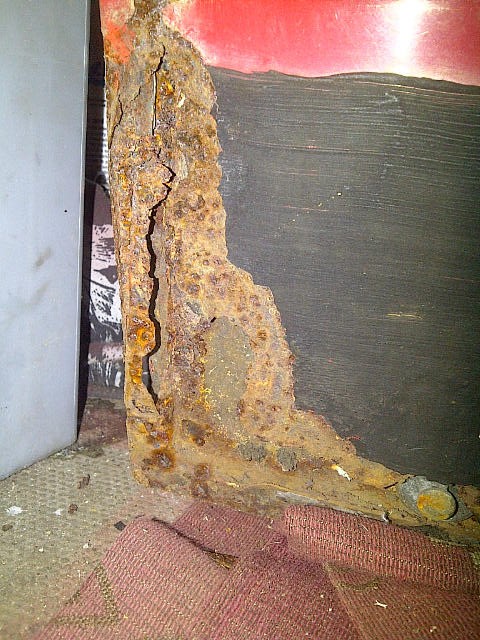

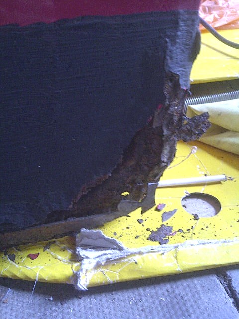

I have replaced the passenger side door on Belladonna with one that was far less rusty.
I am just debating if it is worth keeping the old door. I am a bit tight for space as I currently have 2 broken Nissan engines and 8 full sets (yes 32) of assorted used tyres courtesy of my son's drifting hobby in my garden. Luckily they are out of sight of neighbours!
I am not clever enough to weld a new section on to the door, but I am loathe to bin it if it could be of use in future to anybody.
Any thoughts?

Fizzles drivers door was a bit like that, the seams had gone through.
I've kept the door as it's repairable - just not by me, also parts like glass come in handy (for both sides) in case of breakage.
Can you not suspend it on a wall or flat on rafters if short on space?
Personally I have 8 alloys, 5 steel wheels and no loose used tyres, I feel decidedly amatuerish :(
You are right. This is rarity material nowadays, so I will suspend it somehow in the shed.
The wheel / tyre/ engine collection (not to mention 2 front bumpers, coilovers, a wiring loom and a fuel tank from a BMW 3 series) are not something we are proud of. Especially Mrs Codger. She says we are looking like a scrap yard. At least she is pleased that Belladonna looks a bit smarter.
