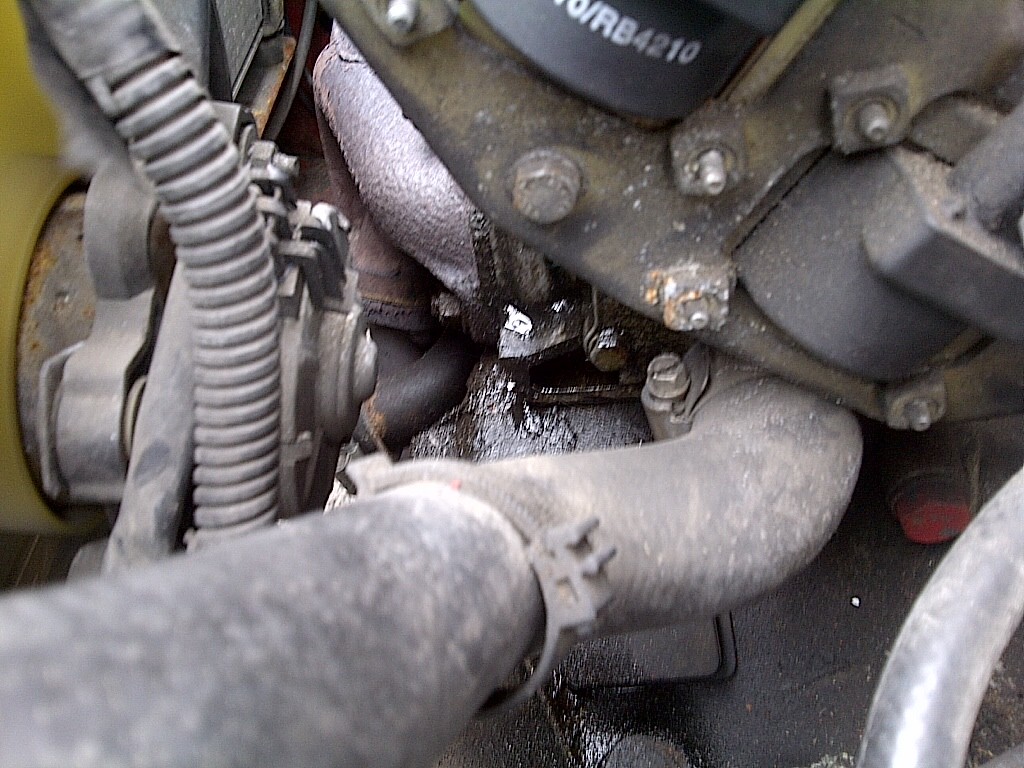

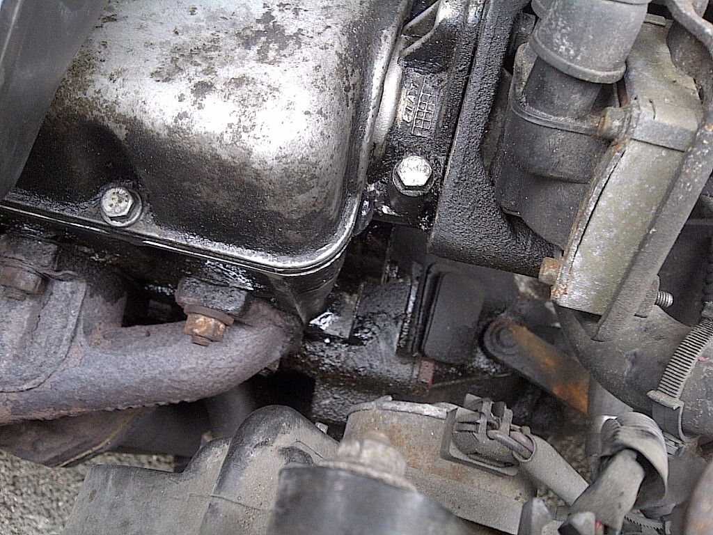

Well after some weeks of not much happening (due to horrible weather and higher financial priorities) I decided to fire Belladonna up today. A few weeks ago I replaced the camshaft cover gasket as there was some leaking going on. I also took the plugs out and gave them a good clean. Plug number 3 (second along from the timing belt end) was horribly oiled up, as was the airbox. I replaced the air filter, changed the oil and filter as well. With some fresh petrol in and a fully charged battery, and jump battery, she fired up first time.
What I did notice though is that there is some oil leaking, which at first glance looks like from the rocker cover, but is in fact lower down, near the thermostat, I think. Please see my pictures. Is this a common place to leak oil from?

I have just had a look and you could be right. I will get hold of a new seal.
